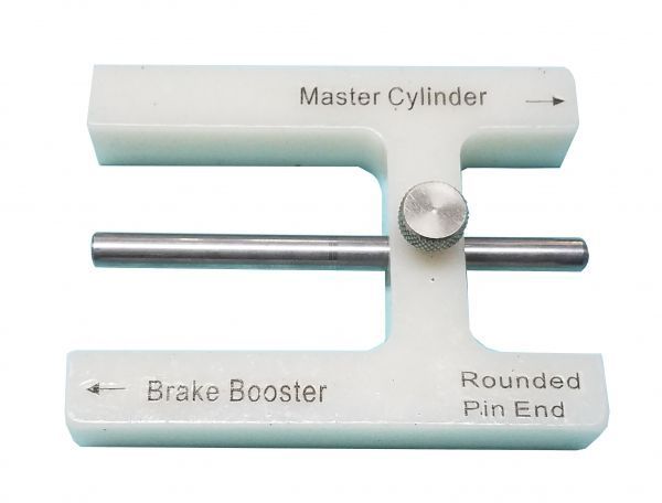

Thatsa different adjustment and is pedal to stop adjustment. The pin inside is booster plunger pin to master plunger cylinder. Anytime you use two different or unmatched brake master and booster you should measure to make sure the pin is correct. I have a tool like this which makes it supper simple. Prior to that i used a caliper and straight edge. If you dont have the adjustable pin you can use a solid rod adn just measure it to the correct length like TS does with their matched sets
This tool comes with the booster I ordered. It should make the adjustment easier.
It's funny that the TS master cylinder rebuild kit comes with a adapter (more or less a 3/8"x1 1/2" rod) to use with deep hole master cylinders.

Its a great tool, I have giant one for cutches too.....always gotta buy a new tool. Theres not much to those rods. The adjustable ones are pretty nice to have but once you get the size you dont need it to be adjustable anymore...
