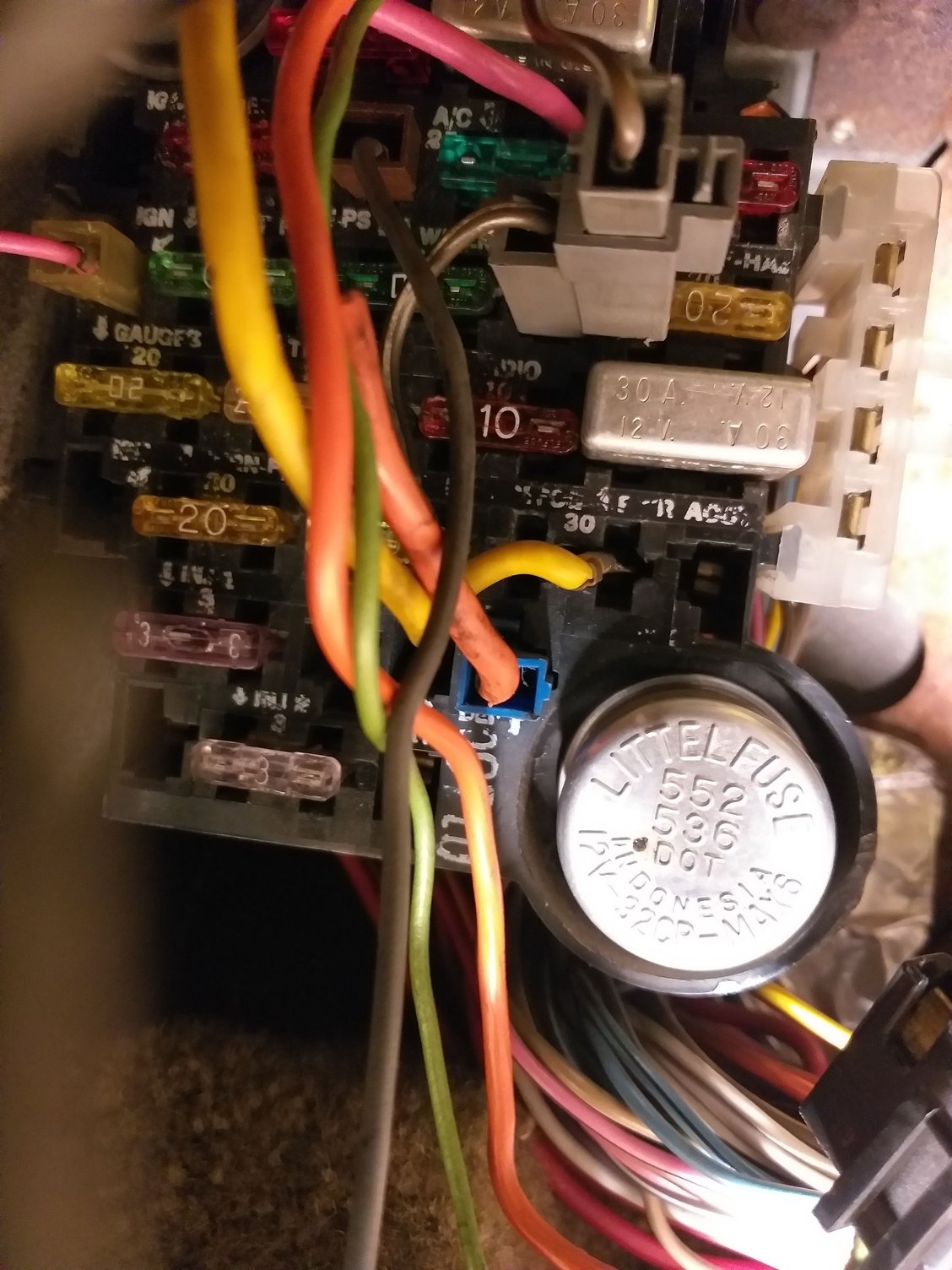

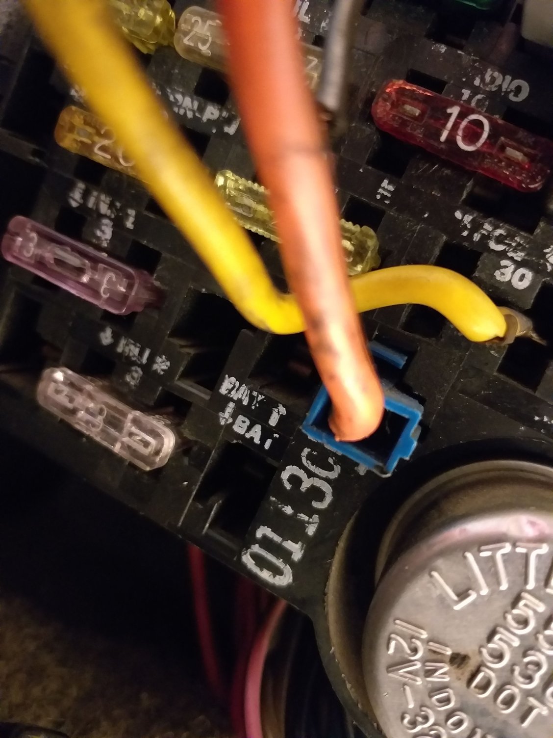

Old Aug 24, 2020 | 12:37 AM
  #56
Maxim0's Avatar
Maxim0
Joined: Aug 2020
Posts: 63
Originally Posted by Maxim0
good morning yes there have been changes the previous owner wanted to switch to carburetors because the car was not working well but after he thought about leaving the injection, I think this person took the car to a wrong mechanic, I bought this car at October 2019 but I immediately fell in love as soon as I saw it I was a bit reckless and hasty about the purchase. please write in clear and simple words for a good translation unfortunately i don't speak english and i have to do the translation be patient thanks

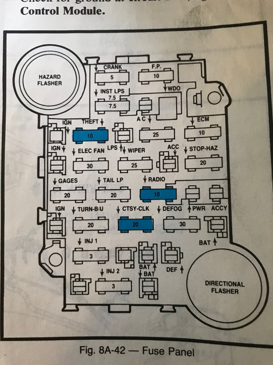

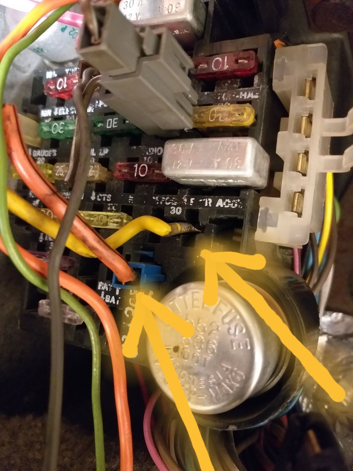

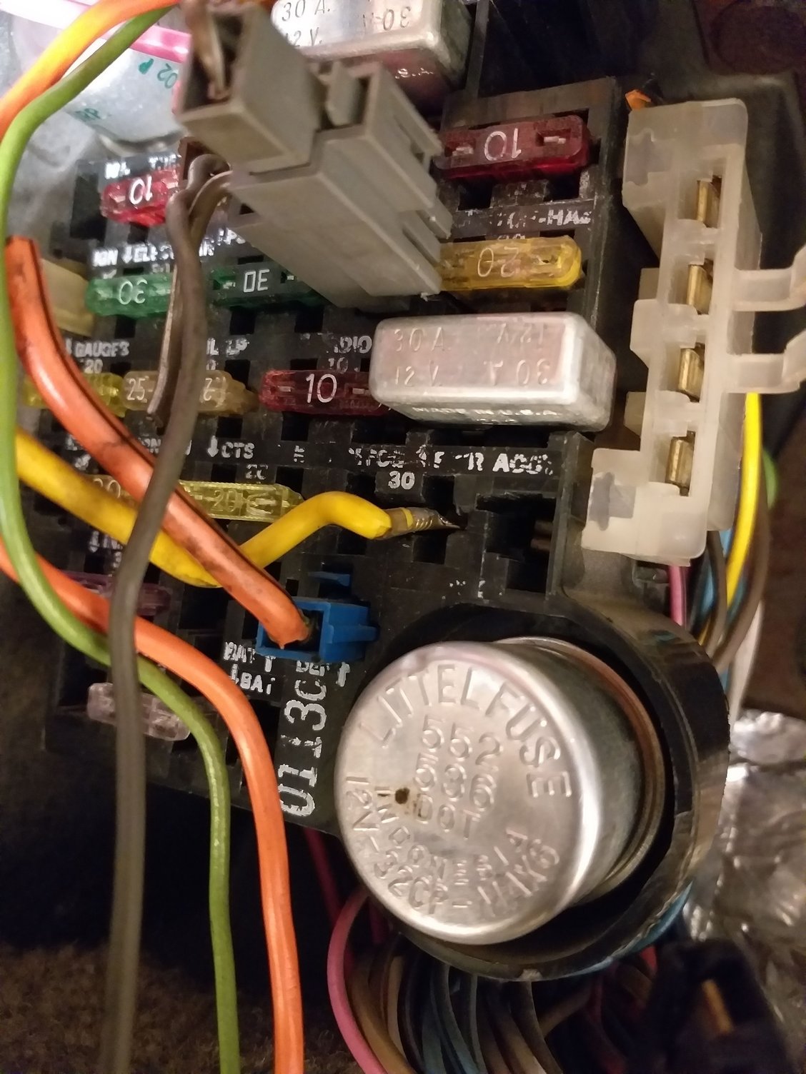

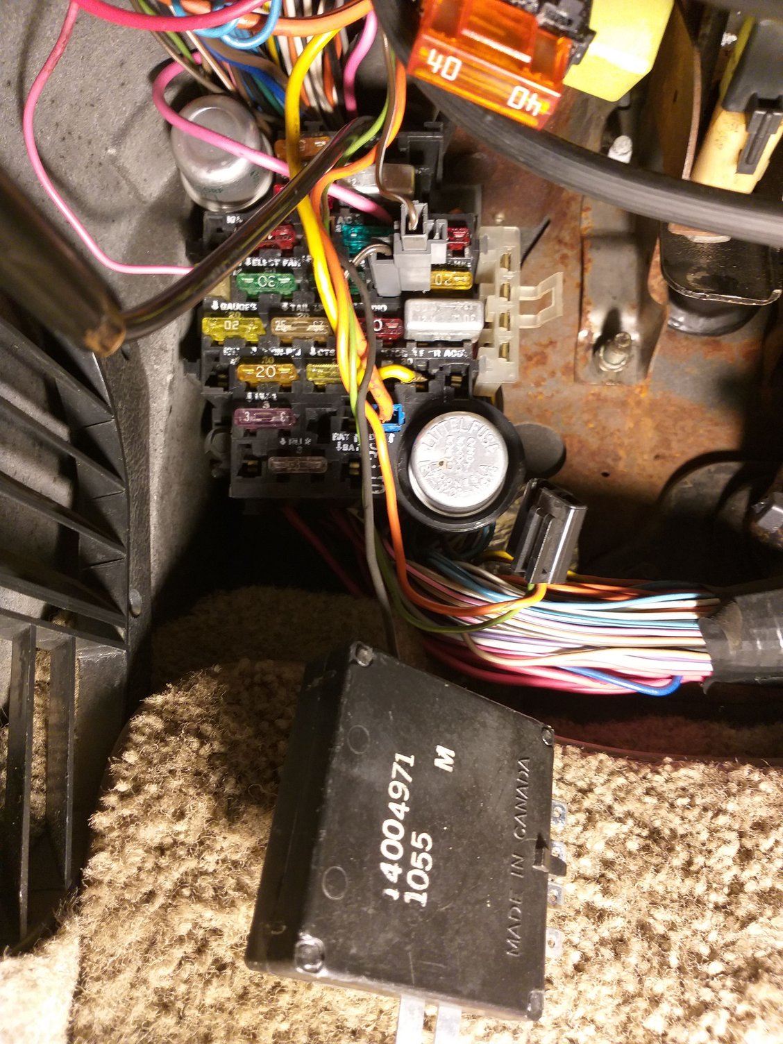

I found the bridge made with the yellow thread, and the orange thread cut, I don't understand why, can someone tell me something?

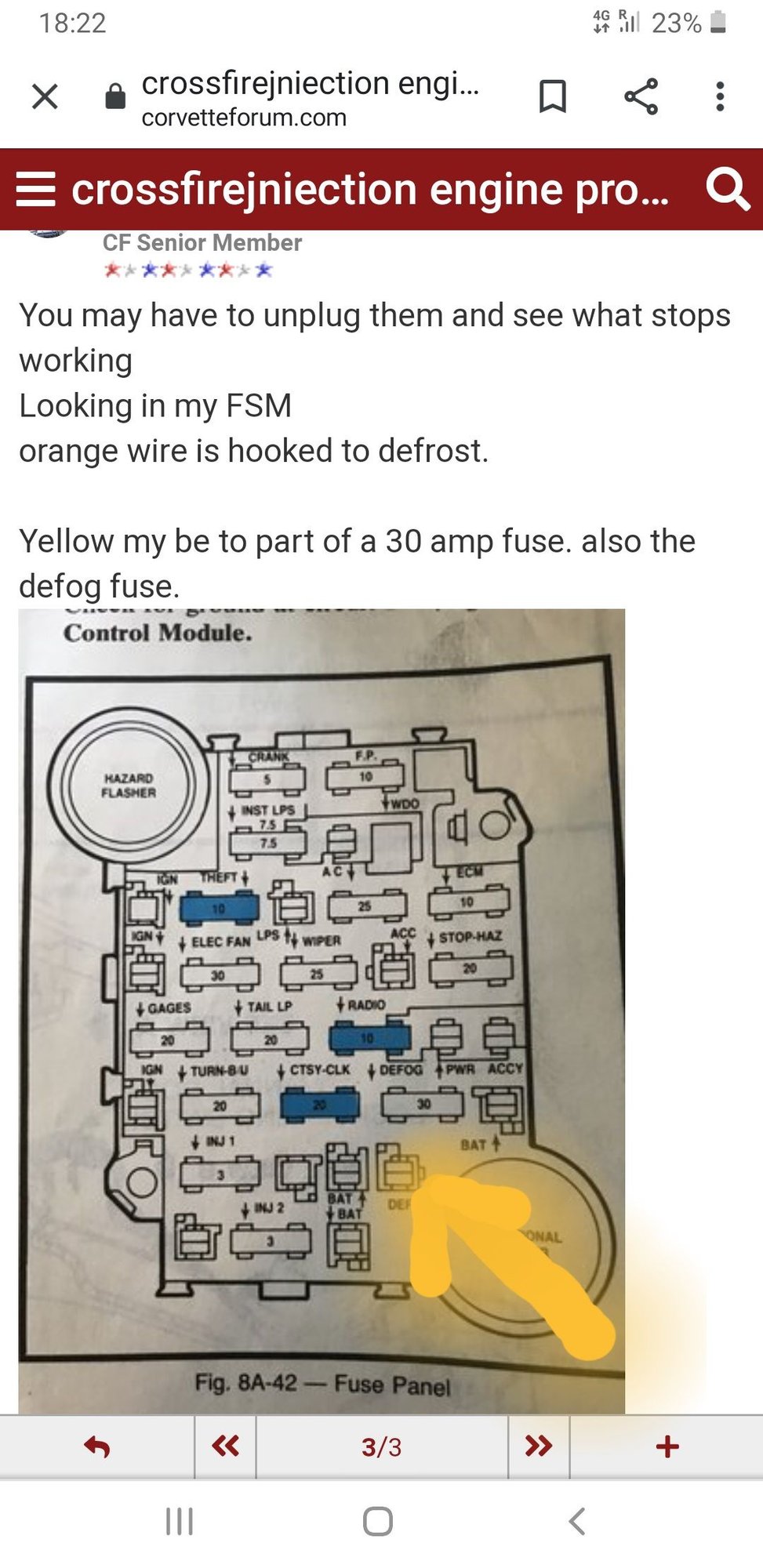

Old Aug 24, 2020 | 12:01 PM
  #57
FASTAZU's Avatar
FASTAZU
Joined: Feb 2002
Posts: 11,599
Likes: 1,053
2018 C4 of Year Finalist
2015 C4 of the Year Finalist
St. Jude Donor '16
You may have to unplug them and see what stops working
Looking in my FSM
orange wire is hooked to defrost.
Yellow my be to part of a 30 amp fuse. also the defog fuse.
To crossfirejniection engine problem

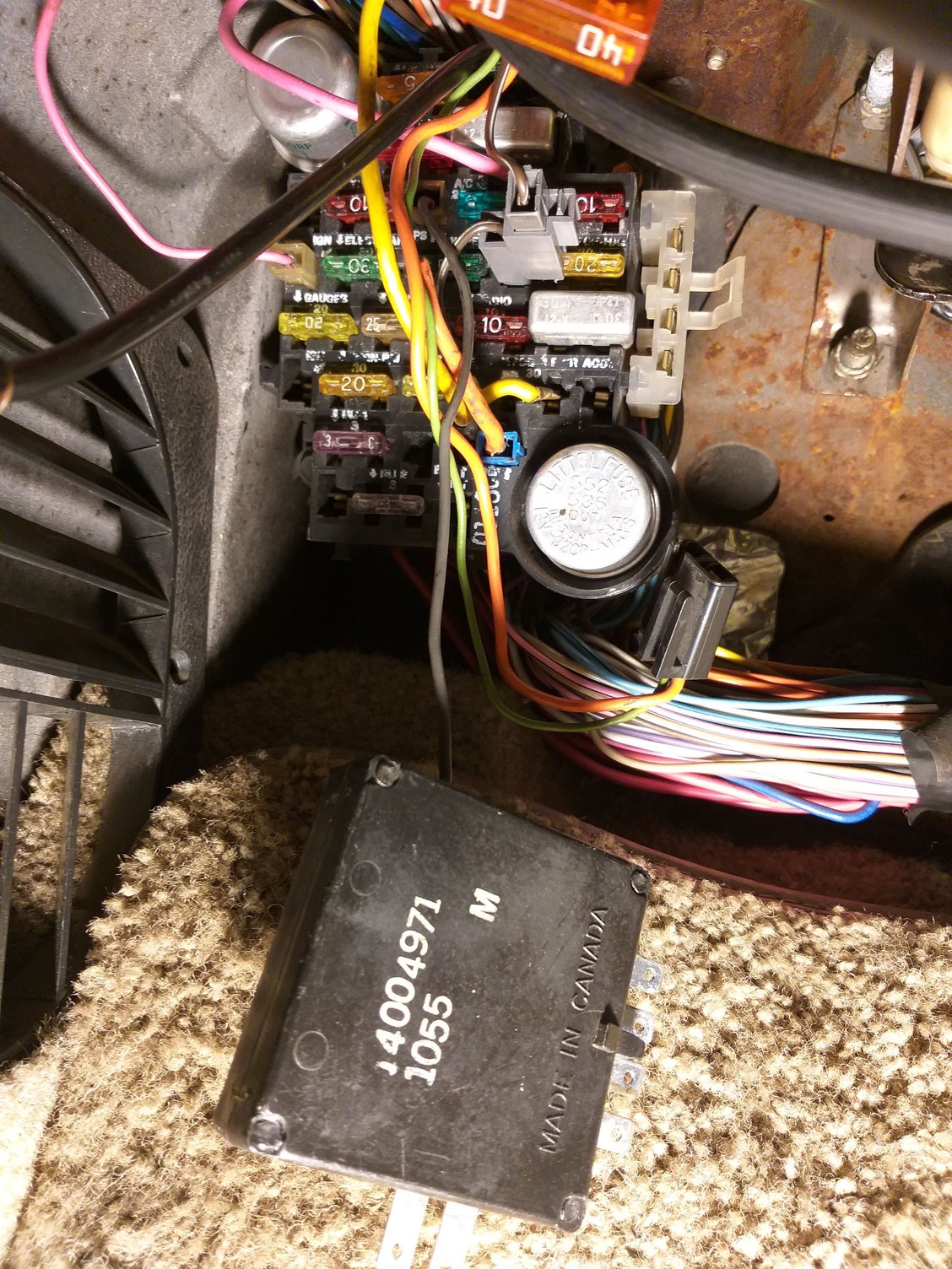

Old Aug 24, 2020 | 04:17 PM
  #59
Maxim0's Avatar
Maxim0
Joined: Aug 2020
Posts: 63
[QUOTE = FASTAZU; 1602063984] Potrebbe essere necessario scollegarli e vedere cosa smette di funzionare
Guardando nel mio
cavo arancione FSM è agganciato per lo sbrinamento.
Giallo il mio essere a parte di un fusibile da 30 ampere. anche la miccia antiappannante.
[/ QUOTE] v'è un filo interrotto qui e non so ciò che è necessario .... e su una seconda fotocamera v'è un filo con un allegata veloce

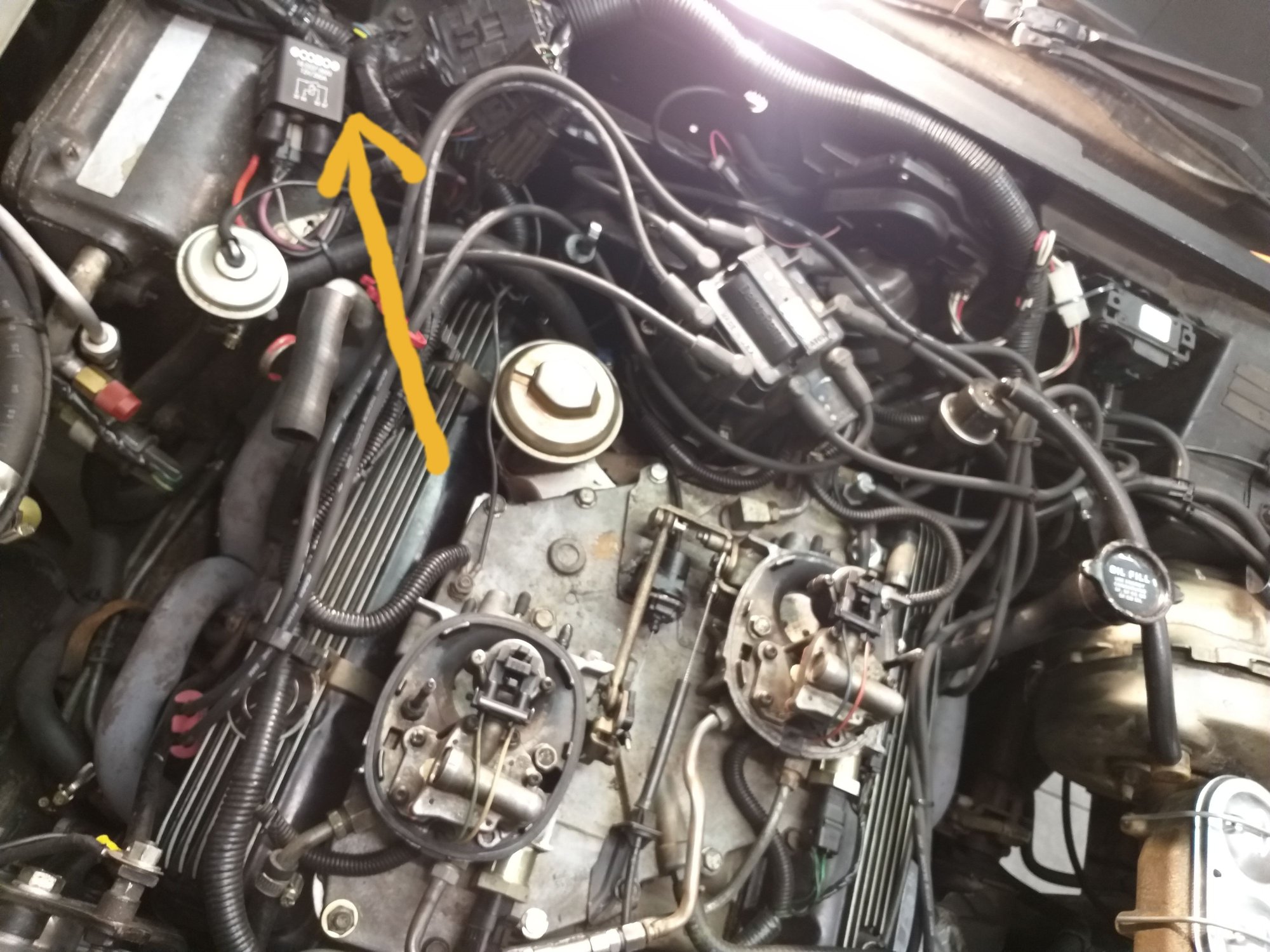

good morning someone please tell me what this relay is for, what function does this little box have. thanks i have a corvette 82
Old Aug 26, 2020 | 02:01 AM
  #60
Maxim0's Avatar
Maxim0
Joined: Aug 2020
Posts: 63
buongiorno, questa è una valvola relè per la temperatura acqua, ho due fili che escono dal motore di colore bianco e uno nero, qualcuno mi sa dire come fare per collegare i due fili ???? il sensore ha due fili bianchi
