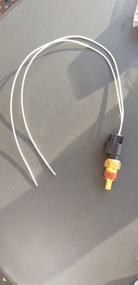

buongiorno, questa è una valvola relè per la temperatura acqua, ho due fili che escono dal motore di colore bianco e uno nero, qualcuno mi sa dire come fare per collegare i due fili ???? il sensore ha due fili bianchi
hello, this is a relay valve for the water temperature, I have two wires coming out of the engine of white and one black, can anyone tell me how to connect the two wires ???? the sensor has two white wires

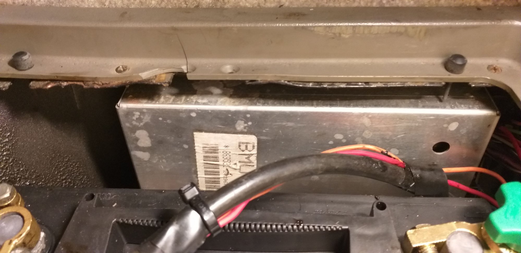

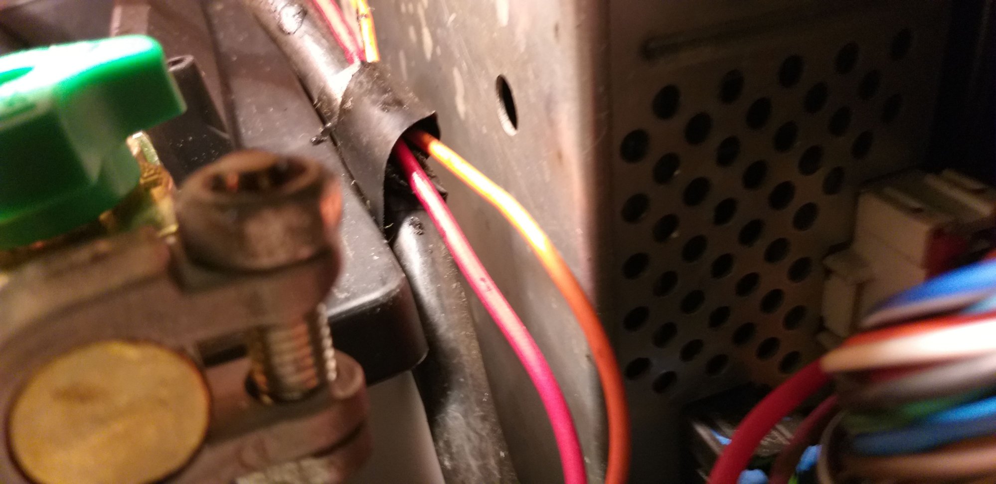

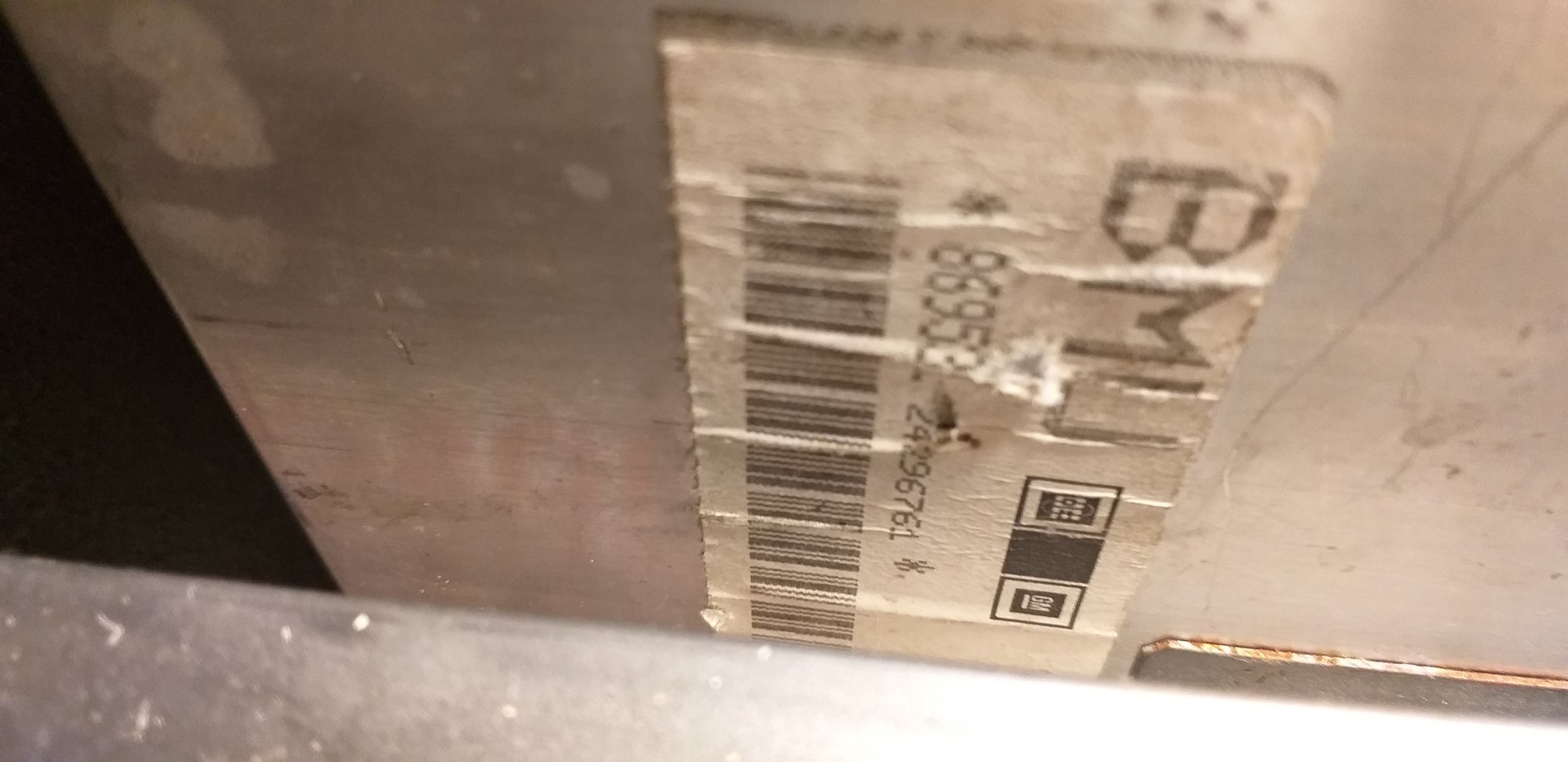

I know you have your hands full right now, but can you take a photograph of the car electronic control module (ECM) for us? It is located in the battery compartment on the front side.
Do not disconnect anything. I just want to see is the previous owner changed the engine control computer and possibly has the wrong one in there.

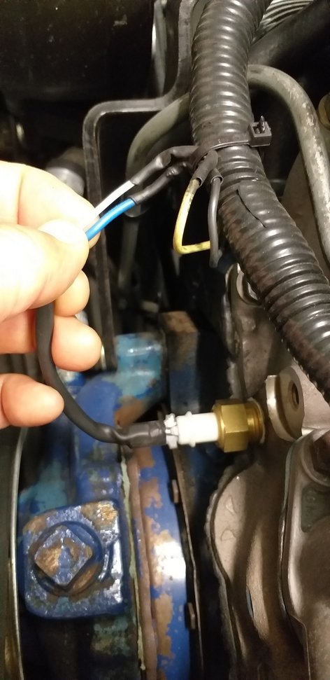

That brass plug in the last picture is the Engine Coolant Temperature Sensor that sends temperature information to the car computer.

ok ok now i take a picture, but i changed the two ECM sensors on the throttle body, and the car works fine now

this is my onboard computer of my corvette 82 which is in front of the battery
I have to replace the water temperature sensor, I have two wires coming out of the engine one white and one black how do I make the connection if I have two white wires to connect to the sensor ???????

That is great news on the engine. You changed the two Idle Air Control (IAC) motors on the throttle bodies and it started running fine?
That ECM computer looks like the original computer.
I am not sure on the temperature wires. I would not want to tell you anything I am not sure about. If the car is running good, why do you need to change that temperature sensor?

the machine gets too hot, and I already have the two thermostats of the previously ordered water temperature control in the house
