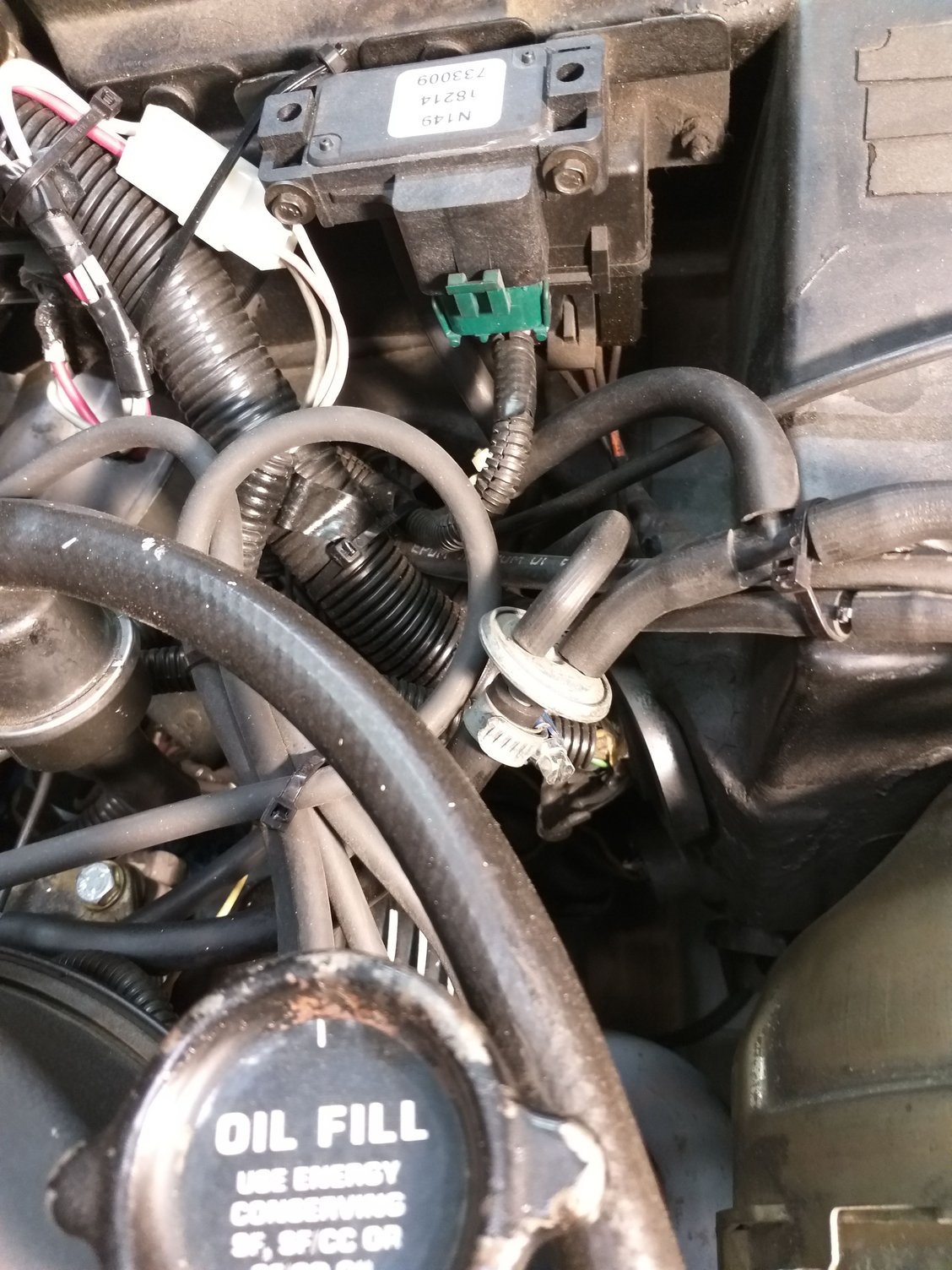

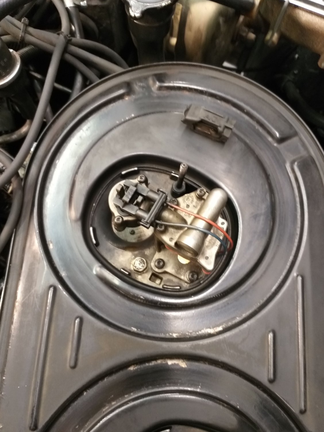

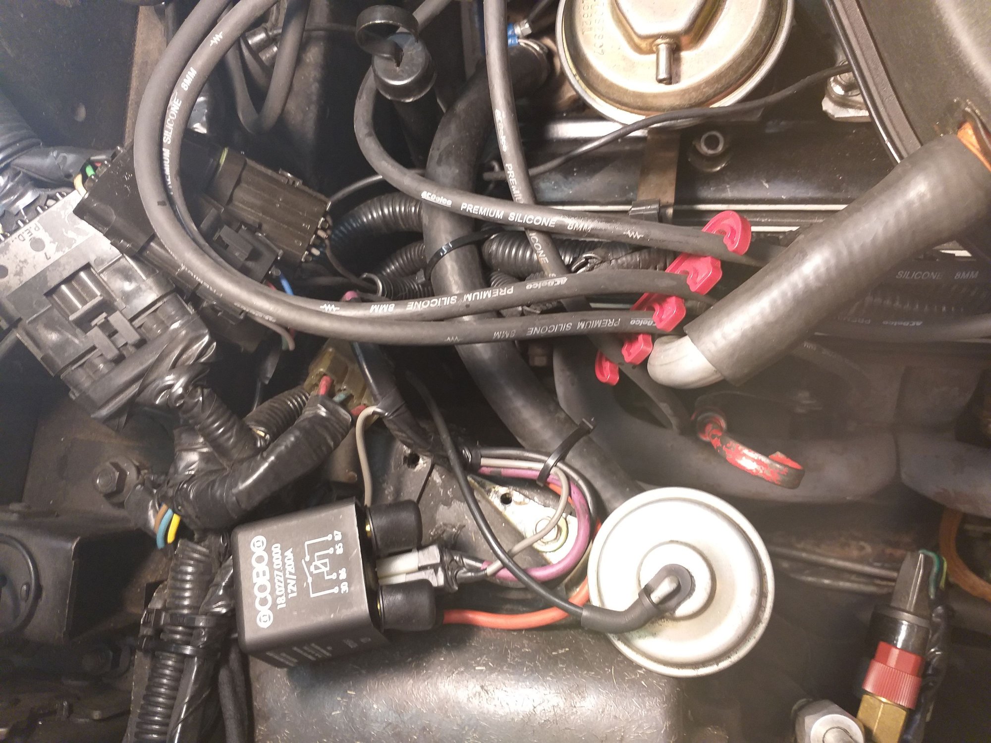

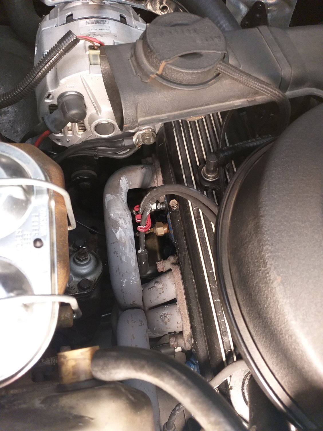

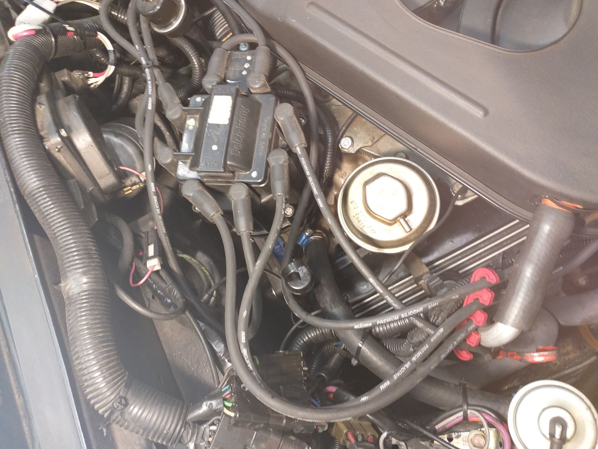

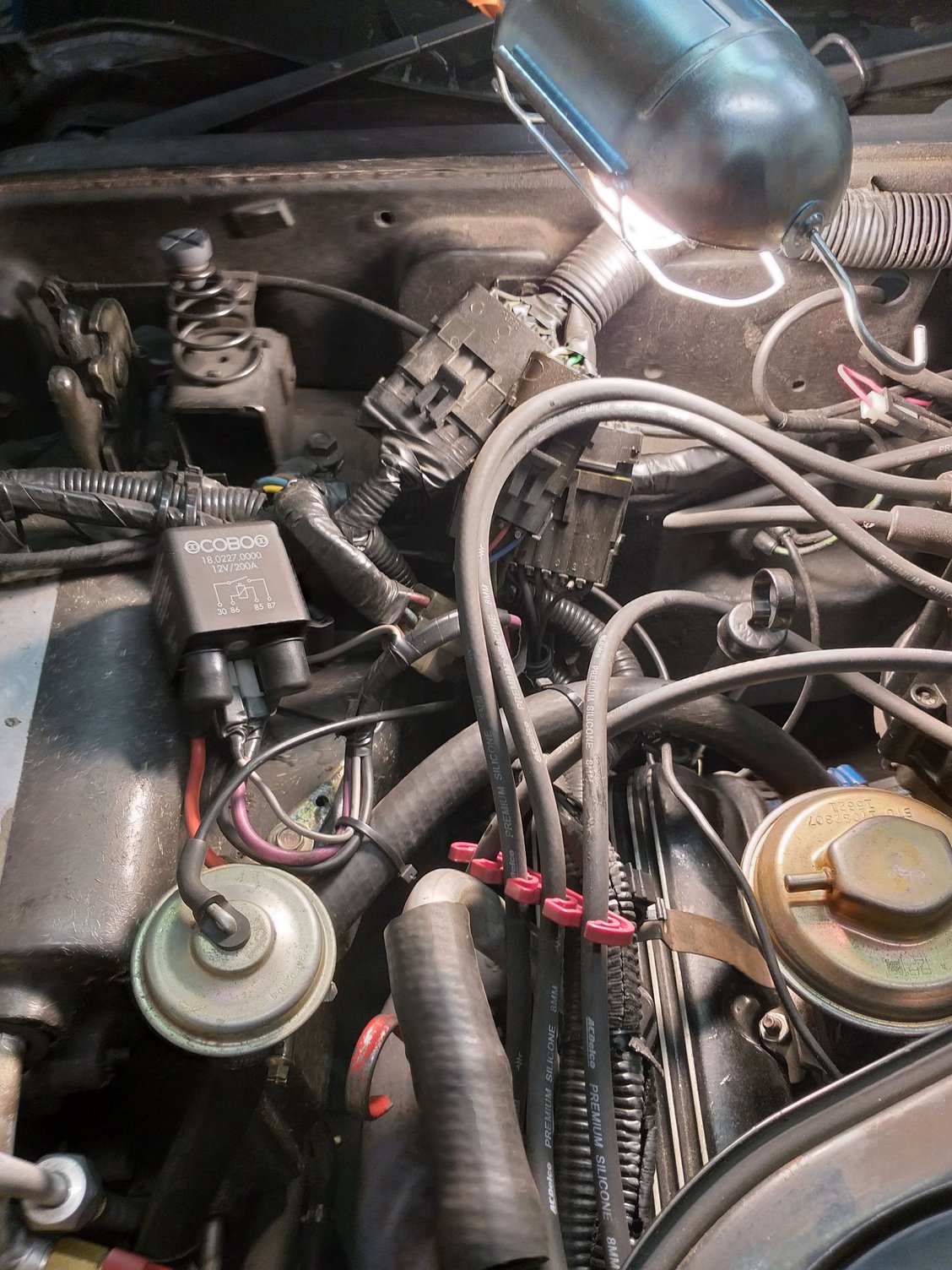

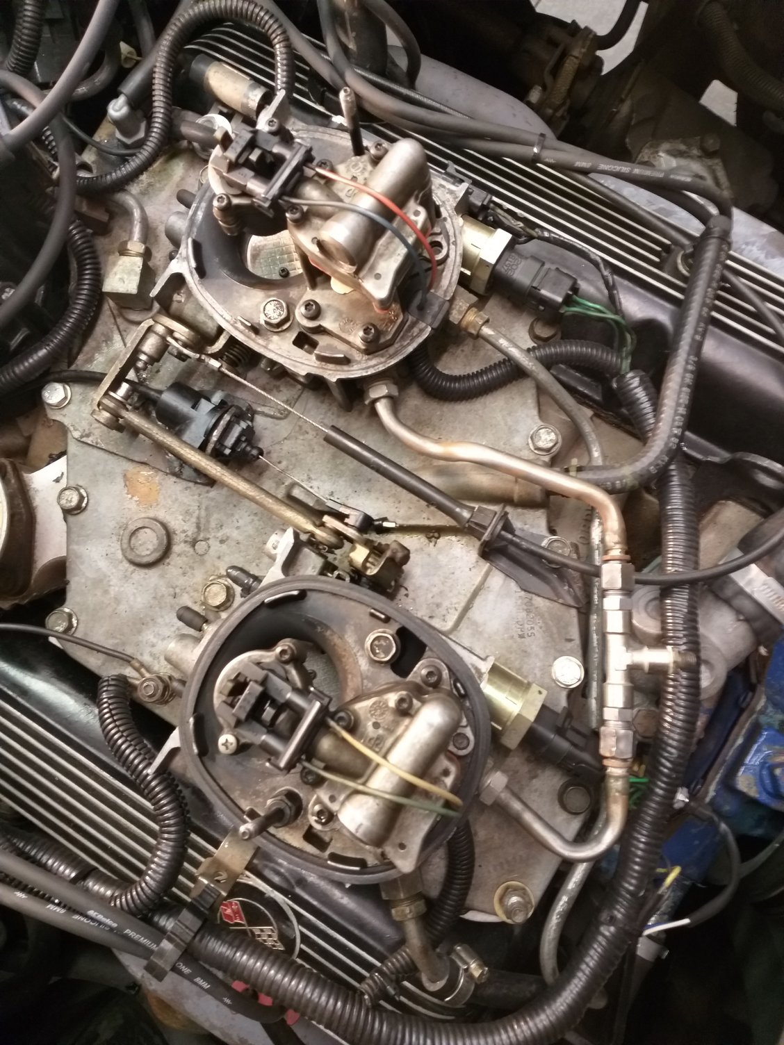

unfortunately I am not able to get in touch with the previous owner. but I'll take pictures of the engine, maybe you'll understand something more

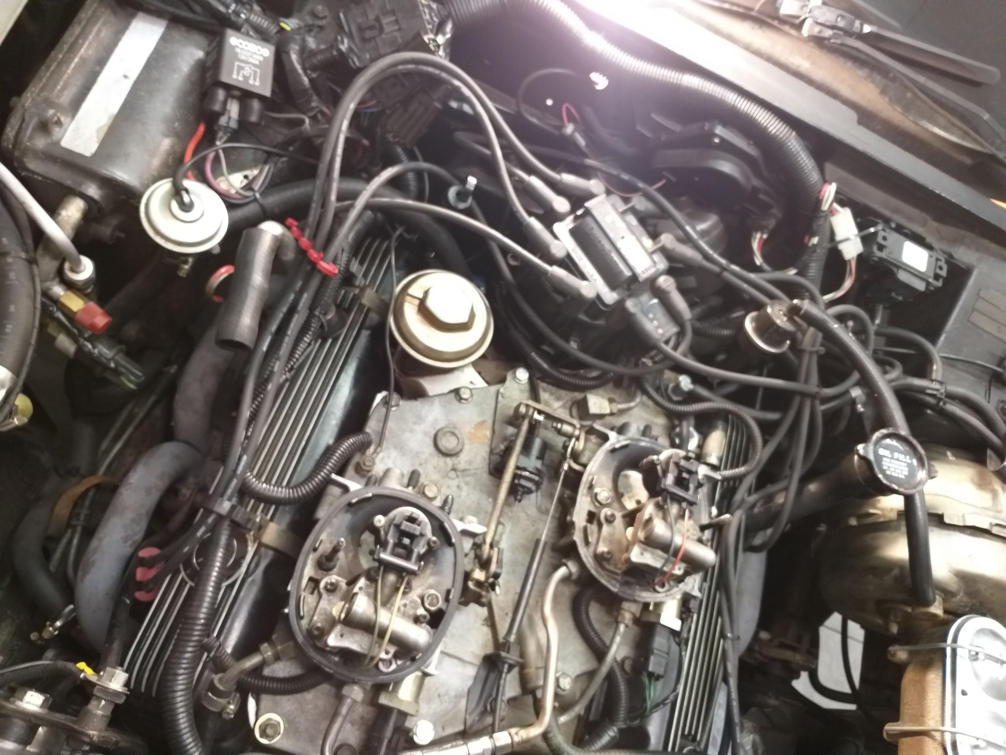

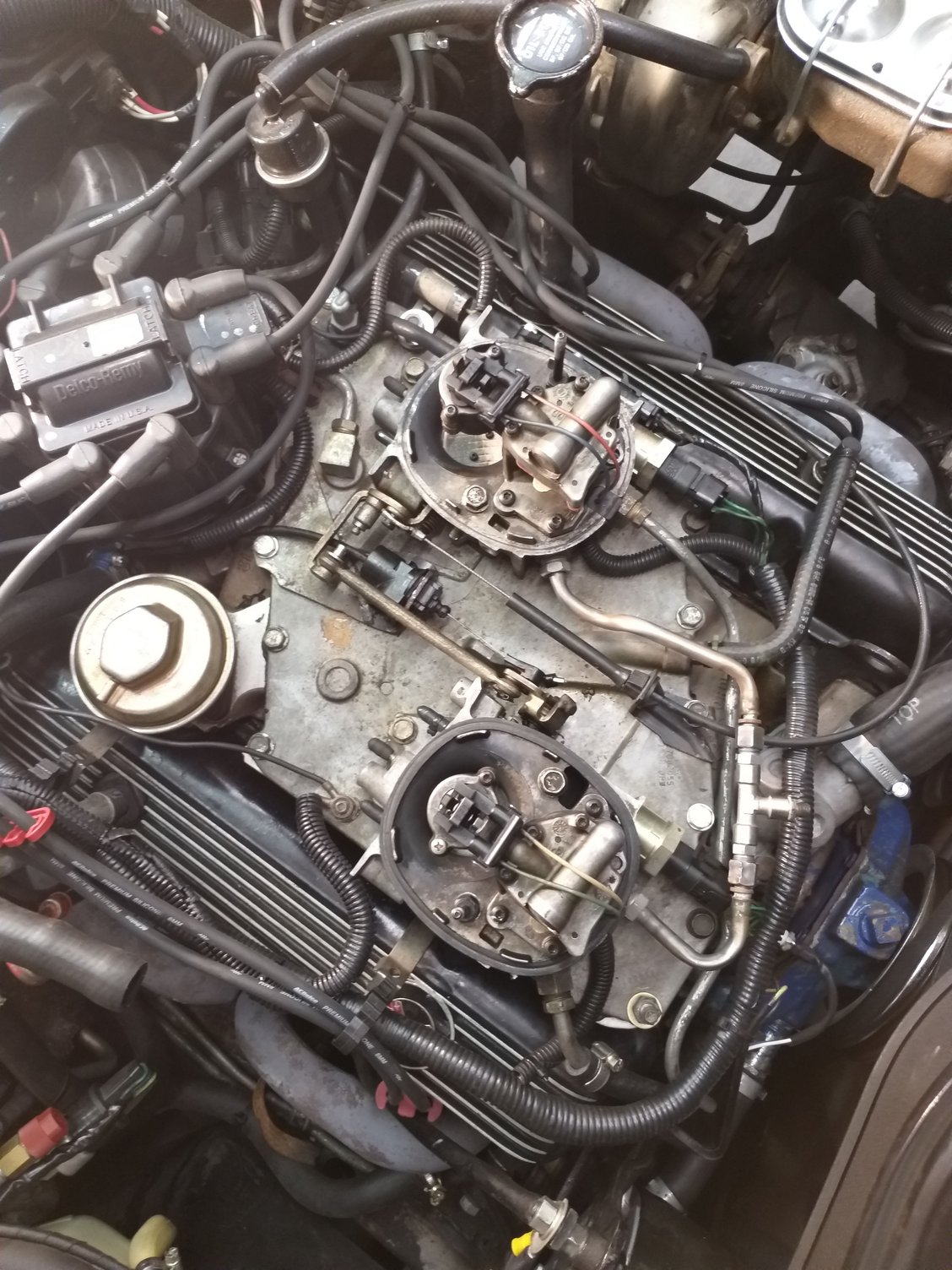

[QUOTE = Maxim0; 1.602.029,468 mila] haaaa ok [/ QUOTE]

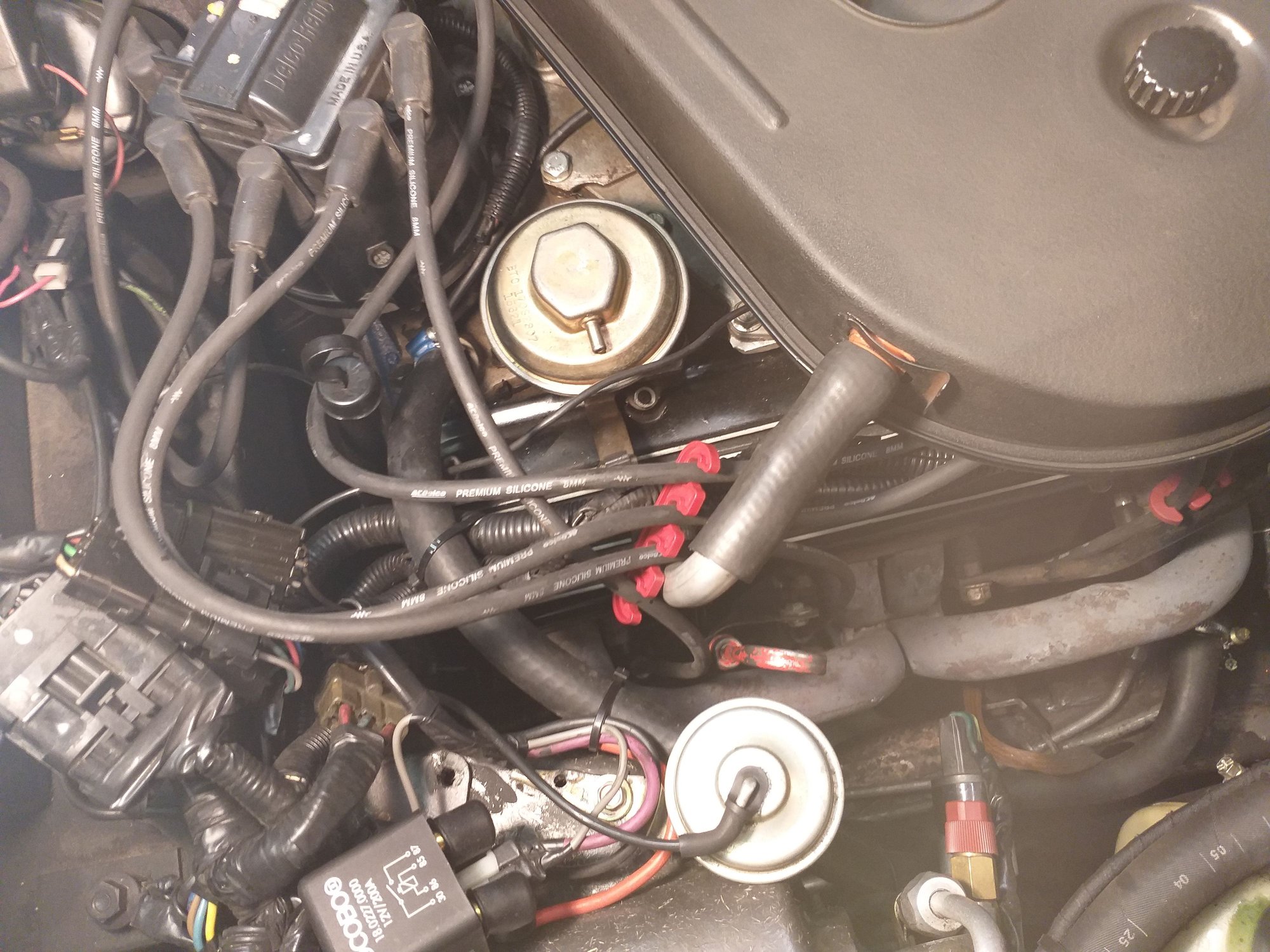

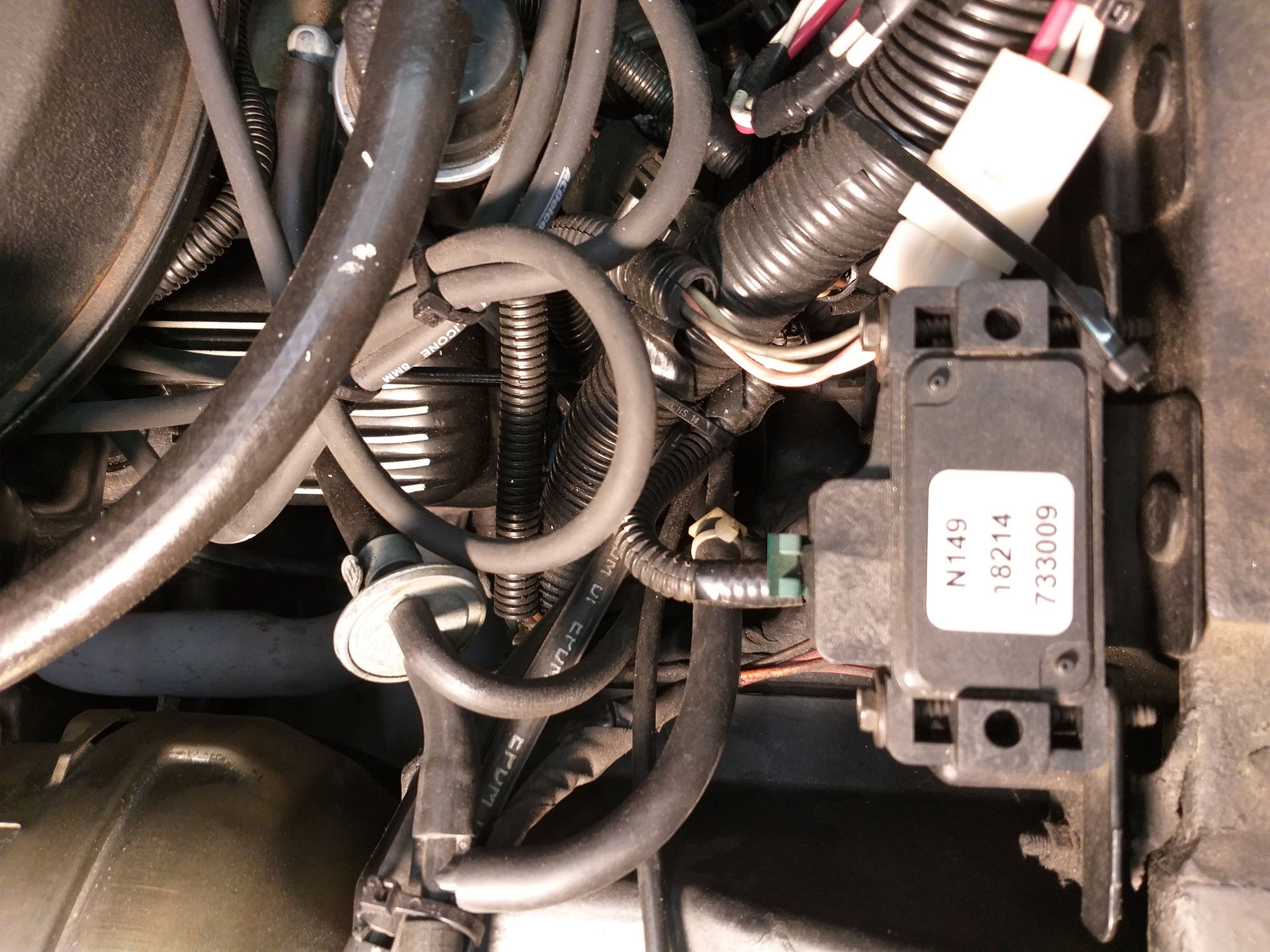

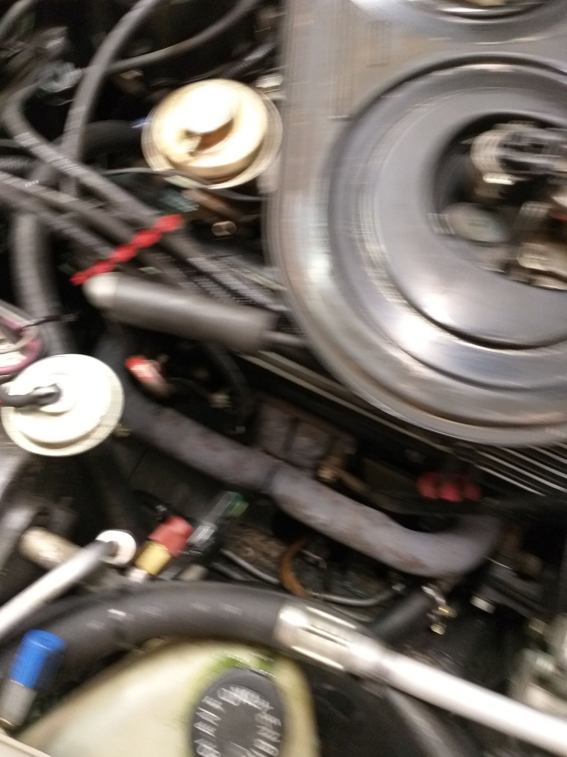

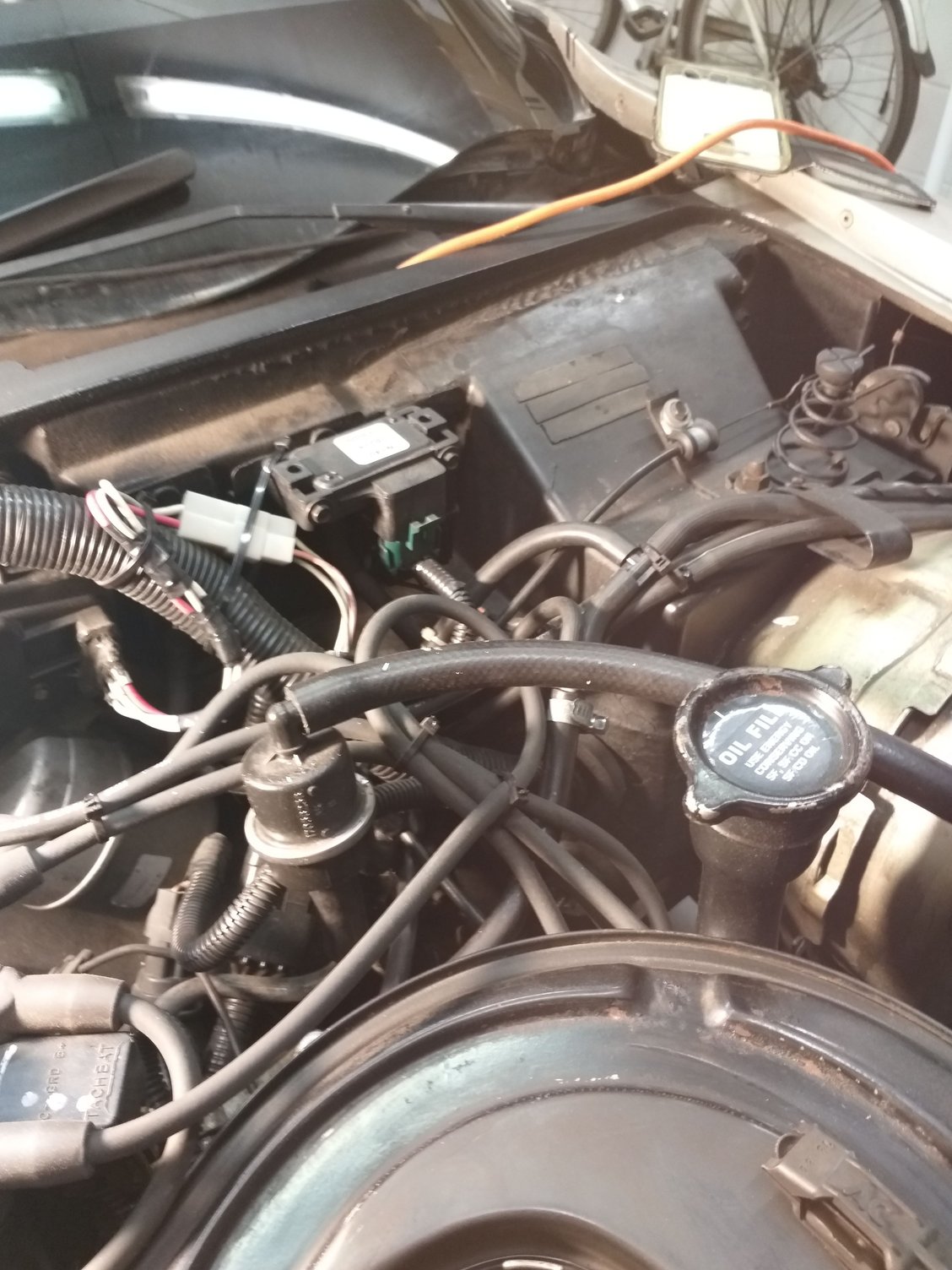

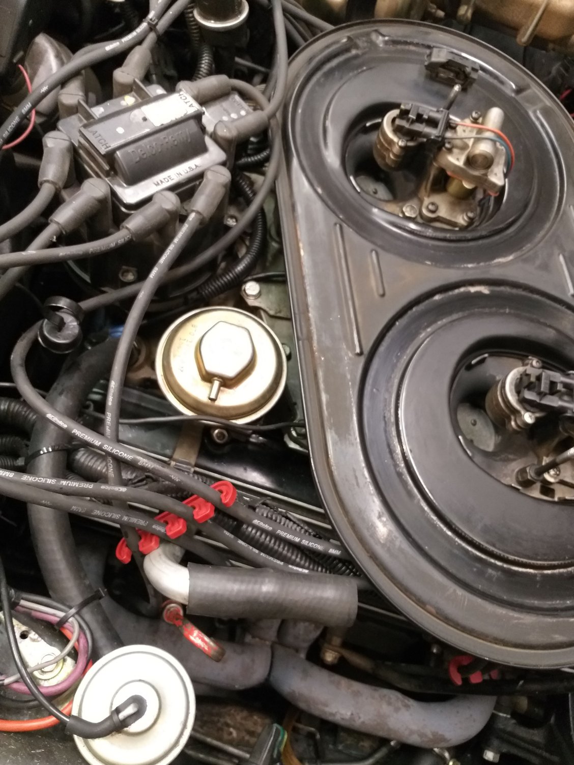

this is my engine
