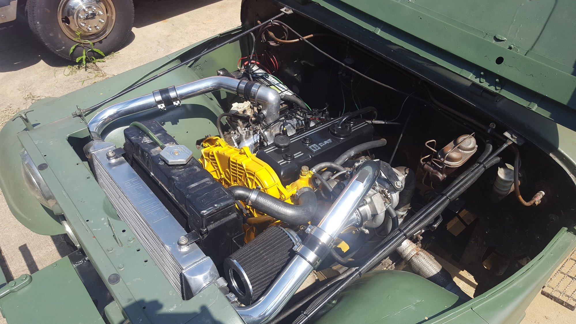

To vindicate myself and my skill set for all the confused newb questions, pics of two motors in my fleet(I own 6 rtr insured vehicles).
I also was a crew chief on 100,000HP F-15E strike eagles in the 335thFS. So even top fuel dragsters seem adorable to me. haha
