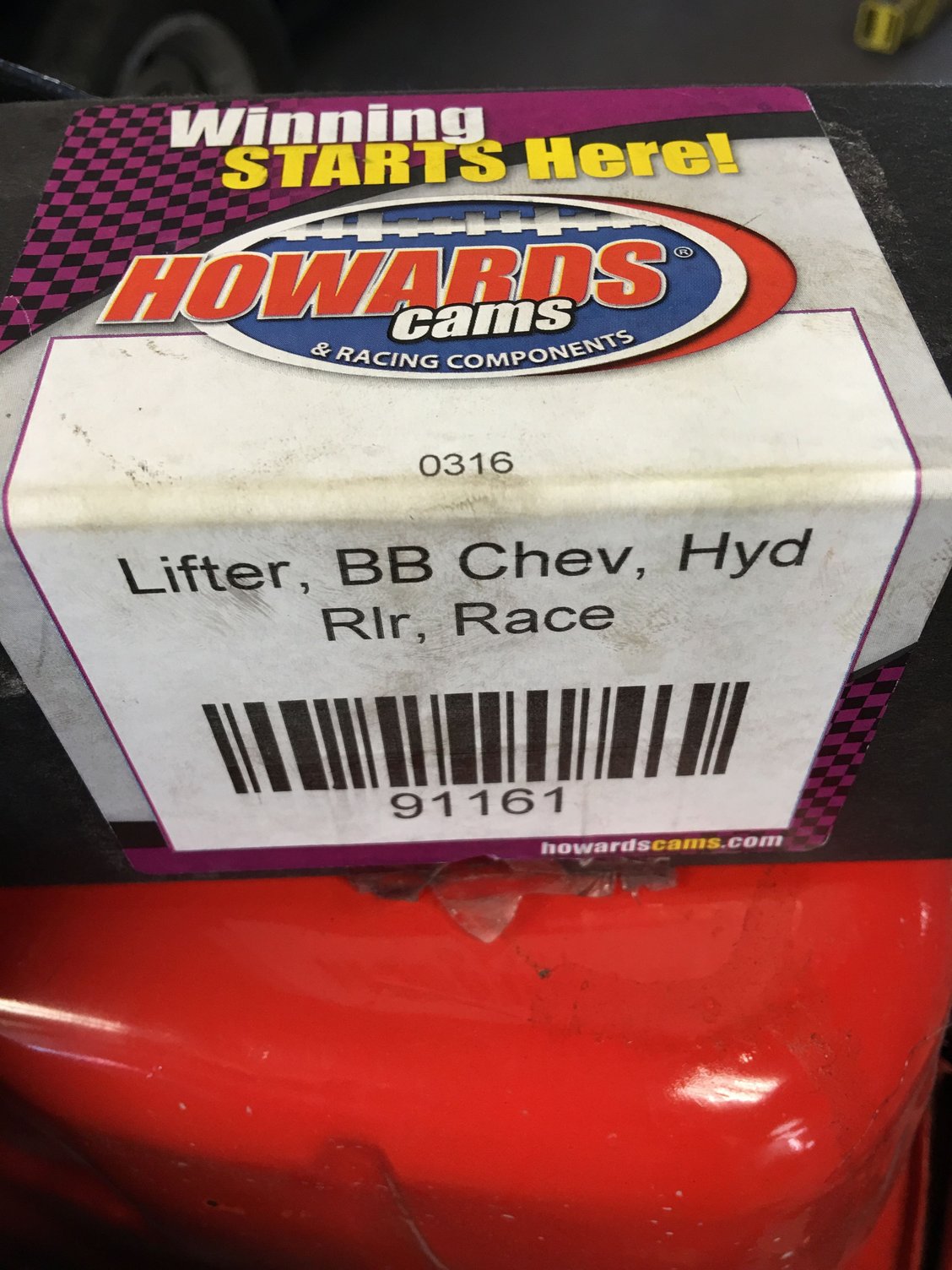

Originally Posted by ronarndt
I have a fairly aggressive Lunati hydraulic flat tappet cam in my 454 NOM in my 68 convert. I am going to change to a roller cam and need to decide whether to go with a hydraulic lifter or solid lifter version. I have used solid lifter cams in a couple other cars and do not mind having to periodically re-set the valve lash. For those who have a solid lifter roller cam, approximately how often do you need to adjust the valve lash? For those who have used both a hydraulic and solid lifter cam in the same motor, how much additional hp did you get using the solid lifter cam?
I have had good luck with these
6500 rpm plus on the straights
1/4 mile paved oval with banked turns.
35 races with absolutely no issues running Schaeffers synthetic.
I run these in every BB build that has a hydraulic roller cam.
They are also the quietest roller lifter I have tried, and I have experimented with quite a few brands.
