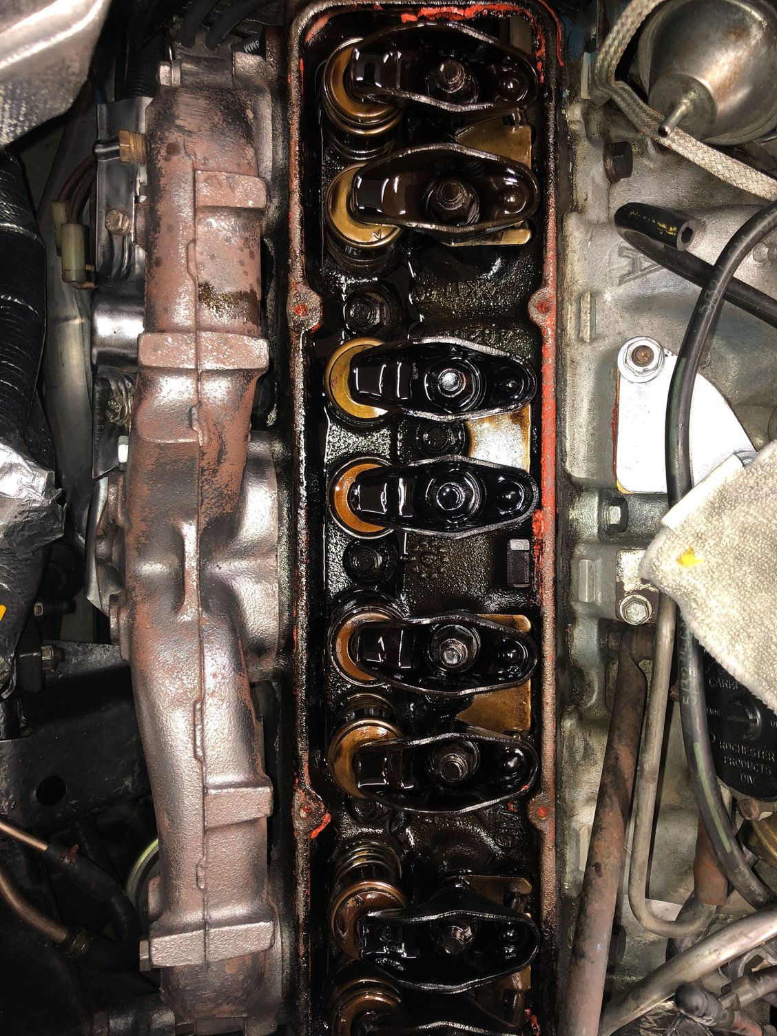

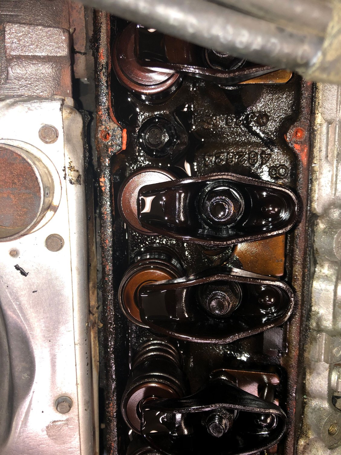

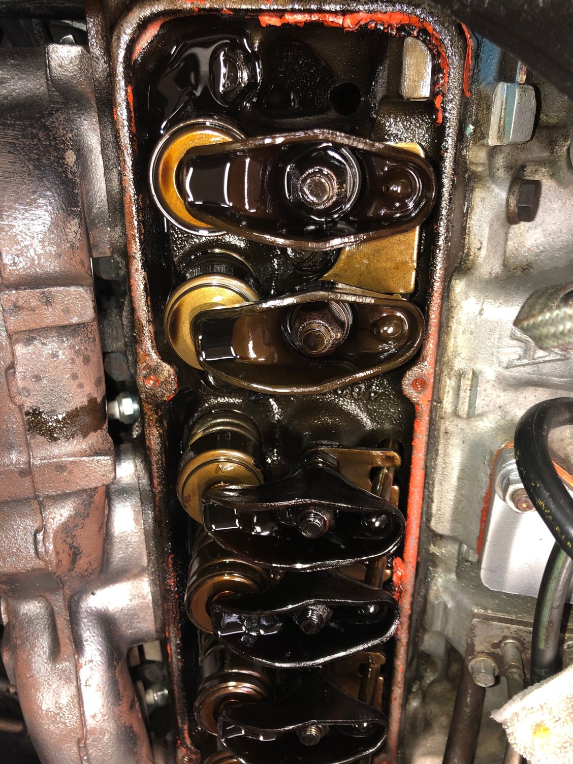

I have a leak so getting around to putting on the recommended fel pro silicone steel gaskets (wow hope they work 60 bucks)..and will strip and powder coat the covers..
it looks like i have those pushrod guides? no clue what they do.. looks like a mile of silicone used prior..not sure what heads i have for a 79 L82 manual..
anyone see anything goofy? 34000 miles
