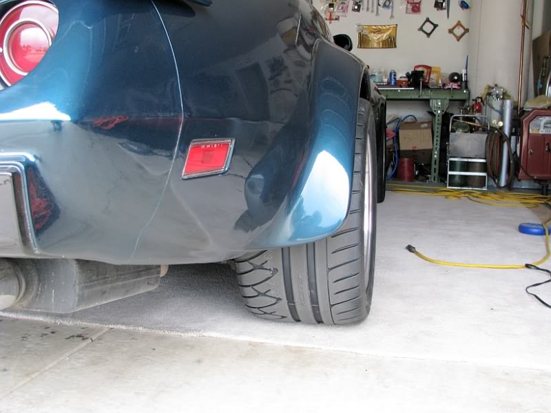

I bought 3 different sets from different vendors to compare what would work the best. One set was just junk without tabs for screwing it in place after I had cut out the wheel wells. I went with the so called semi mud flaps. for my 345 rear tires on 13 inch width wheels.
These are Kumho ultra performance tires and central rain grooves actually really work even with rain so hard that it is running across the road.

I only have HD trailing arms with tom's outer axels. I have 6.5 BS wheels with 2 inch adapters.
