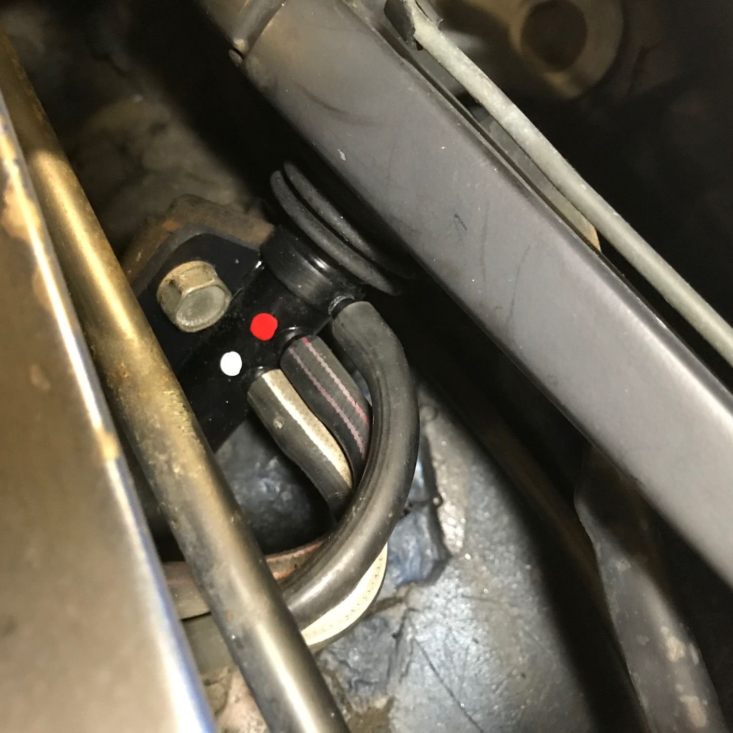

Hey Guys - I participated in an NCRS Judging event a couple weeks ago and unbelievably my 71 LT-1 got a Second Flight award. But here's the downside: during the wiper check in the judging process, the judge was having me go back & forth with the wipers, on and off, etc. The wiper door is now stuck halfway up and will not stow. The wipers no longer work - I just hear a click noise when the switch is activated.
Kind of a big disappointment since I routinely drive the car a couple hundred miles to Carlisle and 125 miles to Richmond for the latest NCRS event. Wipers are good to have.
I notice a hissing noise coming from the wiper door vacum cannister (the thing on the passenger side that looks like a mini headlight vac cannister) when the engine is turned off. Not sure if i never rally noticed it before or what.
Any ideas on what to check???
Marlon

If the wiper door will not close then you have a vacuum leak somewhere. If your hearing a hiss then that is the first place I would look.

Wipers fixed! Replaced the 69-72 Windshield Wiper Arm Vacuum Valve. Cleaned out area under wiper grill while at it.

The judge left the rubber plug out of the end of my wiper door actuator - (removal of the plug is necessary in order to judge the wiper arms and wiper well without cranking the car) and mine was hissing like crazy after one show.

Lastly, I chuckled a bit when I read what caused your wiper door cycling to fail. The same exact thing happened to me just two days before I had my car judged. I had to search frantically to find a replacement and get it installed in time. A lousy design, the weather boot does a poor job of protecting the piston. The plastic construction is poor as well. It's also tough to get to the fasteners on this too, yes?
