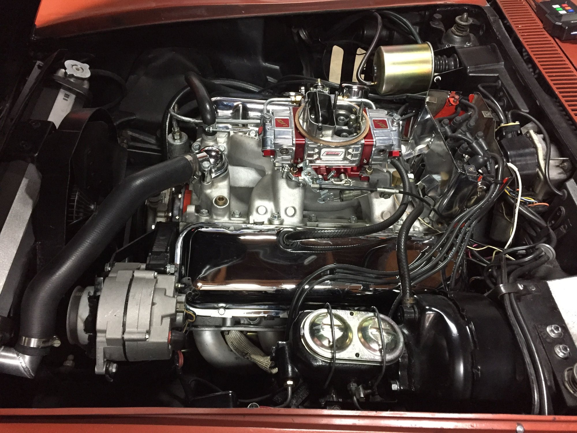

I'm still sorting out issues with my 540. I got it t run pretty good with a borrowed HEI distributor(no tach drive). Adjusted the AF mix on the Quick Fuel SS850 with an Innovative Wideband Meter. Initially it was rich or very rich at all rpms and loads. I ended up installing 0.0345 IFRs instead of the 0.036 stock IFRs. Also went to 0.073/0.79 from the 0.080/0.086 stock jets. Highway cruise was around 14:1 AF mix. Ran great at WOT and would melt the 275 tires in 2nd gear.

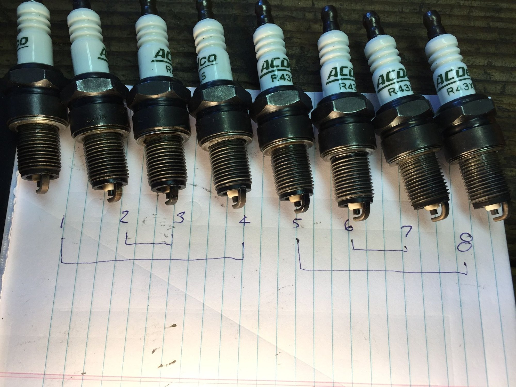

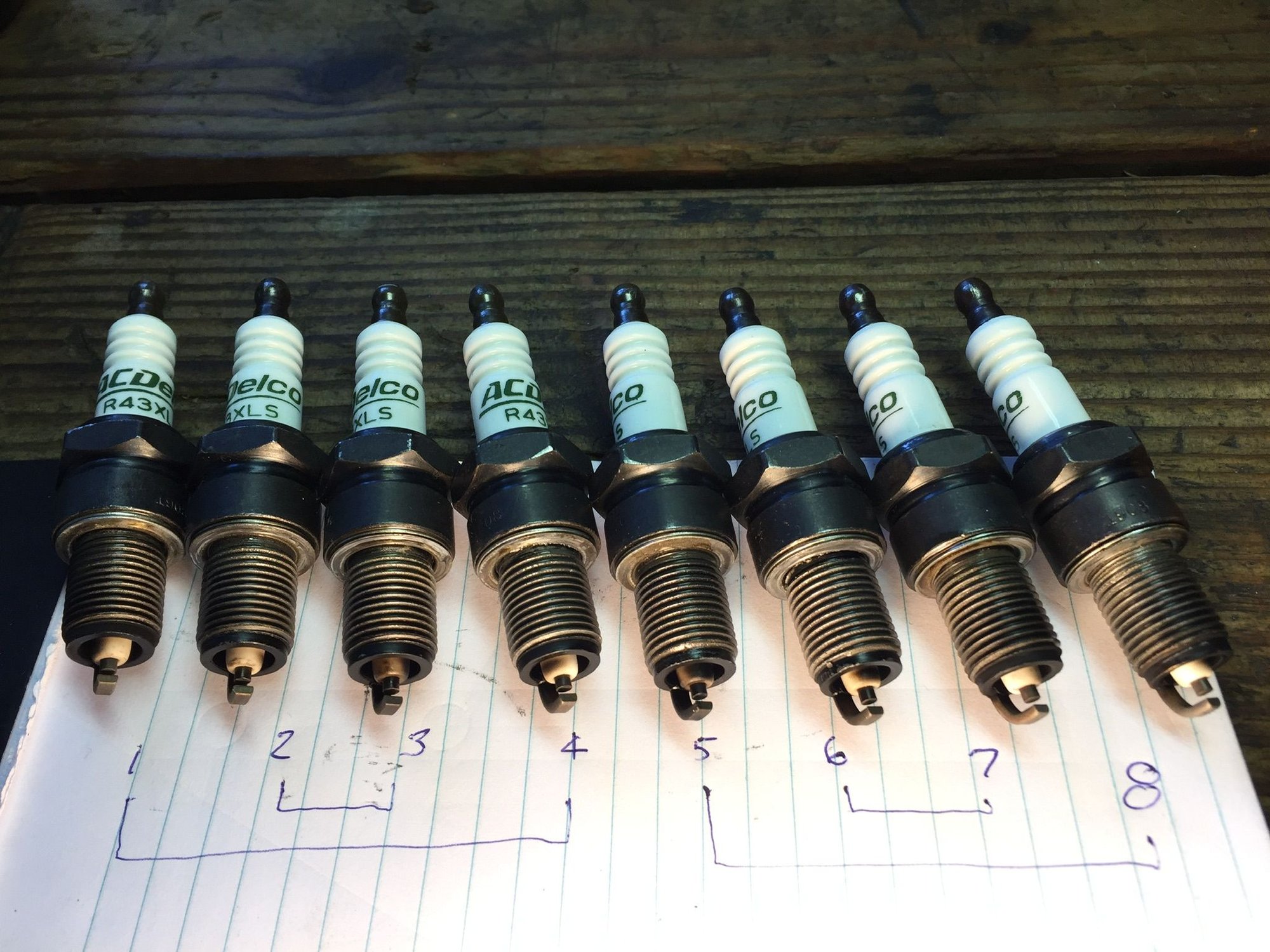

The problem is I want to run my TI distributor and maintain a somewhat stock looking engine. I don't like the HEI look and hate not having a tach. Between the tuning with the HEI distributor I installed the TI unit and the car ran like crap and fouled plugs. I ended up getting a new board because when I tested it, the voltage at startup didn't increase like it is supposed to. Also installed a new stator/magnet inside the distributor. The coil was replaced (correct from Zip) several years ago and probably had 500 miles on it. Eventually the car died and left me stranded until it cooled off- thinking bad coil. I ended up buying a coil from TI specialties ($$$!) and it solved the stalling problem. But now, I'm getting a steady miss at 2500 rpm, the AF meter shows 16:1, and the spark plugs also show lean. Timing is set all in 36 degrees at 2500rpm with vac advance plugged. I don't see why it would suddenly be lean. I checked for vacuum leaks and can't find any. Plugged the headlight wiper door accessory port too.
I'm not sure what to do at this point. Put the original IFRs and jets back in the carb and see what happens? I can put the old stator/magnet back in but the old board I know is bad on the start circuit. Maybe just punt and get a new HEI that has a tach drive.
Any help or test procedures are appreciated.
