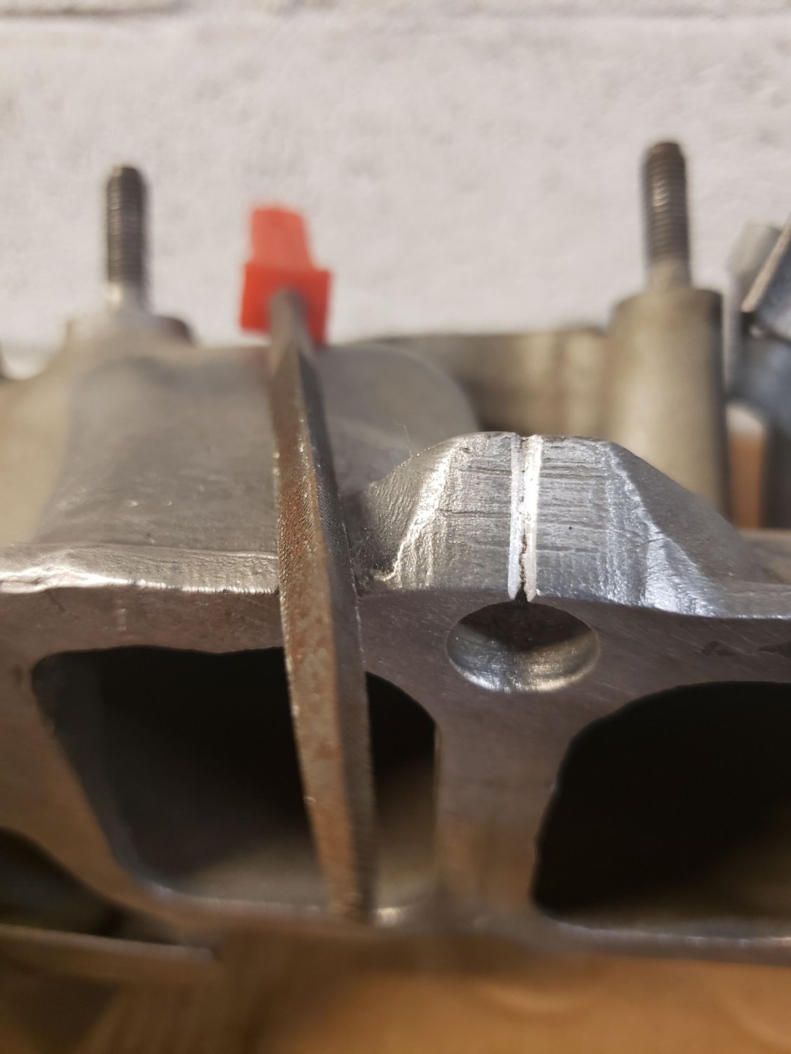

Default Crack intake update
Triangle Filed it, acetone and then JB weld. Finally sanded. We will see if it holds
Use an ARP bolt kit.....put some moly between the washer and the bolt shoulder....this will keep the washer from trying to spin when you tighten which will try to spread it open. Tighten just snug....do all the others in a pattern and tighten that one last....2-3 steps.
Jebby
That sounds like excellent plan. Thanks

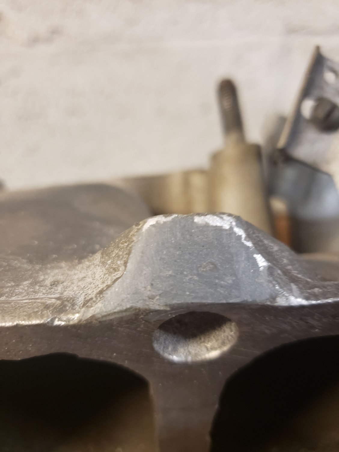

Old Dec 19, 2020 | 04:51 AM
7T1vette's Avatar
7T1vette
Posts: 37,637
Likes: 3,118
From: Crossville TN
Not that good looking for a bare aluminum intake, IMO. Less that $20 would have netted a simple heli-arc weld job so that the repair could not be seen.
Old Dec 19, 2020 | 07:26 AM
4speed69's Avatar
4speed69
Joined: Dec 2020
Posts: 44
Likes: 16
It was still wet, i will try and take another picture. You can't see the repair. 20 dollars seems awful cheap to have anything done, unless you know the person or they are desperate.

What the he!! is that supposed to mean? I would do the same thing I recommended to the OP....have the part heli-arc welded to make it RIGHT.
Are you an "agitator", "instigator" or just a "meddler"? I'm sure the OP can respond without your "assistance".....
The OP prepped the part extremely well: nicely grooved and clean....ready to weld. The JB Weld epoxy will make a "functional" repair and probably last quite a while. But the repair would be hard to miss when looking at the engine, and with that valuable/desirable intake, a proper fix would have been best, IMO.

I did do alot of reading on this fix. I guess I will see what happens. I was really proud of the way it turned out and wanted to share with the picture. I will always keeps a eye on it and if if needs repaired again anytime soon, I will weld it. I understand the repair should last many years. Thanks for the input and Merry Christmas.
