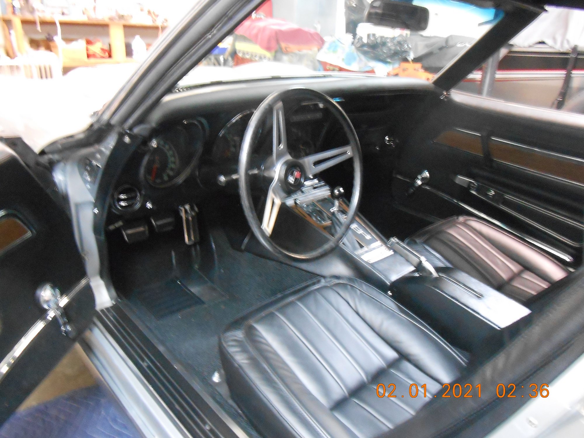

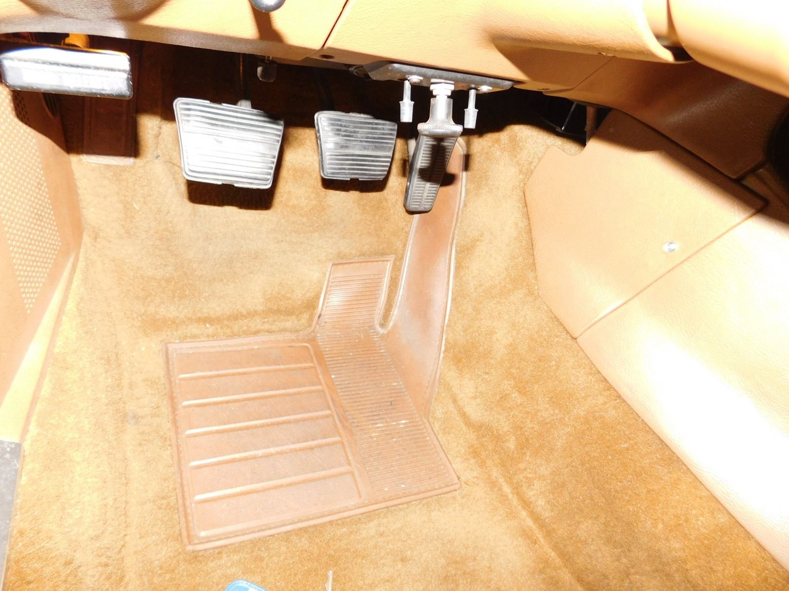

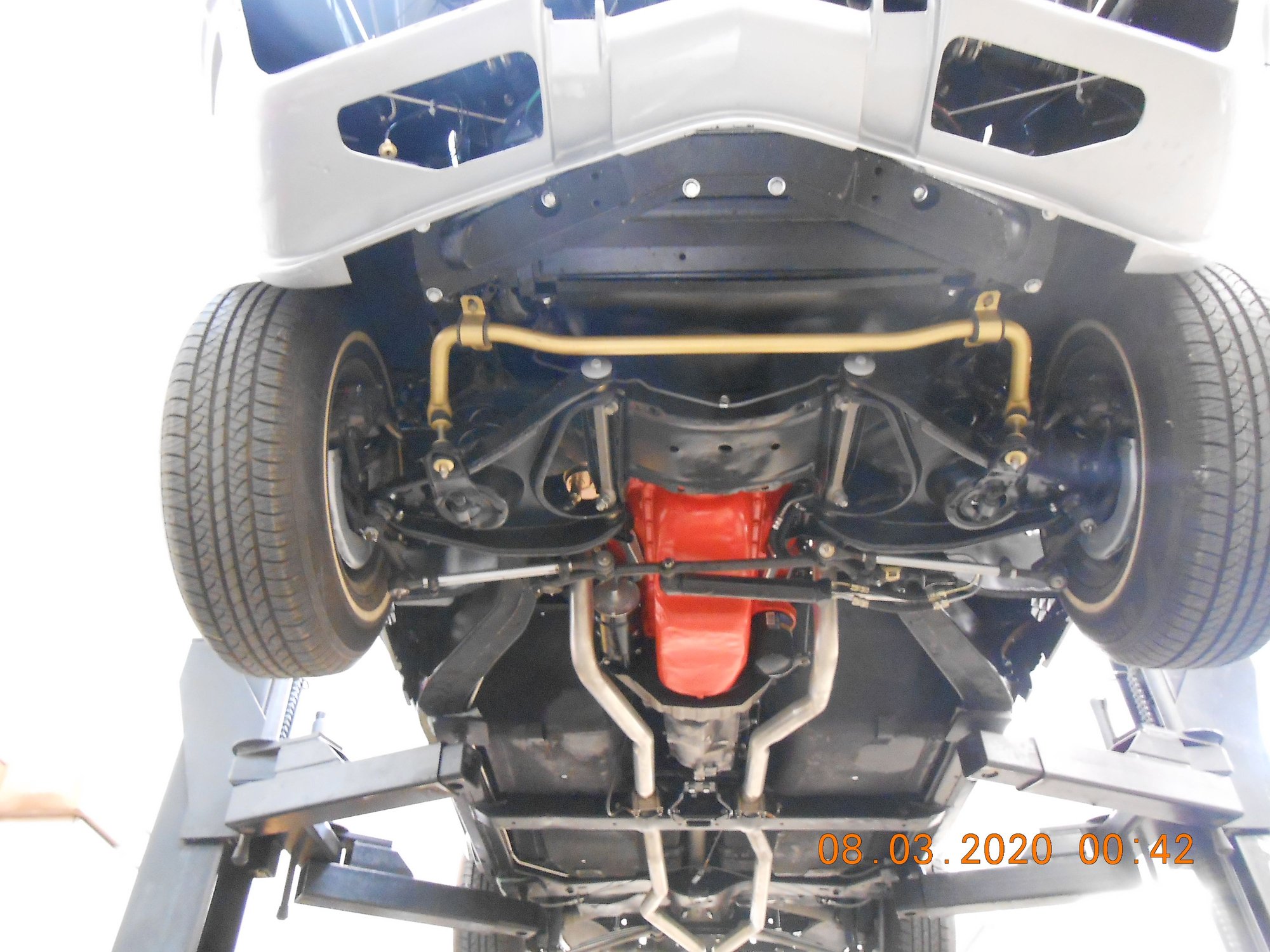

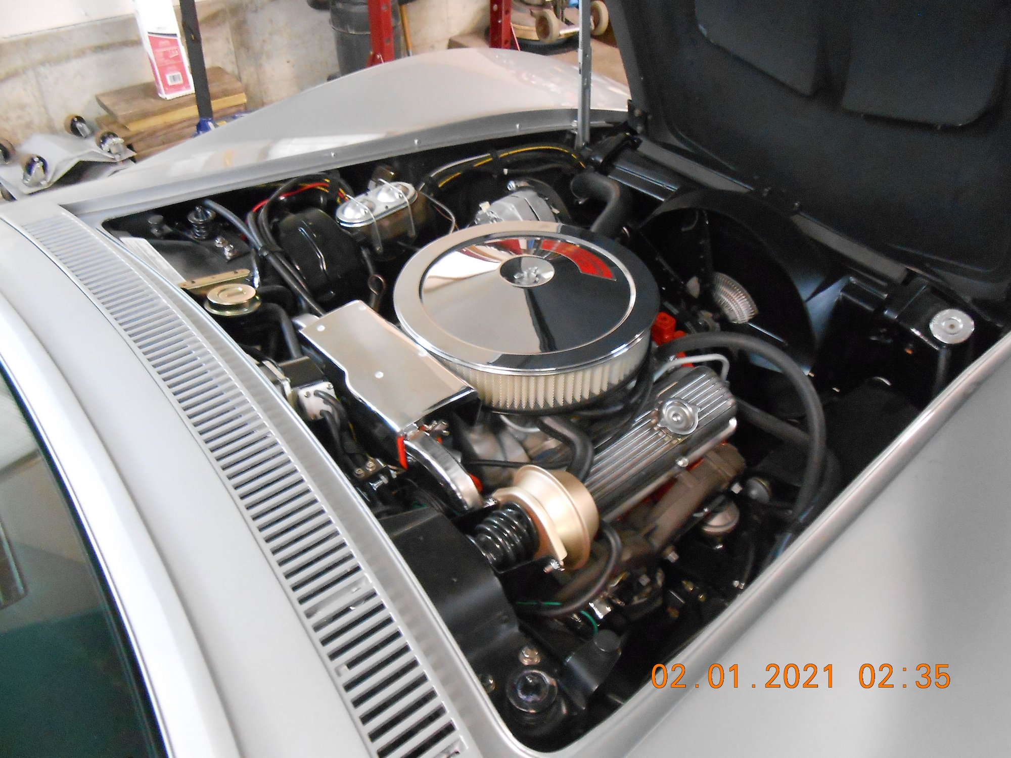

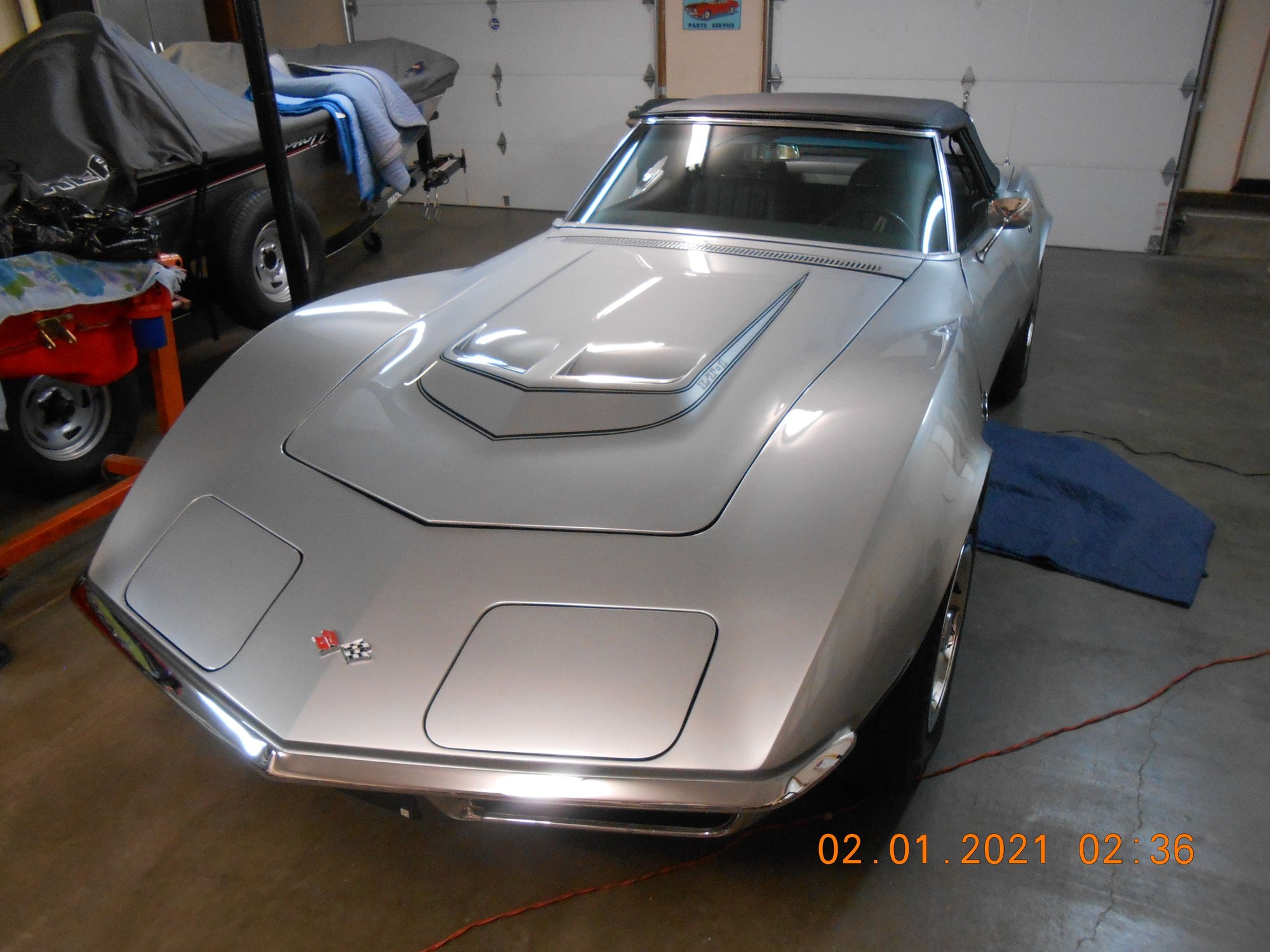

Here are a few pics of the ground up body off restoration on my 1970 LT1
