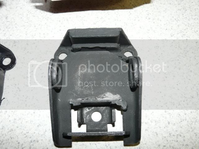

Originally Posted by Sayfoo
Anchor was the brand that ALL the local parts houses carried years ago when I rebuilt my engine. They are still working fine 10+ yrs later.
In reading the threads on other forums they agree with you that the older mounts made in Korea were ok. Nowerdays you need to be careful and not accept one made in India. So Anchor appears to be a hit or miss.
Even posted a comparison:
Korea
India.
