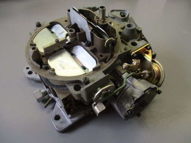

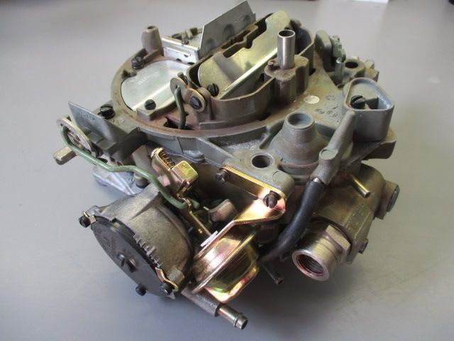

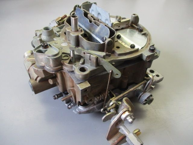

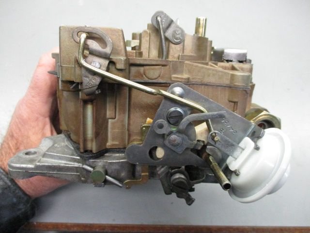

The significant difference between the '69 carb and the '77 carb is the fact that they're two completely different model/series carbs: The 69 (and up through 1974) Q-Jets are 4MV (divorced choke) carbs. The 1975+ carbs are M4M (integral choke) carbs. The '77 carb will not interface with the choke system on your '69 427. You'd also want to open up the IFR restrictors in the carb to use it on the big block and run the biggest primary jets you can get, which will likely be 78's along with a richer set of secondary rods (like some original '69 "AX" rods).
1969 7029215 427 390-hp Q-Jet:
Note modification to the lower part of the throttle lever to clear the 427 intake:
The 1977 carb looks like this:
Note the throttle lever:
