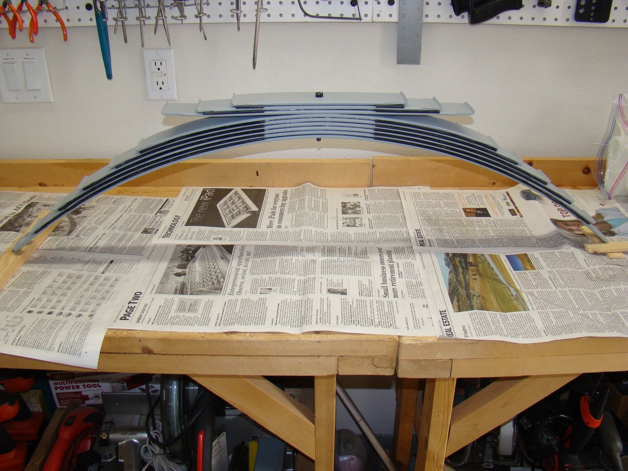

I have heard it is easier when you have the trailing arm nearly horizontal. It curves toward the front as it goes down, putting an angle into the spring bolt. Spring is longer at that height too, so spring bolt is much more vertical that way. Block it at that height between the TA and the frame. But you will have a lot more load on the spring that way, and it will need to drop 6" or more to unload it.
I heard clamping a small 2x4 piece to the spring inside of the jack with a c-clamp is a great idea so the jack does not slip sideways.. Saw one guy using vice-grips clamped there.
The spring will have a lot of angle on it right before it is completely unloaded and would tend to kick out the floor jack (not a bottle jack). It needs to roll sideways a little..
The 9 leaf spring, as shown, has around 8.5 to 9.5 free arch when completely unloaded and is almost dead flat when installed in the car. Be prepared for this. Notice the almost 45 degree angle of the spring end at this point, which is why you want a block of wood clamped to the spring, so the jack doesn't slip.
It has 1000 lb of force stored in it when flat, so it is best to release it slowly and carefully.

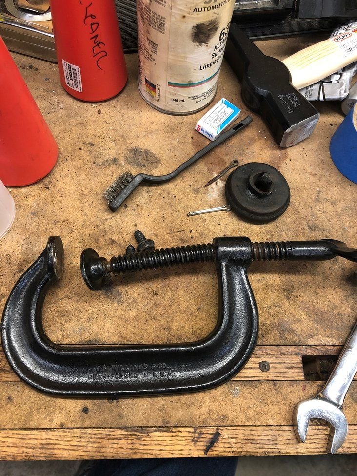

its no joke the pressure of those springs.. mine bent a c clamp..
also i used an impact and held top of bolt to get nut off.. a surprising PITA
