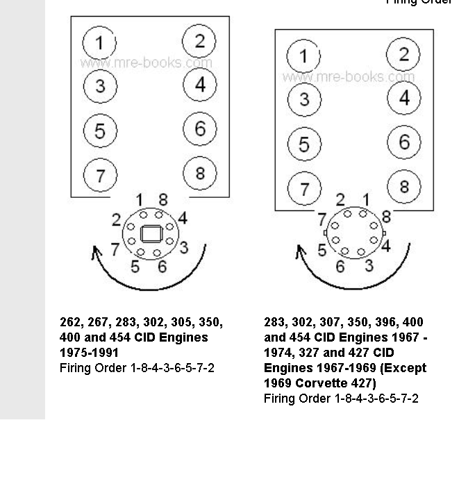

What engine are you working on. The 327 350hp is different.

Well, if you look it up you will find that the distributor doesn't point to the #1 cylinder when at top dead center. If the distributor was removed it wont go back in pointing at #1. Trust me,,,,, I went through this trying to reinstall my distributor. It will be pointing at #4
Yes, this was done because the tach drive cable hit the firewall and caused bends to be too severe. Not sure why '69 is unique in not requiring this... It was no longer an issue for '75 and after because the tachs became electronic rather than mechanical. It will point to #1 cylinder if you reinstall the plug wires one tower counterclockwise but if you don't do that, it won't.
Nonsense. The two diagrams you have posted above are for 2 different distributors, and have been taken from inaccurate manuals such as Chilton's or Hayes - those are not GM shop manual diagrams. The one on the left is for HEI - not points. The distributor will go in perfectly to the #1 position in any Gen 1 engine - it will rotate and move over to the next location in the firing order if you do not account for the helical angle of the gear, but that's an installation technique problem - the engines are absolutely not different. I build 327/350 engines all the time. What you're saying is factually incorrect: The distributor will always point to the #1 plug tower when the engine is at TDC on the compression stroke - the engine will not otherwise run.
GM did issue a Service Bulletin to re-clock the distributor housing on the tach-drive distributors to avoid kinking the tach drive cable on all C3 Corvettes with points distributors, but it did not change the relative position of the #1 plug tower.
Correct distributor installation for all Chevy engines with points distributors. No difference for 327/350 or any other Chevy engine:
Service Bulletin for re-clocking of Corvette tach drive distributors to avoid kinking tach cable. The Bulletin ended up being applied to ALL Corvette tach drive distributors in all engine combinations, including 350 and 427. This particular version of the Bulletin just lists the 327, because it was printed in 1967. This was applied to all tach drive engines from 1968 through 1974:
This is a clocking orientation for HEI vs Points distributors in any Chevrolet powered V8 car.
#1 can be put anywhere in the eight positions possible, likewise, #1 can stay in its position and the distributor can be turned around in a damn circle if you desire.
The only reason #1 is where it is at is because it is favorable for wire sets.....#1 was “moved” on the cap in Corvettes because of the tach drive.

Yep,, exactly what I was saying. If you have one of these early 327's and try to install the distributor pointing at the #1, it wont work.
Sure it will....just clock the wires on the cap until the tach Drive is lined up.....
The 66’ in the Avatar was a 327/350 and it was clocked #1 facing #1 cylinder.....it doesn’t matter....it is not about the position of the distributor OR the wires.....it is about the phase.
