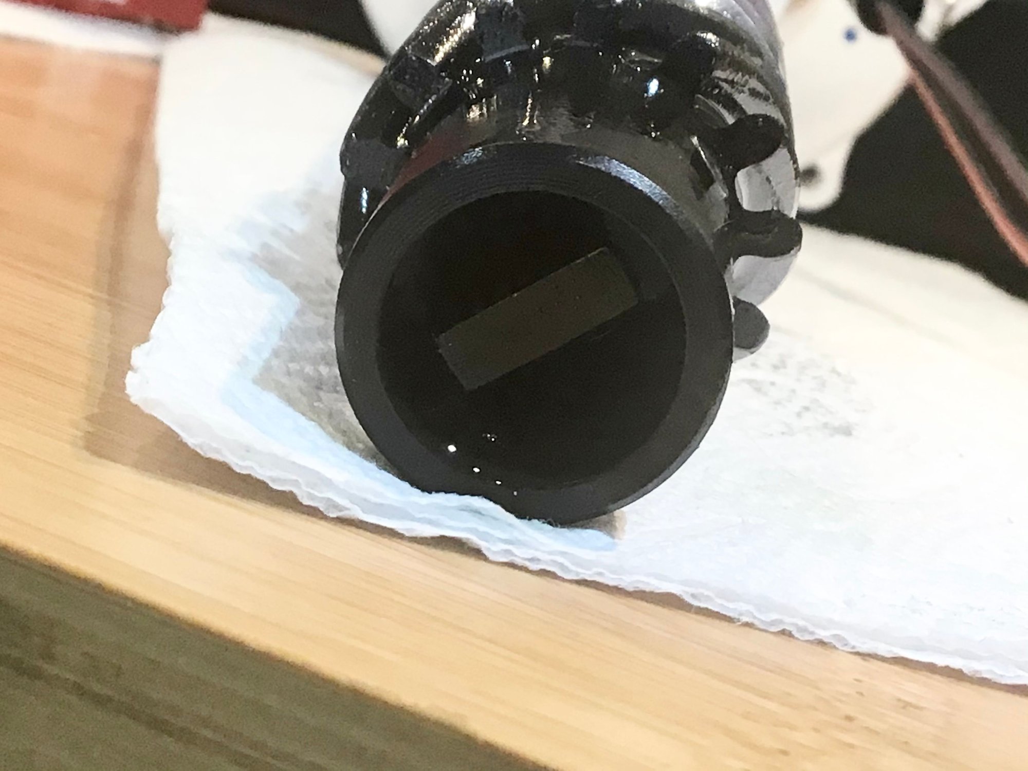

Originally Posted by Jebbysan
If not, sometimes replacement gears have no “leader” or chamfer to receive this. The shaft will sit slightly cockeyed in the hole and no way will it take the shaft.
The way to solve this is to remove the gear and chamfer.
I have seen this quite a few times, especially on MSD stuff, so it is worth checking.
I checked the gear and there is no bevel on the shaft. See pic. So I have to remove the gear to bevel both sides?

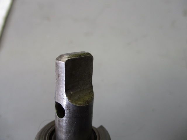

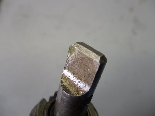

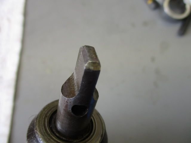

That's your problem. Very common issue on aftermarket distributors and replacement shafts, especially the Chinese-made stuff. The end of the shaft needs to be modified to look like this:
Without the bevels shown, it is almost impossible to get the distributor dropped in to engage with the oil pump drive shaft.
Lars

Okay, I will remove the gear and bevel the shaft.
Thanks Lars, Jebbysan and everyone so far!
