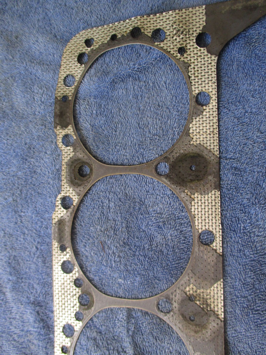

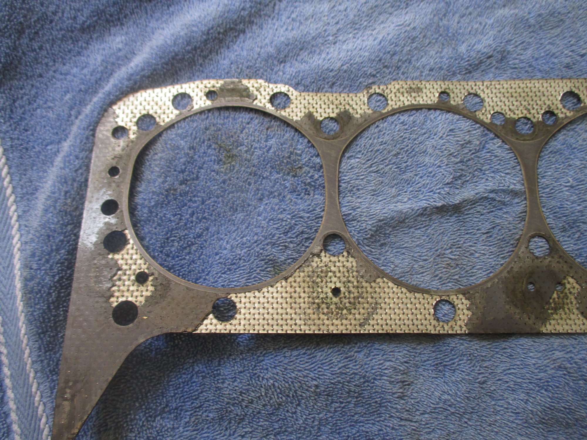

Need some advice. I replaced my head gaskets (small block 350, GM good wrench crate motor, do not know how old or how many miles) with FelPro composite gaskets (the blue ones). Reassembled motor, adjusted valves and started it up. Fired right up, adjusted timing and carb. Idled fine and sounded fine. Let run for about 5 minutes, temp was normal, checked exhaust and water was dripping out both sides ( making pretty good puddle). Did compression check All about 135-140 except #3 and #5, they had about 107 and 115. Re adjusted valves, no change. Came back a few days later. Leak down test. Would not hold any pressure. Tried compression test again, no compression. took off rockers and redid leak down test, would not hold any air. did same for other cylinders, same results. Reassembled rockers, adjusted valves again (#1 at TDC compression, IEOC, went through firing order doing the same. No compression, no air holding on leak down test. Said screw it, took off passenger side head, this is what I found. Any comments, ideas or observations would be greatly appreciated. Thank you.

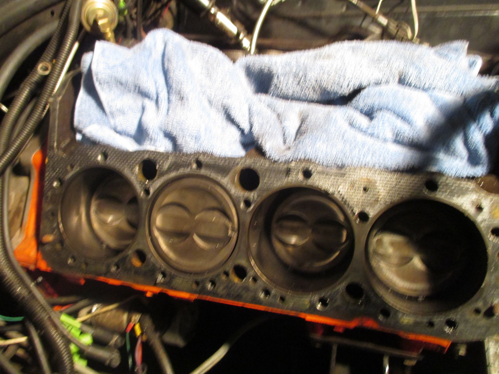

Not clear on a couple things. like why did you feel the need to change head gaskets in the first place? And although I can see lots of missing gasket, I can't see how much is still stuck to the head and block. How flat is the block? How flat is the Head? New Head bolts? Torque spec and method? And maybe just a badly made gasket.

1. Are you loosing coolant?
2. Was there excessive air in the radiator?
3. Seems to be a pattern on the gasket showing blow-out. And that's the middle cylinders. Like you stated #3 & #5 + #4 & #6
Tell us about your bolt torqueing sequence:
Did you follow the std method order for GM?
Did you torque the bolts in 3 - 5 steps?
And in increments of how many lbs per step?
To me, that looks like a cheap gasket that never crushed.

I was getting white smoke and some water out exhaust. losing coolant, not a great amount but consistent. Not leaking into oil. Bought engine used about 10 years ago. Compression test before tear down was same. #3 and #5 were lower than others. Decided to change all gaskets. When removed old head gaskets, they were intact. Came off whole, not in pieces. Blue composite was still in good shape. Replaced with exact same gasket, FelPro. Placed right side up. Torqued head bolts (reused stock GM bolts, thoroughly cleaned) to 65lbs in 4 sequences. 35,50,65,65. Followed recommended sequence. These new gaskets only had 5-10 minutes of run time at idle. Just did fluid leakage test in head chambers. All held except #3 (leaked all fluid out intake valve) and #5 (about 1/5 of chamber was exposed, also out intake), which is consistent with compression test.

I have been driving it for the last 10 years. Started to blow white smoke and water out exhaust recently, thus the tear down. The head gaskets that came off that were on there for the last ten years were in good shape. The ones that I replaced them with were brand new .Felpro perma torque, the exact same ones that were on there. They did not last ten minutes. I cleaned all surfaces and ran straight edge over surfaces, all good. Just do not know where I went wrong. Just hate to do it all over and get same results. Will take off valves and check them and seats. I do need to address the intake valve leaks before trying again. I am hoping that the gaskets were just bad, but will never really know.

One further note, upon cleaning the block, it was like scraping off heavy flaking silver paint. These were the blue perma torque gaskets.
I have never seen that before after 10 minutes.....hell, I haven’t seen that but maybe twice in my life and both cars were run to hell and back.
It would have to get really hot to do that.....no other explanation....if everything was clean, no way would it stick to anything under normal conditions.
Jebby

Only thing I can think is that you got a bad pair of gaskets or a fake pair (yes, it exists).....
If this is a Goodwrench 350, go with a .015 steel shim gasket sprayed liberally with Copper Spray....
Also....use oil on the head bolt flange when you torque.....I like liquid PTFE on the threads myself.

here is a picture of the block. I thought I saw a post about small hole in gasket. Can't seem to find it now.
