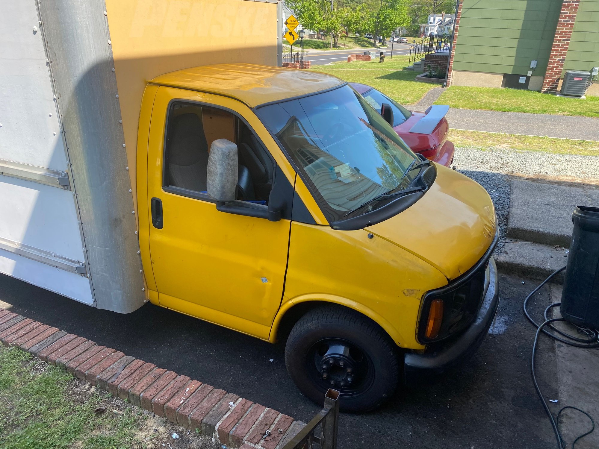

ordering a power steering line for my 2001 GMC box truck. then I realize my steering lines detour through the master cylinder. would an OE setup like this work in a C3? smaller than vac booster and won't care what you have for a cam... i will post up pics in a few.

i have all the parts, but they are busy right now... my move to florida truck. Wondering if a 75 will fit in a 14’5” box with both bumpers removed.
