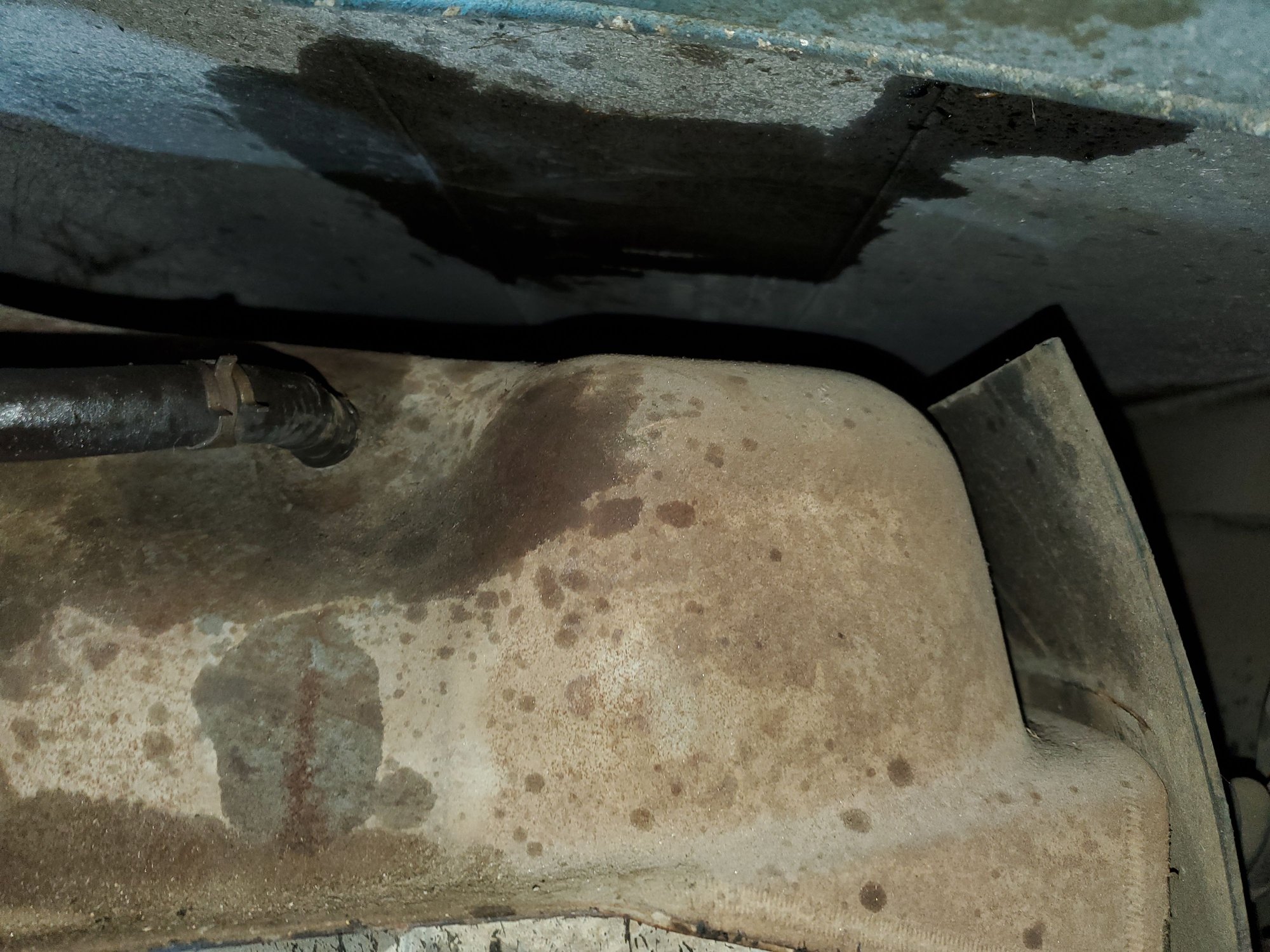

Just pulled into garage from a weekly spin and thought I smelled something. Went back out there a few minutes later and saw a big puddle of gas that was getting bigger, right behind left front tire. I grabbed a flashlight but couldn't see where it was originating from above looking down on engine. It stopped after a few minutes. The drip was hitting the ground behind and slightly inboard from left front tire, roughly same place where you see AC condensation hitting ground behind right front tire. I'll jack it up manana and look from there. Anybody got a hint/been down this road before?

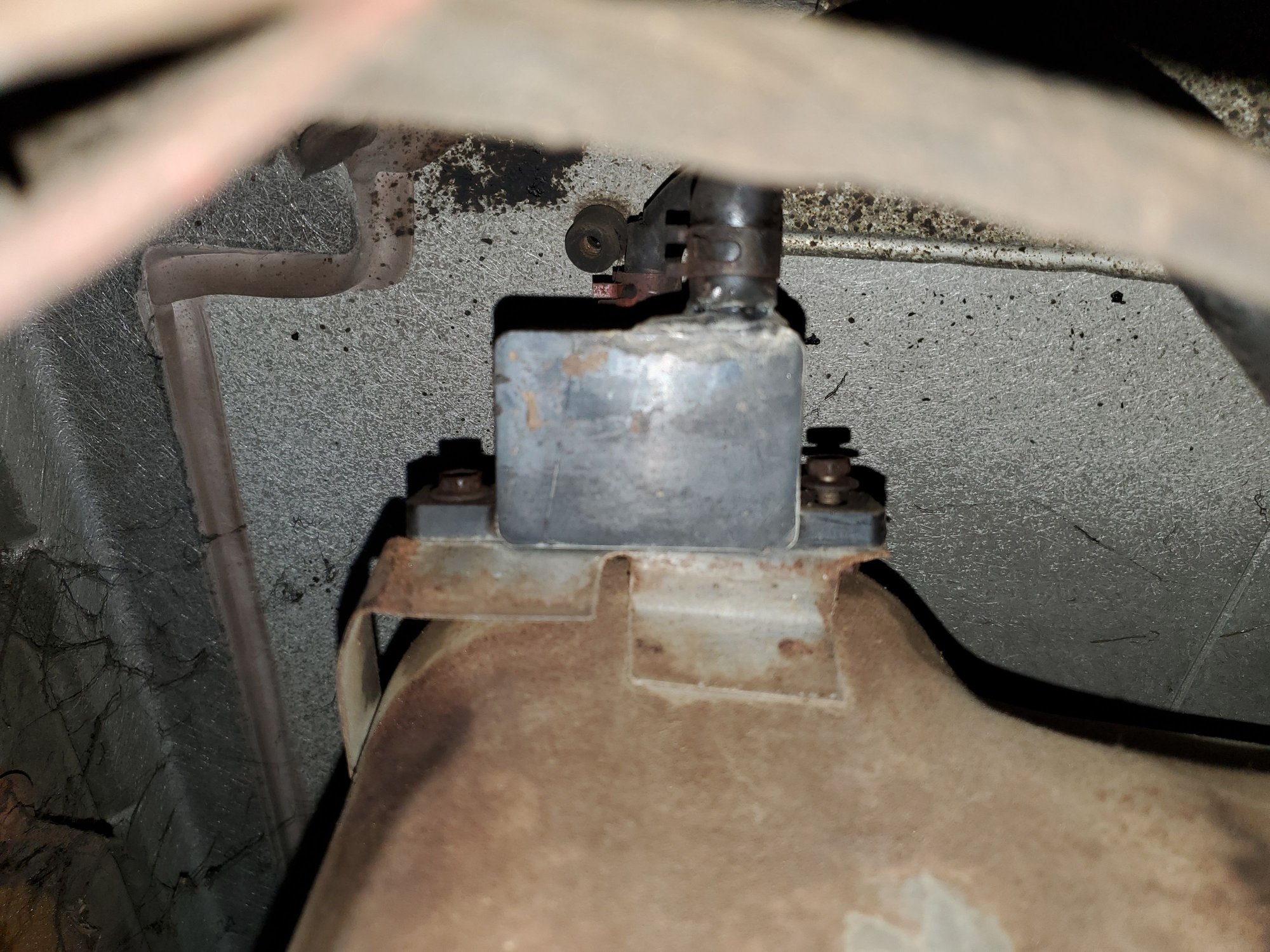

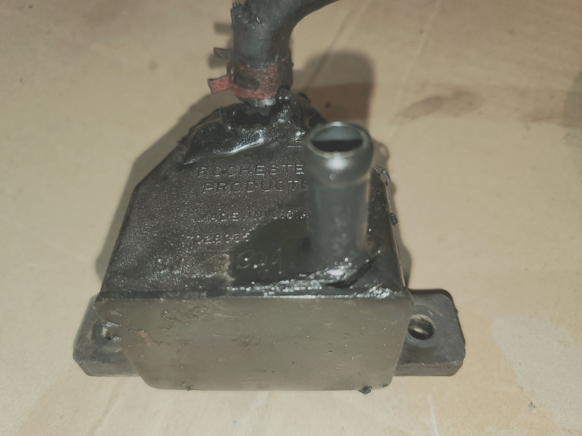

Lots of threads about this. Only way fuel can be on the left (drivers side) is if your charcoal canister is leaking fuel, usually that happens because you have a bad fuel separator on your tank. Your canister should only be receiving fuel vapor if your fuel separator is working properly.
I also have a 73 L48, I just removed my separator because I don't trust reproductions and read the threads people listed above. Turns out mine was also broken. I plugged the nipple on the tank with 3/8" ID hose and a bolt. I didn't have a charcoal cannister so eliminating the separator wasn't a difficult decision for me
You can check on it by taking a video by sticking your hand between the muffler and body, while you lay on your back. You can also remove it and the hoses the same way if you are patient. Helps if your exhaust isn't welded completely like mine

Not sure how many gallons it takes, but the fuel separator is pretty high up there. Sloshing of fuel around when you drive can force fuel down towards the charcoal canister if separator is bad, even if the level of gas is nominally below the separator. I'm guessing your current fuel level is below the separator, and because you aren't driving it isn't sloshing around.
Looking up at separator
3/8" hose that goes from tank to separator. Also mounted high up in tank.
