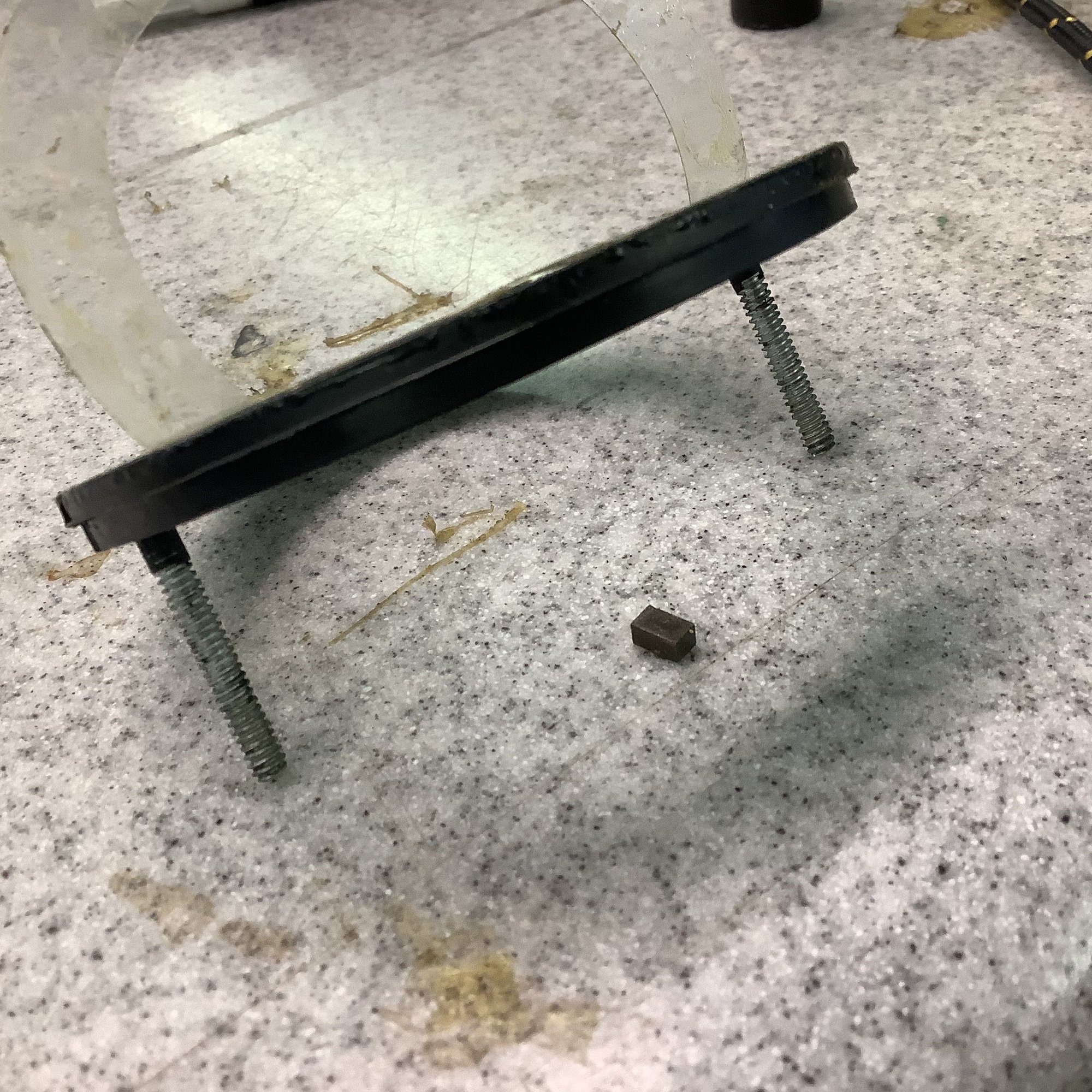

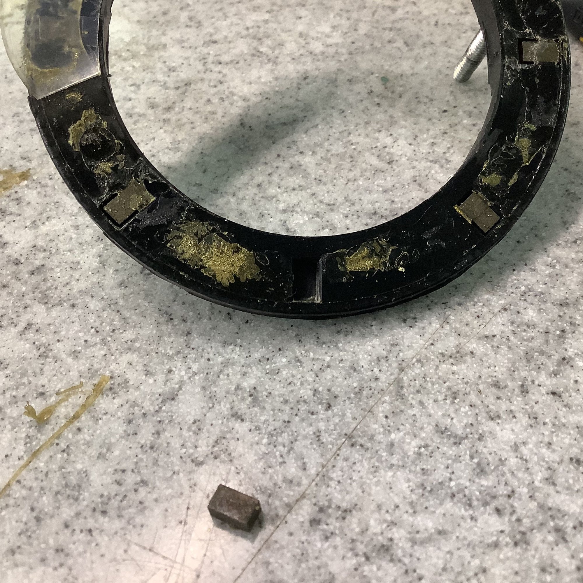

Originally Posted by JBrooke825
Looks like I found it. That little magnet was stuck on the inside of the shielding
Glad you found the problem. I had a Pertronix II fail on me year ago. I swapped the points back in on the side of the road and kept rolling.

Did what you said and got a petronics 3. Fixed the problem.
back on the road. Thanks again.
