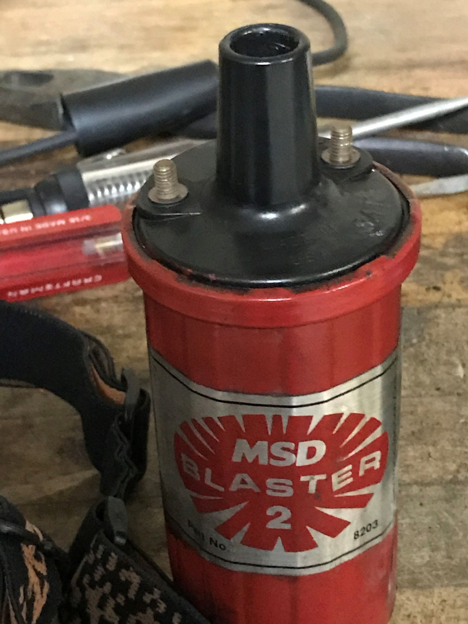

I noticed the ignition coil was seeping boiling oil and a small hairline crack on the top of it, so I figured it was just the ignition coil..... swapped the ignition coil, and still it will not start.... I'm still thinking ignition, but I don't know what.
It has an MSD Blaster 2 ignition.

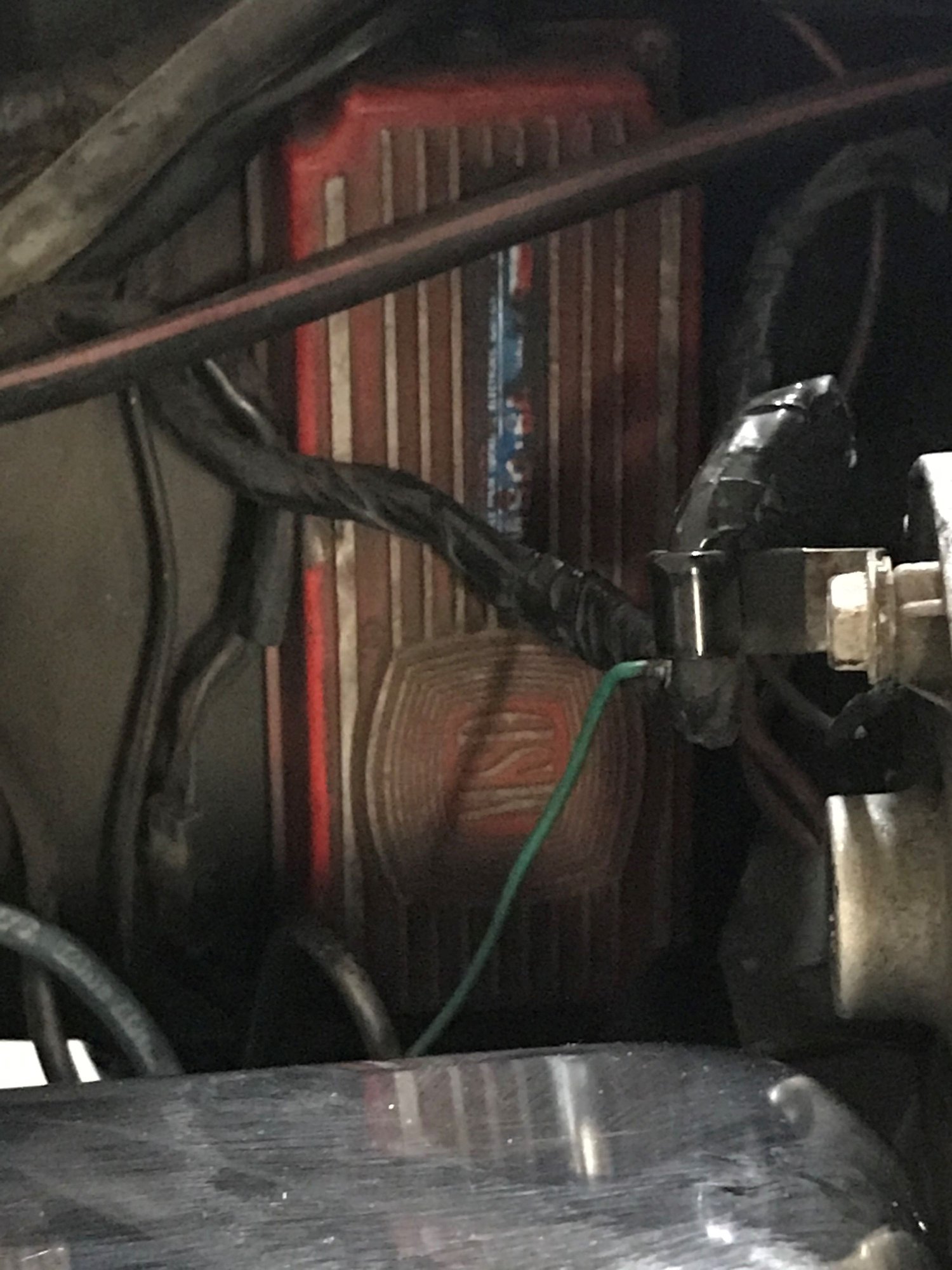

I have an electronic MSD ignition. The MSD box is under the front driver side wheel well. The ignition coil was an MSD Blaster 2. I believe the coil went bad because it was seeping boiling hot oil from a hairline crack on the top of it. I replaced the coil.
I still have no ignition. I don't seem to have power (voltage) to the positive side of the coil... I assume there should be.
I have no idea what else could have gone bad at the same time as the coil that it still has no ignition after replacing the coil.

That box on the fender looks like a CD unit (not known for durability). It supplies a 450-500 volt pulse to the coil at the time of ignition/spark. That's the only time voltage is present at the coil.
SO I think you are saying that the MSD control box went bad? Does it need to be replaced entirely or is there a fuse or something that needs to be replaced?

The main point of my comment was that with a CD system you do not see 12v at the coil. Ever. CD systems work differently than inductive systems. My minor point was that those CD boxes do not typically have the same reliability and durability as inductive control modules.
