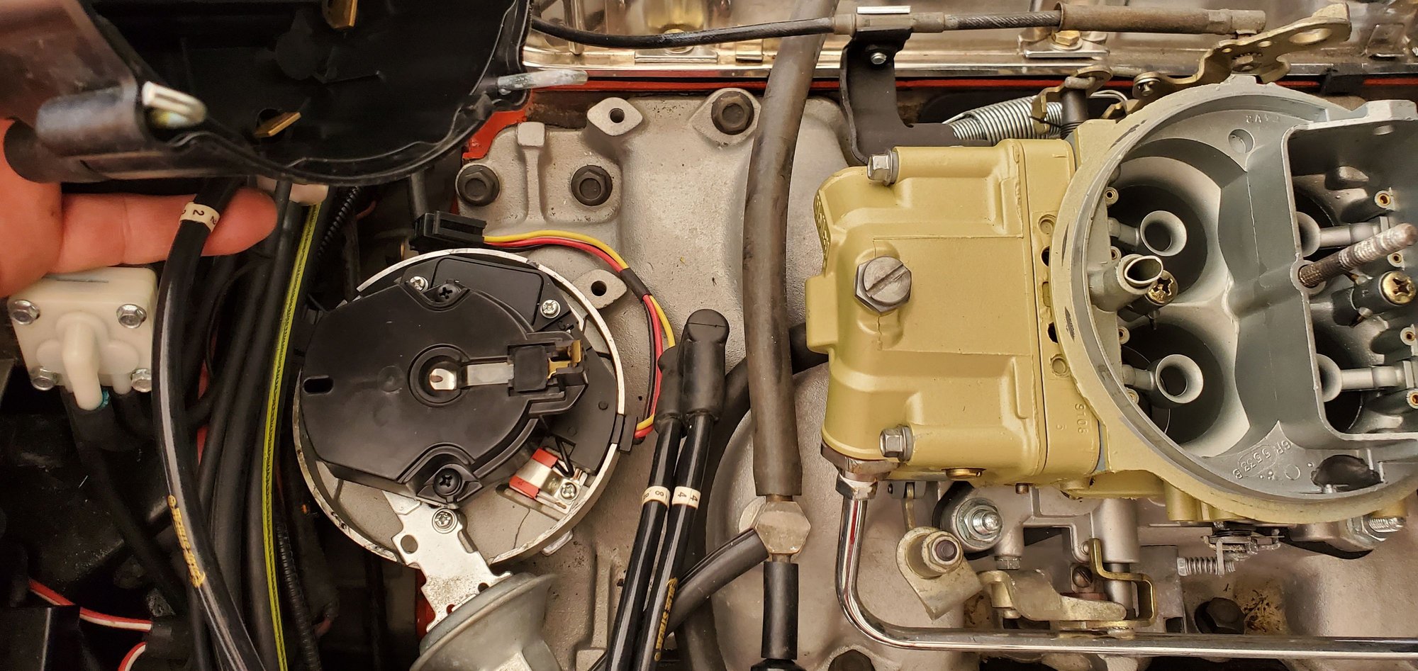

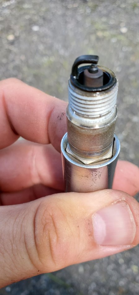

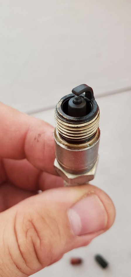

here are some of my findings so far..
1- with the car idling if I apply vacuum to the advance nothing happens.
2- with the #1 cylinder at compression stroke and TDC confirmed the rotor seems to point to the front of the engine and not # 1 cylinder.
3- aftermarket balancer does not read 0° but closer to 50°before TDC.
Herr are some pics of the #1 and 2 plugs and the rotor direction on compression stroke.
Also when I had the car idling and applied a vacuum tester to the advance I did not notice a change in rpm's but the advance does work..

"here are some of my findings so far..
Also when I had the car idling and applied a vacuum tester to the advance I did not notice a change in rpm's but the advance does work.."
Your last sentence states the advance does work but at the same time you say applying vacuum to the vacuum advance diaphragm does nothing, how is that possible?
You dont see the timing mark move when you apply vacuum to the diaphragm while the engine is running?
If so, how can it be working?
You state the rotor at TDC points to the front of the engine. If it points to the drivers side front cylinder in the cap, that is supposed to be #1 cylinder on an HEI distributor. What plug does that post connect to?
How are you determining the engine is on TDC #1 cylinder on compression stroke?

Ok so if I apply a hand pump to the vacuum advance cannister it does pull in and move the distributor advance, what I was trying to say is that if I do the same test while the engine running I don't hear a change in the engine.
The rotor seems to be pointing toward the water pump and not the #1 cylinder. Could the distributor be off a tooth ?.

Judging from the photos.....you have way too much advance......this needs to be sorted before you can do anything. Timing HAS to be done first.....verify it and lock it in with the 36 degrees at or around 3000 RPM. This is important. Then record the number at "idle".........this is with the vacuum can unplugged. Try plugging the vacuum can in again and verify change or no change.......
That carb is sketchy......Lars is correct in saying that you are not on the idle circuit at all. I would borrow or purchase another Holley......anything but the Street Avenger. A 750 HP would work nicely here.....
