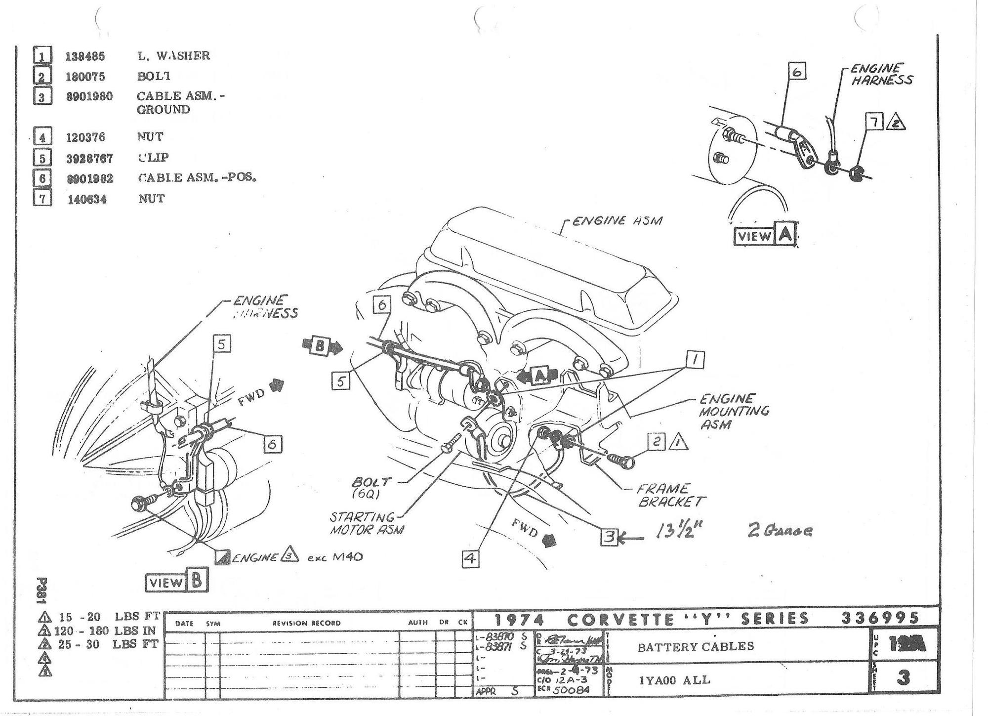

Originally Posted by Samuel’s 74
it might just be me not knowing what I was looking at. I’m going to get under it Saturday and replace my positive cable, starter ground, and engine block to frame ground(I think) cable.
Look at #3 on the left top of the page, now look at the picture and find #3.

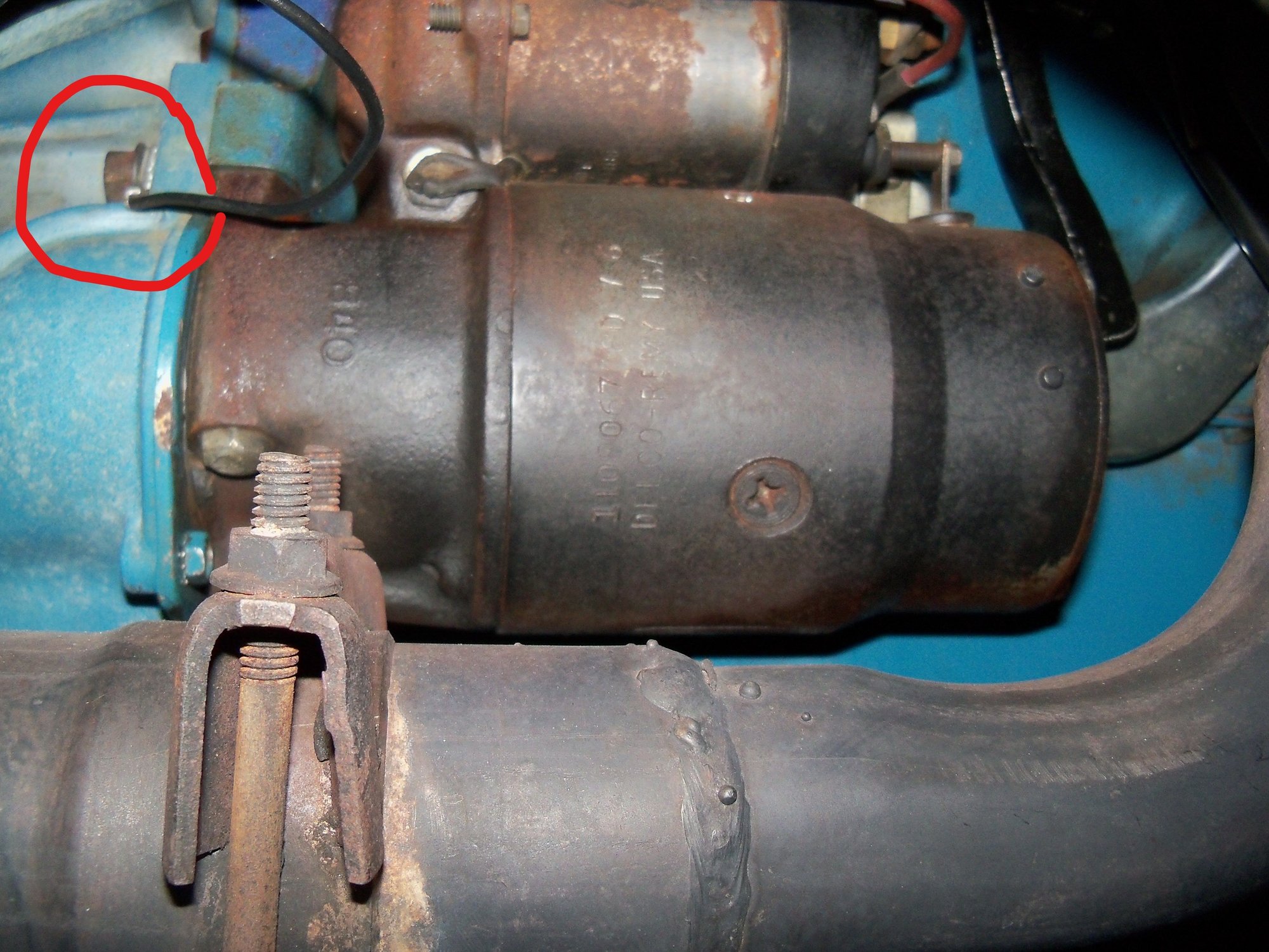

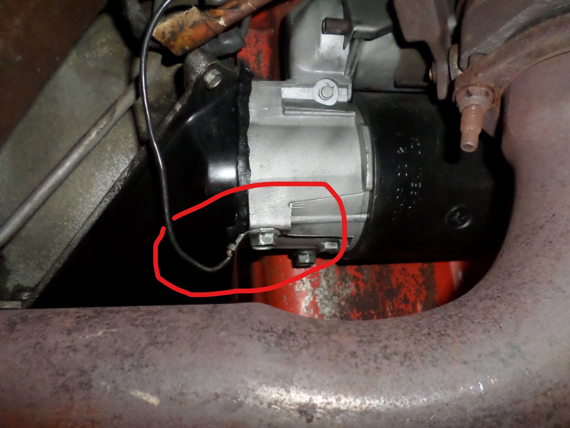

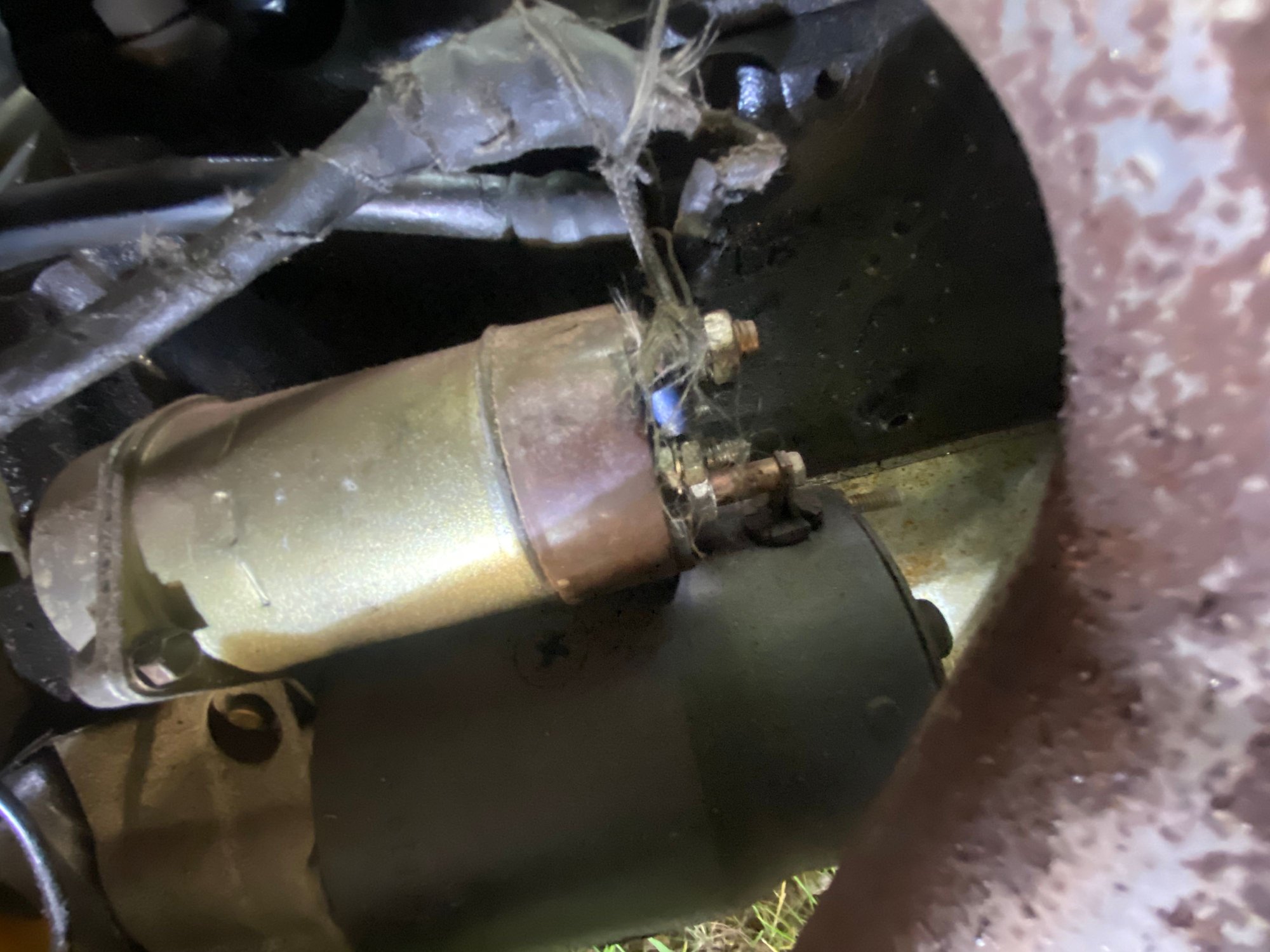

Originally Posted by PJO
Seen the ground wire ether way.
In these two pictures, the small BLACK wire is connected to a starter or bell housing bolt, both ways work just fine.
That BLACK wire it the ground for your heater blower motor and wiper motor so it's needed.

Originally Posted by Peterbuilt
Look at the bottom right side of the picture, the cable is 13&1/2" long and 2/0.
About the neg cable.

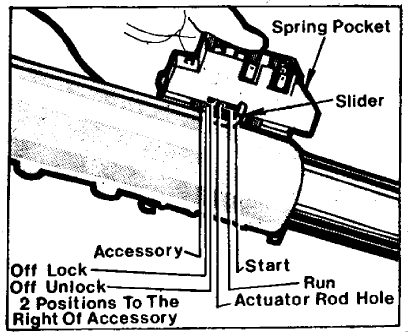

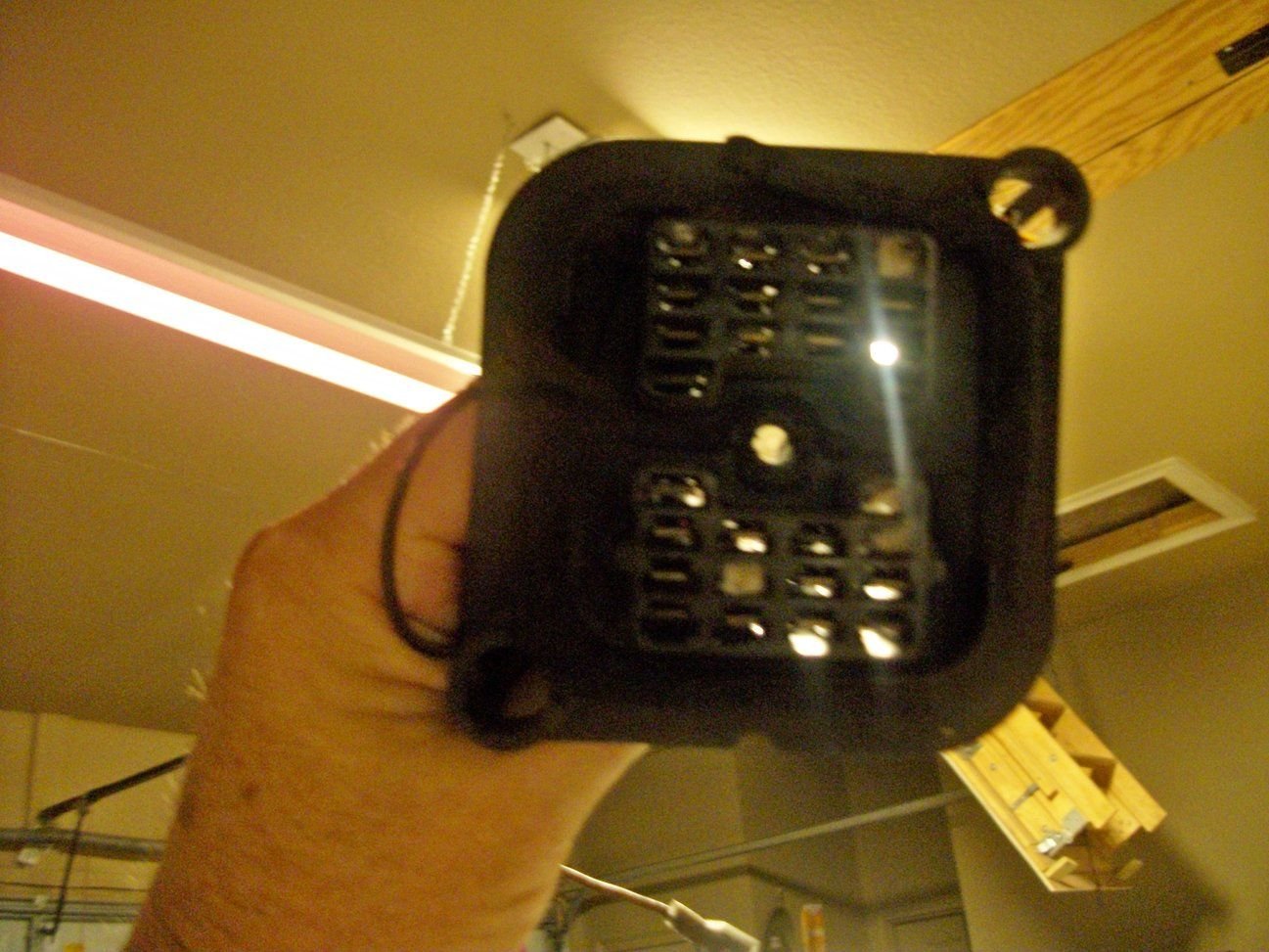

My gut is telling me as someone else suggested. With your intermittent power no power see if you are have a problem at the distribution block under the master cylinder. There is a bolt that keeps the 2 blocks connected the inside and outside blocks. I would investigate this.
Also your horn relay
Your ignition switch for proper alignment with the rod from the key cylinder.
Also 1974s and early '75 Corvettes had a seatbelt/by-pass/interlock module relay up on the passenger side firewall above the heater core cover and has an orange plastic base with a silver cadmium relay cover with a black rubber/plastic by-pass button. You can jumper the green and purple wire on the relay and bypass it.

The ignition switch is about half way down on the steering column.

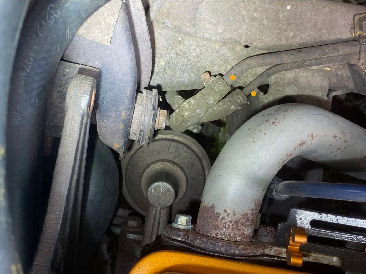

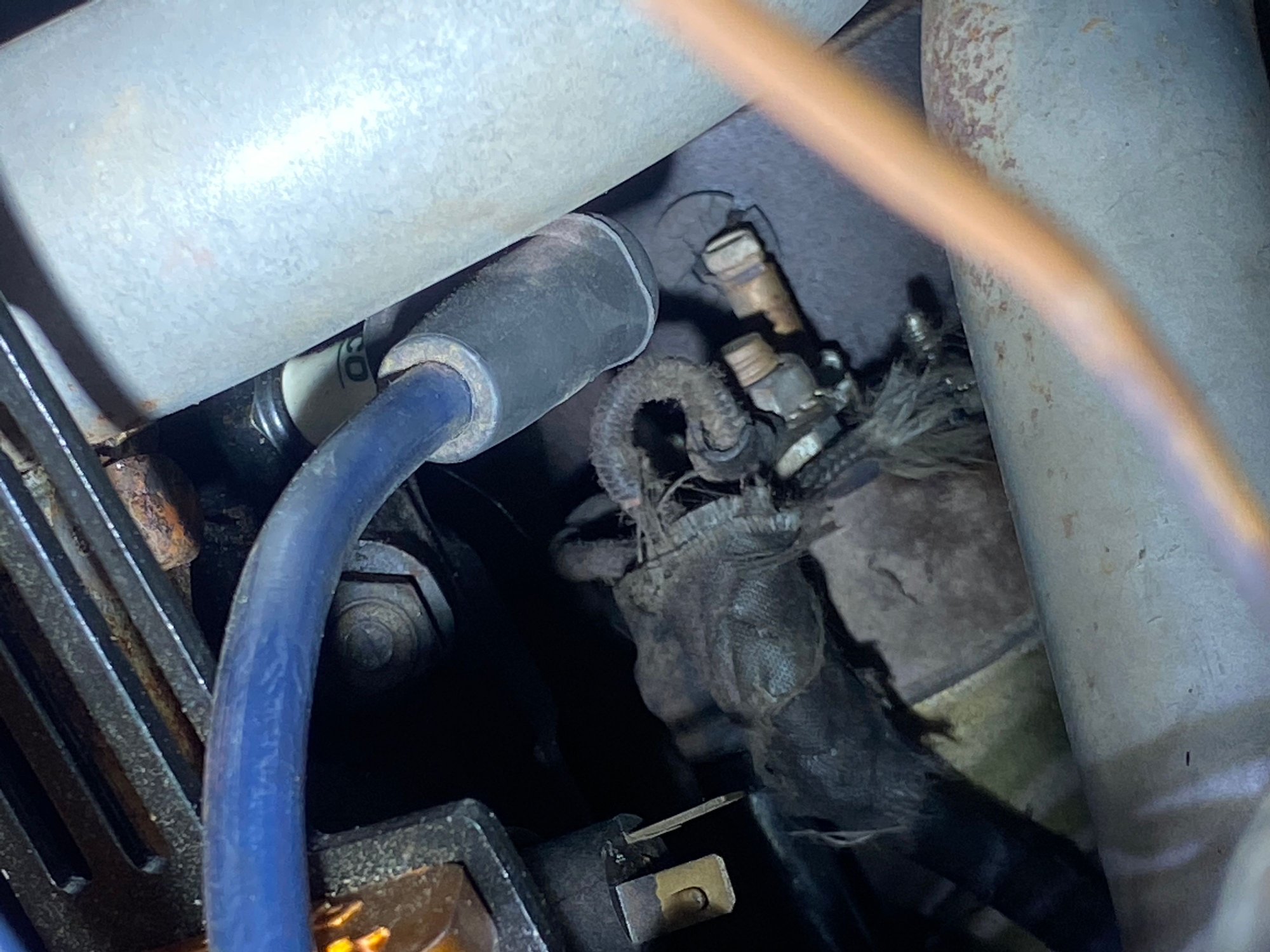

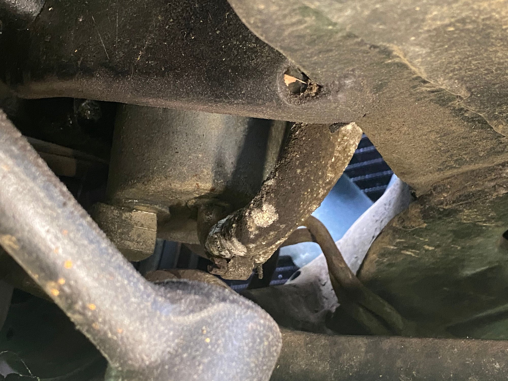

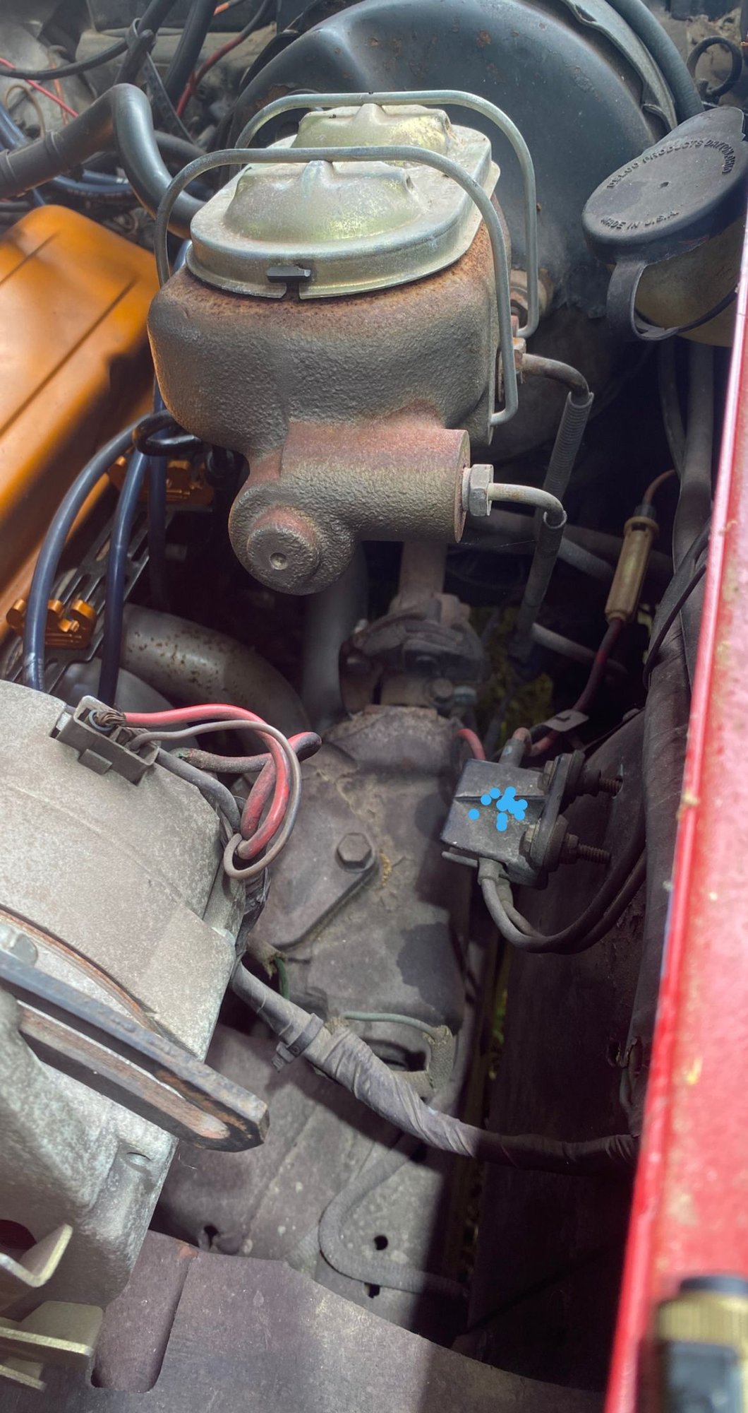

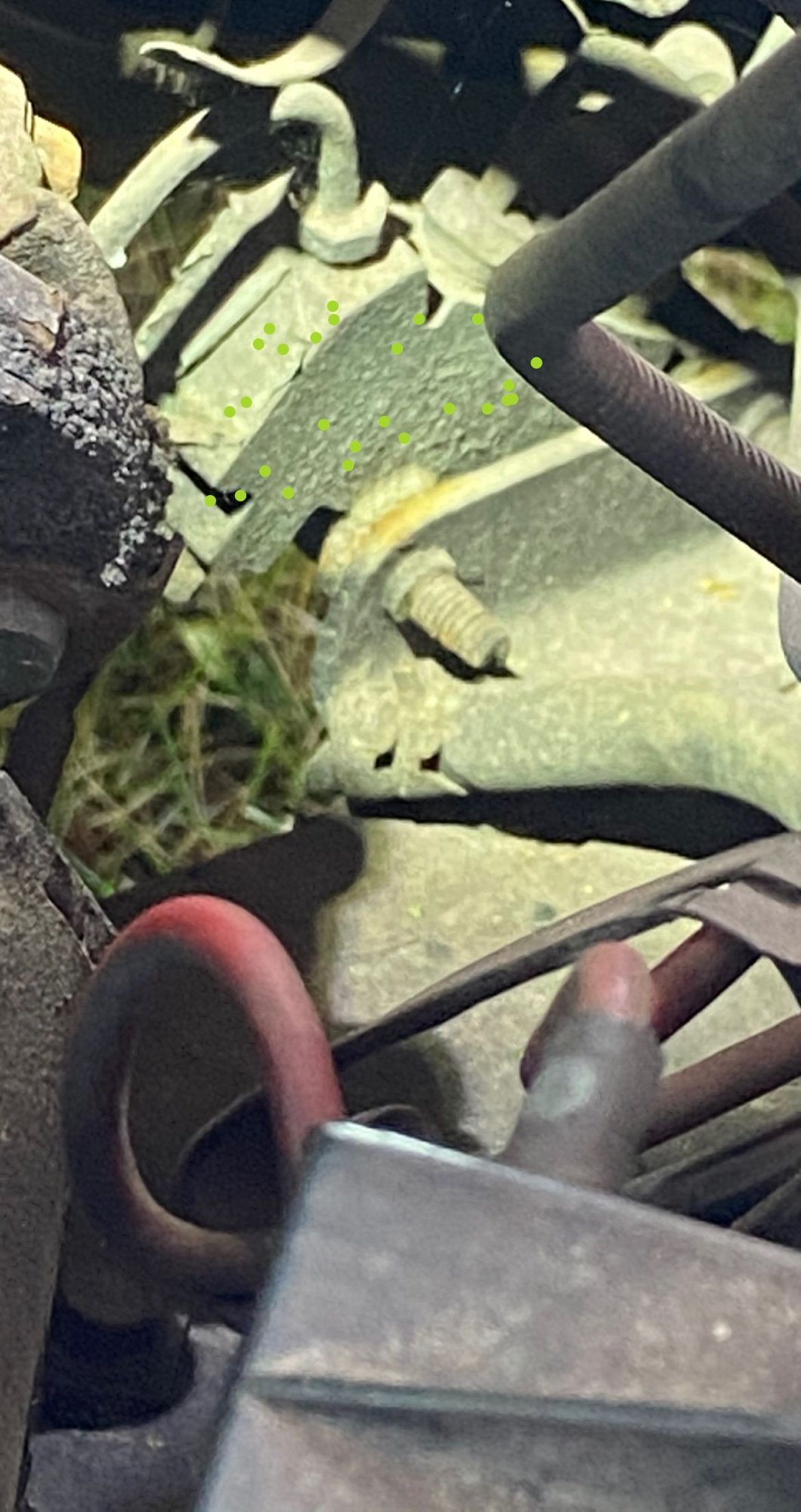

I’m back!! Finally!
so I didn’t see any specific block looking thing under my master cylinder, But there is a cluster/connection of wires mounted to my left interior
wheel well(picture marked with blue)
edit, I found a blockish looking thing, but it’s way down there on the frame - (marked with green)

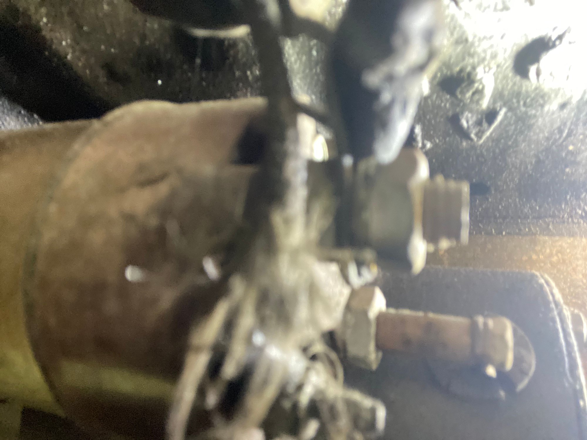

I did get some pictures of my starter wires.. but they’re terrible and a cable is in the way.
now that I’m vaguely more familiar with this, I found the small black ground wire. I found the positive cable cable.
i didn’t specifically see the Bigger grounding wire, but there are two wires that are in a protective sleeve together - that come up to my firewall and lead to behind the distributor.
I don’t know what these hoses are for but they look absolutely terrible and I’d like to replace while I’m down here. (I posted a pic of the top of this is connected too)
The hoses from the top picture come from the bottom of the circle thing in the center, then they connect to the metal pipes(orange dots) that are mounted to my right wheel wall area.
The unit itself is mounted to my front right engine block, just under my headers.

Samuel,
Thanks for posting the pics. It looks as if there's a lot going on with your car that may be difficult to adequately or easily explain and answer via Forum Q's and A's. Do you know anyone who is familiar with working on old cars that could help you out in person? My particular concern is the hoses you mention - they carry gasoline from the fuel tank to the fuel pump (the round object you mention) and a hose failure or even a bad leak could be ultimately catastrophic.
I'm getting the sense you're a rookie at this sort of thing, and that's perfectly OK; everyone was at one time. I applaud you for your willingness to dive in and learn on your own. I believe you could benefit greatly from an additional set of hands that has done this sort of thing before.
Larry
