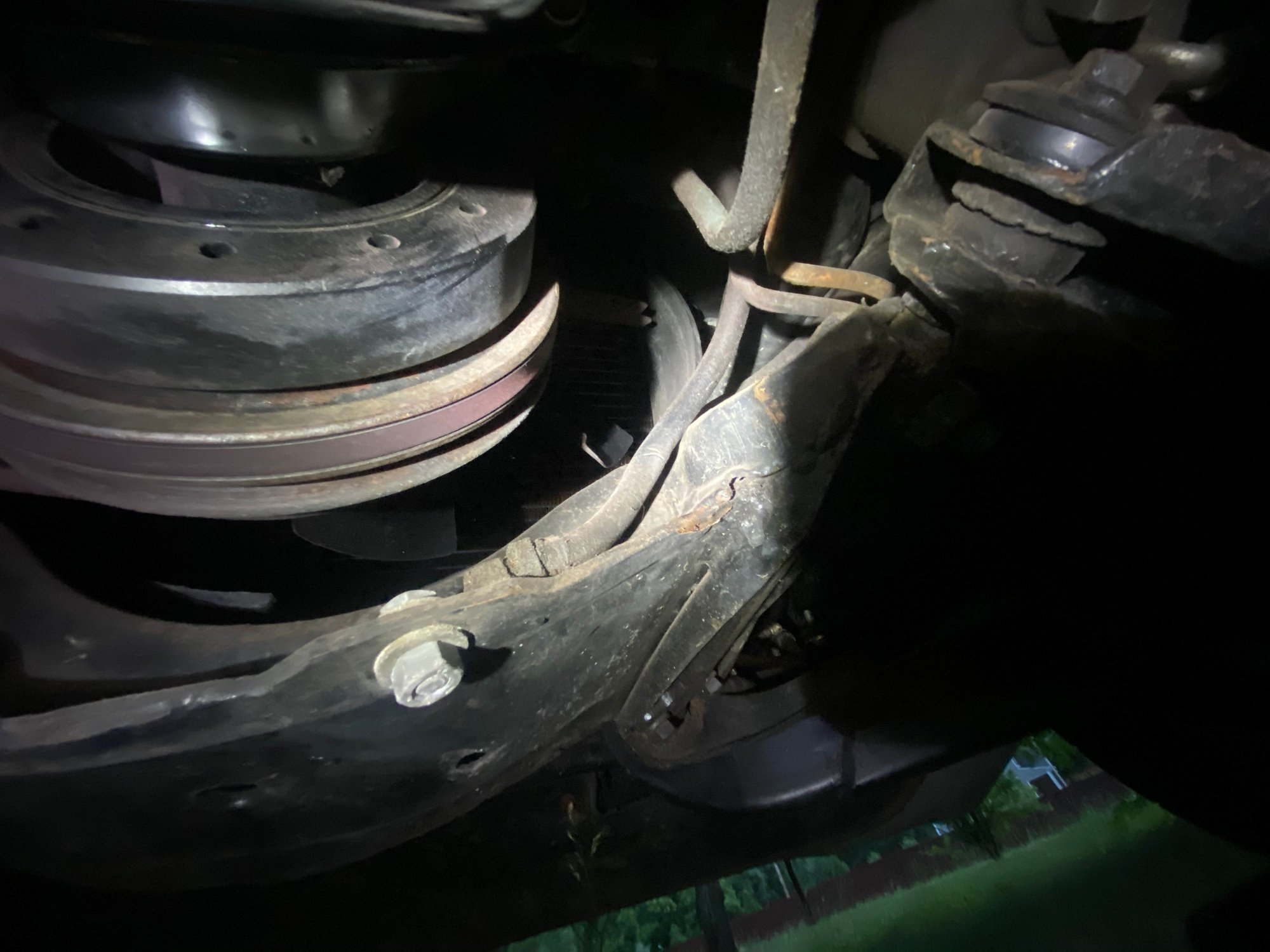

Default Ground wire?!
I think I just found the ground wire maybe. I’m obviously going to put the new one in

Joined: May 2002
Posts: 2,476
Likes: 756
From: Laporte, IN
That install is not the original placement of the ground wire. Someone moved it from the starter front support and engine mount frame bracket. Those bolt and nut maybe the original on the frame but missing the star washer. It also appears they may have used the fuel pump push rod access bolt. Used to hold the push rod when changing the fuel pump.
