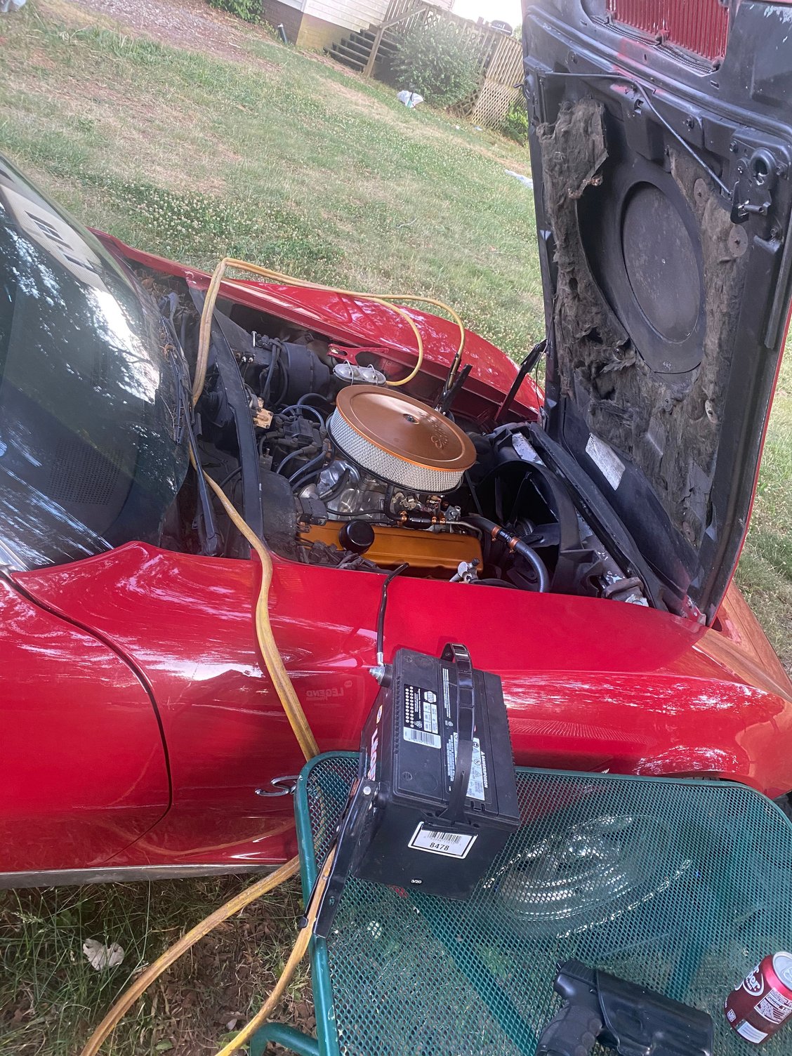

I have it bypassed, and my floor light came on. But I’m honestly scared to start it.
edit, turned my key to accessories and I have my dash lights/headlights, brake lights, and the buzzer went off when I opened my door - key in ignition.
And yes, if it starts then someone will have to hold and walk the battery while I drive. Or I’ll just reset it up tomorrow with a longer cable.

From: SW Florida.
So, using jumper cables for the negative? Start it goddamnit. Ya know it didn’t even occur to me to shorten the pos cable by moving the battery. What if, you set the battery on top of the air filter. And then use a regular ground wire from the battery to the block.

it ******* started
