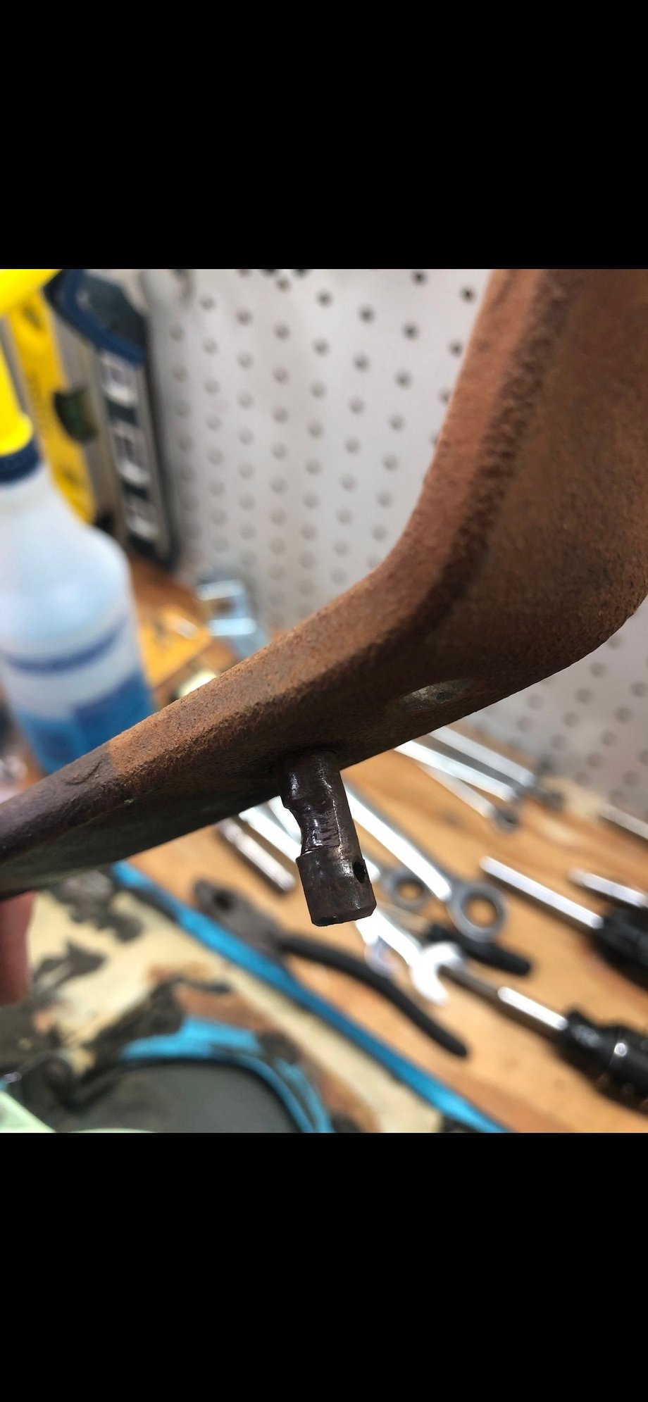

If I remember correctly and if I am understanding what you are describing, that pin is part of the pedal and yours has broken off. You need a new clutch pedal.

Well that explains why I would not be able to put another pin in the push rod to the clutch pedal. It came factory welded on to the clutch pedal? Are there any alternatives to fixing this rather than putting on a whole new clutch pedal? It seems like a lot just for it to connect to the push rod.
Yes
No. You can repair the old clutch pedal by machining out the old pin and fabricating a new one to weld in, but that will still require removal of the clutch pedal, so you may as well pony up the $80 for a new clutch pedal assembly.

Originally Posted by Akroland
Over 53 years they tend to wear. I just replaced mine.
Mine looked like that but the spot welds holding the pin in place had broken also. I replaced the pin.
Yep! That's what mine looks like but it ended up snapping off and ending up on the floor. Any tips on replacing the clutch pedal? I was in there last night and it's hard to see where it connects because the clutch pedal goes high up behind the dash.
