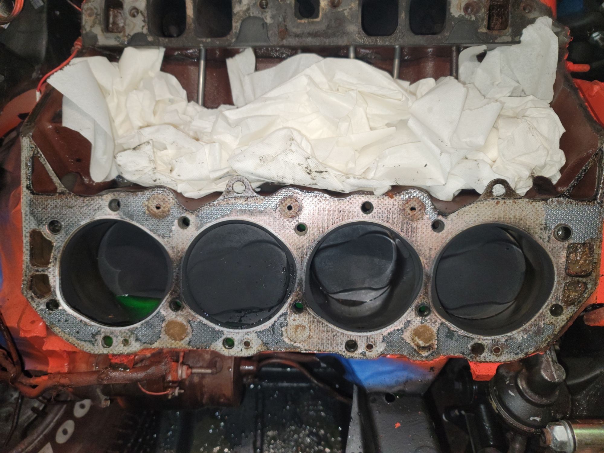

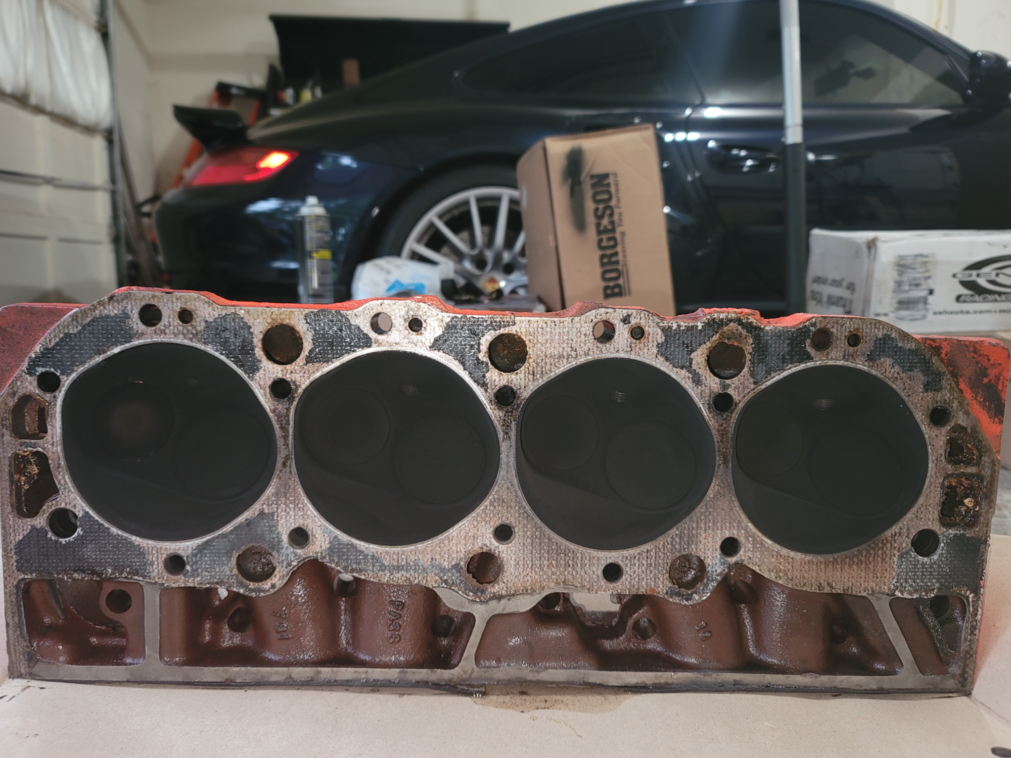

Pan and pass side head is off -- gotta say, everything looks pretty good

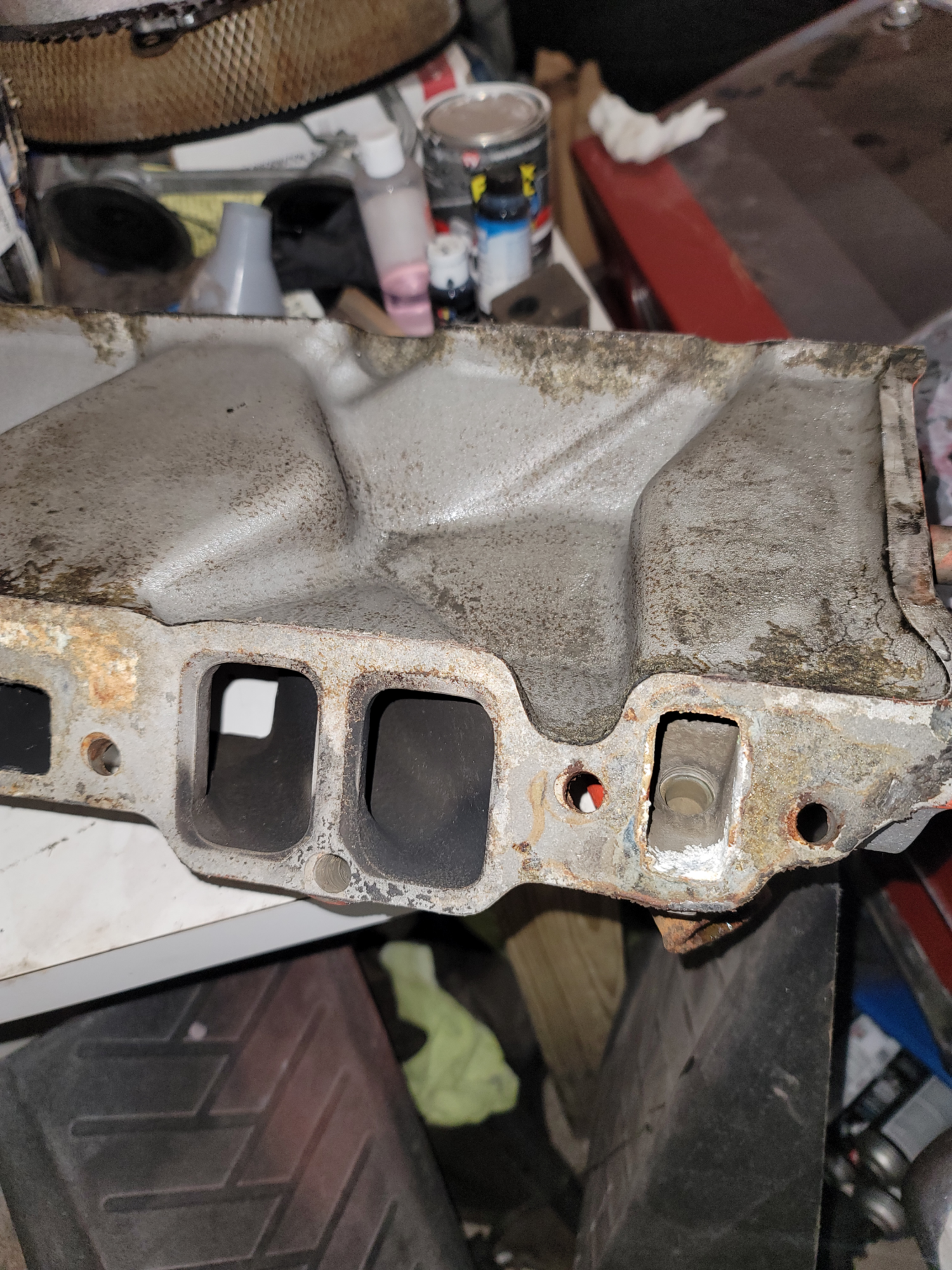

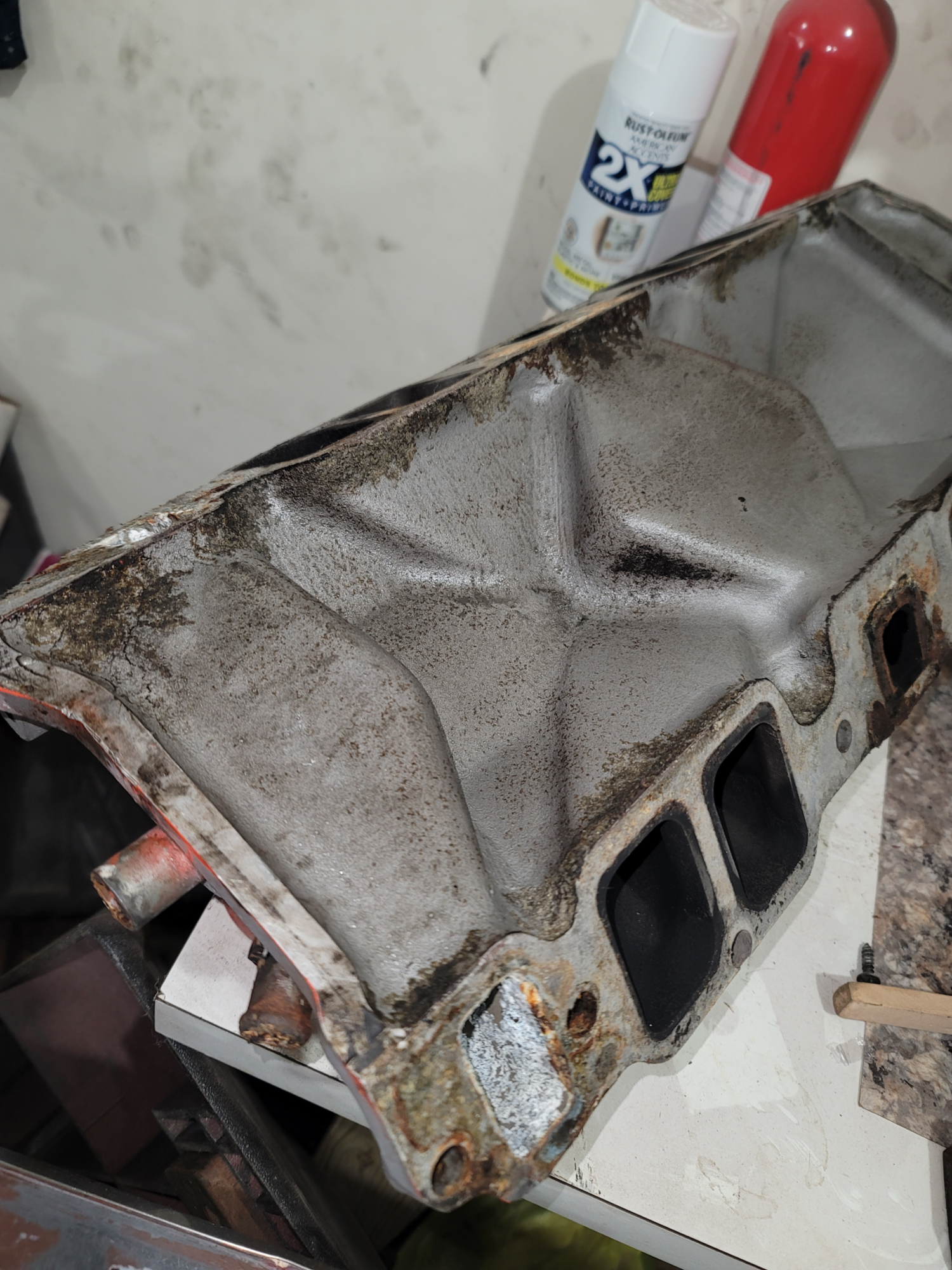

is that flange rotted through right below the water passage on the left front of the manifold? if so, there is your water. 781 heads. 396. can you see piston domes through plug hole? this may be a seriously low compression engine with those big *** chambers on the smallest BBC. with 25cc dome, .041 gasket and .020 deck clearance i get 8.5:1.
Intake manifold chamber pics :
I'm assuming your question was regarding the 2nd picture?

this pic. bottom left looks like a hole next to the water passage. later pic above looks like it is a dirty spot. massive water in the oil pan is always a failed intake gasket. or a hole in something. head gaskets usually blow coolant out the exhaust. this is a 2 bolt cast crank engine. so a 325 hp 396. those heads cost 2 points of compression.
I believe you're right on the engine/HP numbers. I remember looking it up when I got the car.
I'll clean up the intake a bit later, but I don't remember seeing any glaring holes or issues.

Throw that intake in the trash or hang it on your wall....I would not bolt that back on an engine. Look at the water passages and the corrosion....plus it is the wrong port anyway and those didn’t flow worth a damn....look at the dog legs in the runners to clear the intake bolts....terrible.
Stick a Torker 2-0 on it....plenty for a 396....and it will clear the hood....
Use the 1210 intake gasket that blocks the heat riser as I mentioned above.....oval port intake will use oval port gaskets....as designed.
Use a bead of silicone on the front and back rails....Google up some videos, plenty of them.
A Mr. Gasket 1131g is .020 thick and will boost compression a bit....you are kinda weak in this area at just over 8:1 or so.....spray it on both sides with Hi-Tack Permatex....these will work fine with Cast Iron heads....

100 buck torker 2 in north wales PA. he doesn't know what it is, but the number on underside says irt is a torker 2. only oval single plane that fits under a vette hood. he has a set of heads these are port matched to. doesn't say what. https://philadelphia.craigslist.org/...313527980.html Gen 6 L29 heads are cheap and easy to find. 100cc chambers. they are a little restrictive, but good for everything but full throttle above 6000 rpm. would have to do adjustable rocker studs. they make em for those 3/8ths threads. rt 57 salvage in port murray has some for 125 bucks each. here is a pair of 702's down in s. jersey by me. https://southjersey.craigslist.org/p...321920757.html

and the intake or gasket is the reason the engine filled with water. that intake looks like it was run on a boat in salt.

Installed the pass side head back today. Everything was good. Bolt 16, the last bolt... Stripped threads. Held to 60 ft lbs tq. Went to the last step of 75-80 ft lbs and it gave. So I had to uninstall the head and ordered a helicoil. Wasted a whole day haha but I guess that's how it goes. Hopefully I dont have any issues with the driver side tomorrow.

maybe get a 7/16ths-14 tap and clean up the threads on the rest.

I would recommend a proper thread chaser instead of a tap. A tap might remove more material than you would like. YMMV
