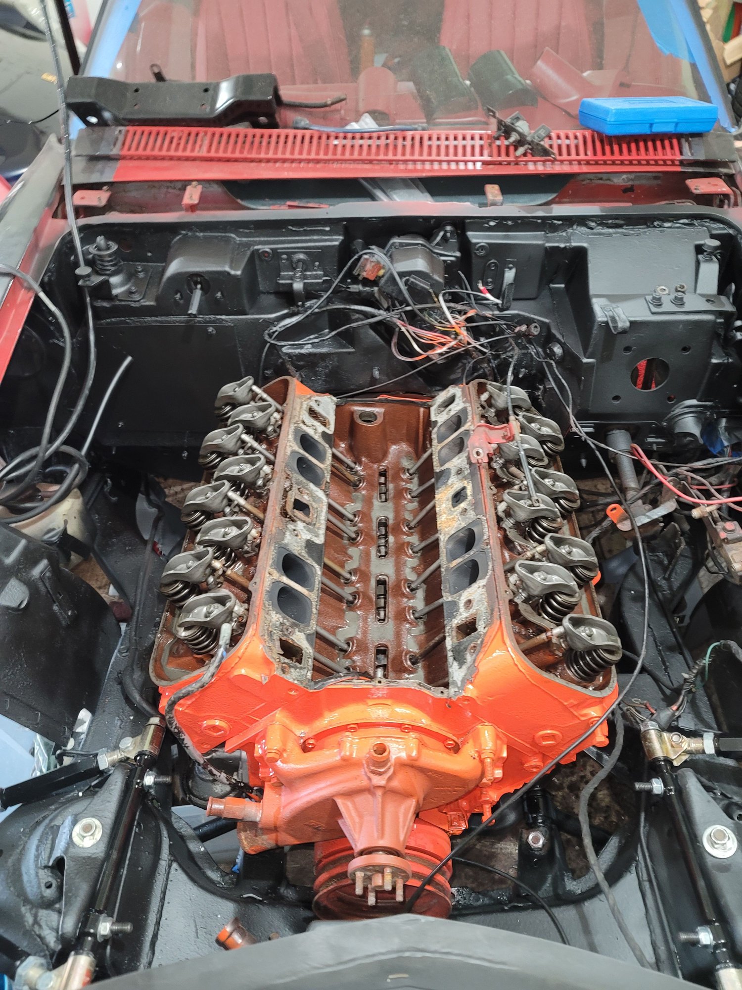

This won't be the 1st one, but it's my first old school engine.
​​​​​​I bought a project car (1968 c3) about 9 mths ago and finally got around to engine work. It was an original BBC car but at some point got a 396 swapped into it. I decided to paint the heads, spruce everything up, install a new water pump, etc... I finally drain the oil and -- milk (see pics).
I'm not sure how long the car ran like this or how it happened, but I started to tear it down today. So far I only got the intake manifold off, tomorrow I'll drop the pan. I didn't see an sparkles in the drained oil, and cutting the oil filter open revealed 0 metallic flakes. ** WHEN I DRAINED THE COOLANT, THERE WAS NO OIL IN IT. ** I'm not sure if the previous owner just put new coolant in it, but the car ran in my presence for roughly 5+ min, which should have been enough to contaminate it (I'd assume... But again, maybe the thermostat never opened?)
Like I said, this isn't my 1st rodeo. I've saved maybe 3 other engines before (usually blown head gaskets on imports, never a Chevy big block) -- so I'm trying to learn all of the weak points. So far:
​​​​​​The intake manifold gasket was soaked, so I'm assuming this could be a point of failure. The bolts weren't too tight, maybe hand tight, so from what I read there are a few bolts that go into water jackets... Couldn't tell if there was sealer on the bolts either.
I was planning on taking the heads off either tomorrow or the weekend. I had bought a full felpro gasket replacement set so I was going to do head gaskets as well. I'm going to check for cracks during that time.
With the heads off I was going to look for marks/cracks in the cylinders as well. I have a leak down tester, should I even bother before taking the heads off?
When I drop the pan I'll take a peak in the bottom of the pan for flakes again, and maybe take a few piston caps off to check the bearings. Anything else I'm missing that could have caused this? I planned on replacing the engine with a crate, but not for another year or so... So it'd be nice to be able to save this for atleast 1-2000 miles max.
Appreciate any info you could give. Thanks!

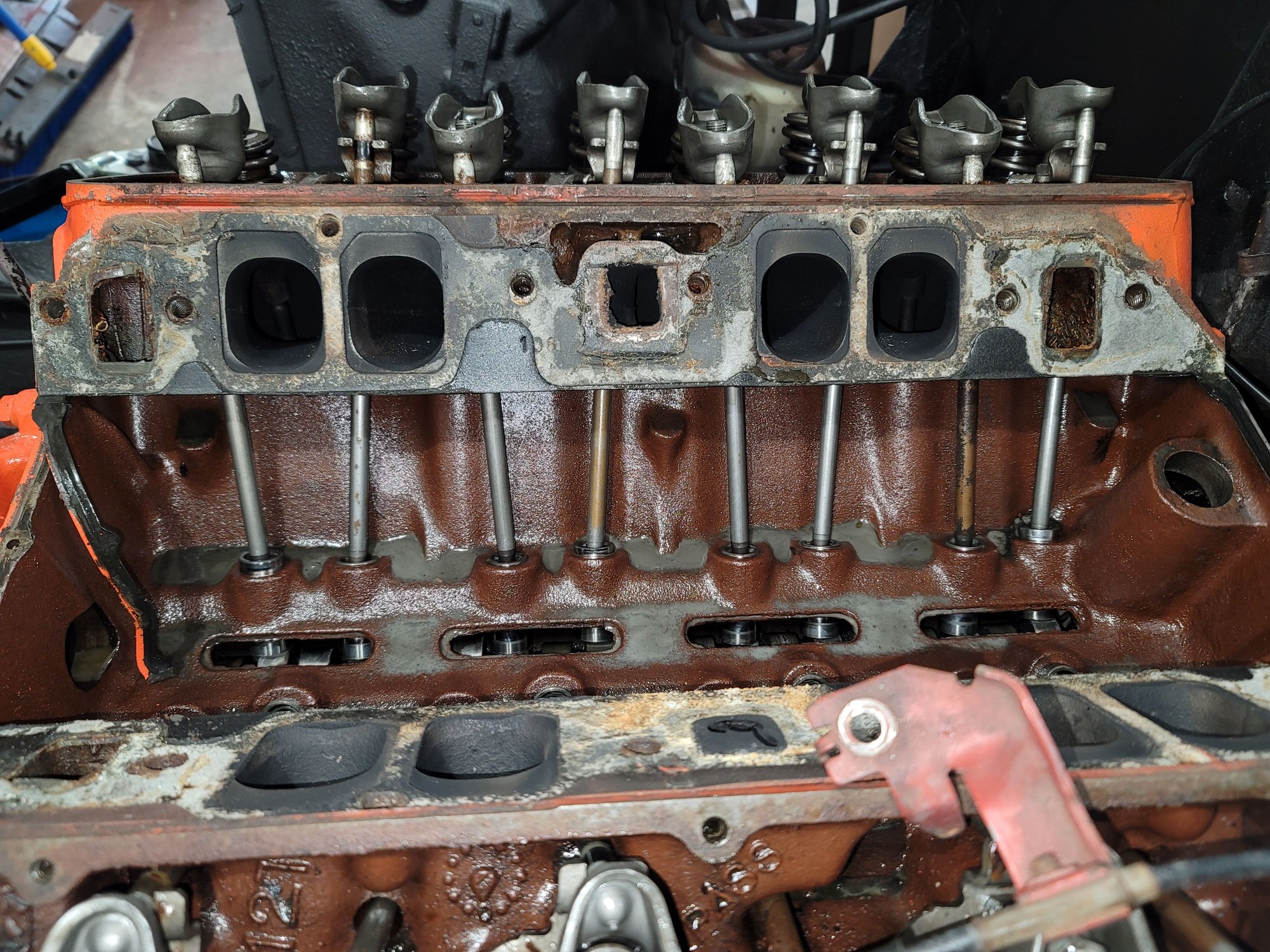

It has to have had a rectangle port intake manifold over the top of your oval port heads because it has rectangle port intake gaskets still stuck to the heads. Has water in oil circulated everywhere including in the valley area. If you don't find something obvious caused that make sure you have the heads and block checked for cracks before you start putting any money into it.

It has to have had a rectangle port intake manifold over the top of your oval port heads because it has rectangle port intake gaskets still stuck to the heads. Has water in oil circulated everywhere including in the valley area. If you don't find something obvious caused that male sure you have the heads and block checked for cracks before you start putting any money into it.
Wow good eye, I didn't even bother to look at the IM after I pulled it.

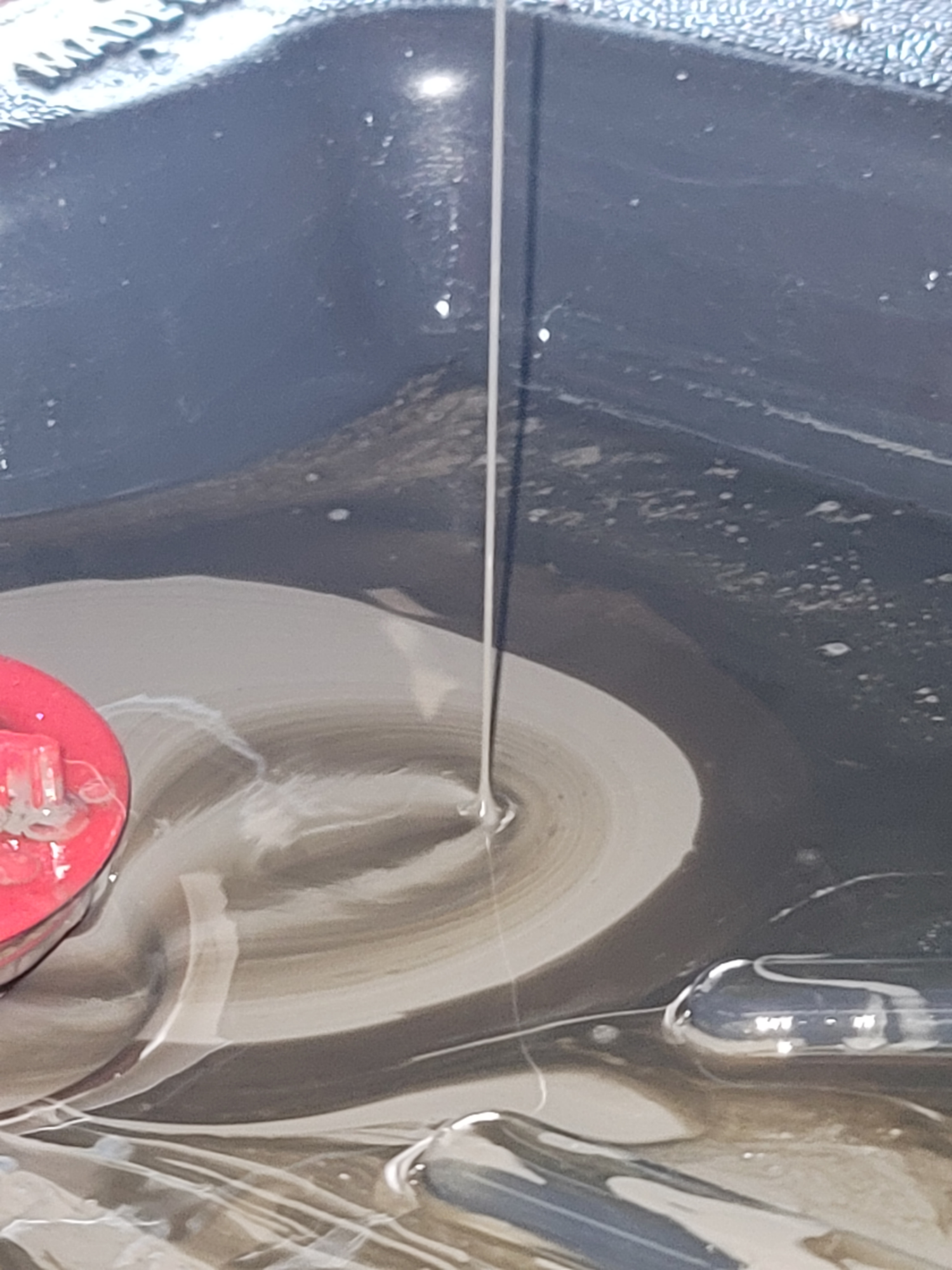

Does the water pump/radiator/water jacket have any milky liquid in it?
That's the cleanest nasty internals I have ever seen considering you witnessed the engine running.
IF it is water/coolant...shouldn't it have separated in 9 months?
Some type of strange additive previously added in the oil before you saw it running (rookie guess)?
I'm !
I can check the pump tomorrow. When I pulled the dipstick it was greyish, but the radiator (I pulled the lower hose to drain it maybe 2mths ago) was filled with green fresh looking coolant, so I didn't even bother to look into it any further. If I saw oil filled coolant come out I probably would have looked into it sooner. When I drained the oil it drained out pretty much like water for a good 2 minutes before I took the picture posted above, so it seems like the whole pan was filled with coolant.
The only other thing I can think of is that I power washed the engine bay a few days before, but that wouldn't create a grey mix like you're seeing. I'd assume if water did get into the engine (I have the exhaust off, but plugged the holes with towels) it would just run down as water and not have time to mix into a grey milk shake.... So I'm assuming it was like this while running. But it doesn't seem caked on at all, so I don't assume it ran for any significant amount of time with this issue.

Someone was in there before. The lifter valley is painted with Glyptal which is a nice detail, that tells me at sometime at least someone did some nice work in there

is the grey oil sticky. hen I milkshaked my 327 it was a sticky mess. It ruined all the bearings in my motor
I agree. Glyptal rotor paint is old school. It got some love at some point.
My guess - The intake manifold gaskets leaked and let water into the oil. If you run it at all, it will mix very quickly.
Overhaul it. Gaskets, rings, bearings and anything else small that it needs. I would not bore it as the additional expenses escalate very fast on a 396. Check for cracks and reassemble it.
Wasn't really sticky, it flowed like water - it had the consistency of cooking oil. Wasn't tacky at all.

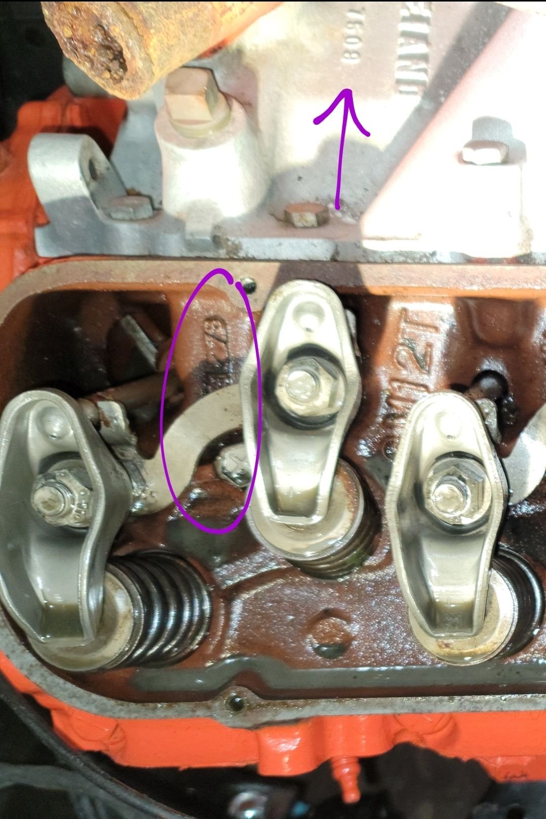

a 279 is a gen 6 head. these are old school. gen 6 doesn't have the pipe plug on each end of the head. look in the intake ports. there is a well defined ski jump ramp that gives the swirl that vortec is named for. 100 cc chambers. good truck or street head. you wanna rev it, get something else. either way i think the heads need pulled.
Quick update before I drop the pan:
Heads are: 336781 -- looks like off of a 454?

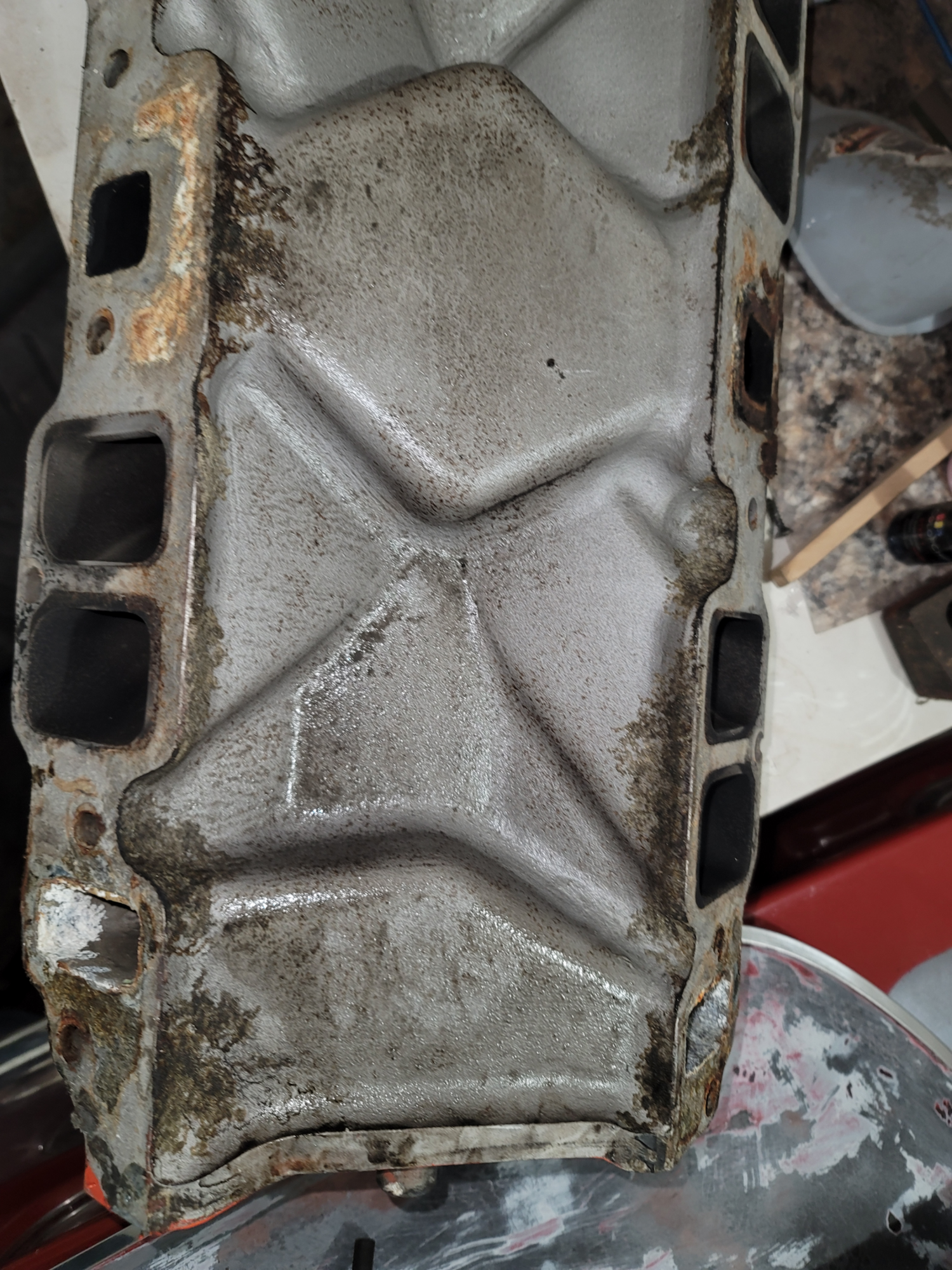

Intake is: Weiand 7509
Intake underside:

is that flange rotted through right below the water passage on the left front of the manifold? if so, there is your water. 781 heads. 396. can you see piston domes through plug hole? this may be a seriously low compression engine with those big *** chambers on the smallest BBC. with 25cc dome, .041 gasket and .020 deck clearance i get 8.5:1.
