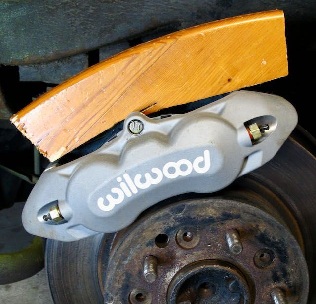

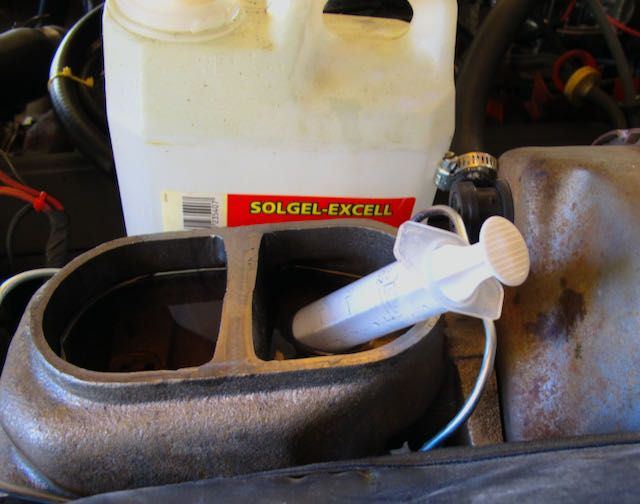

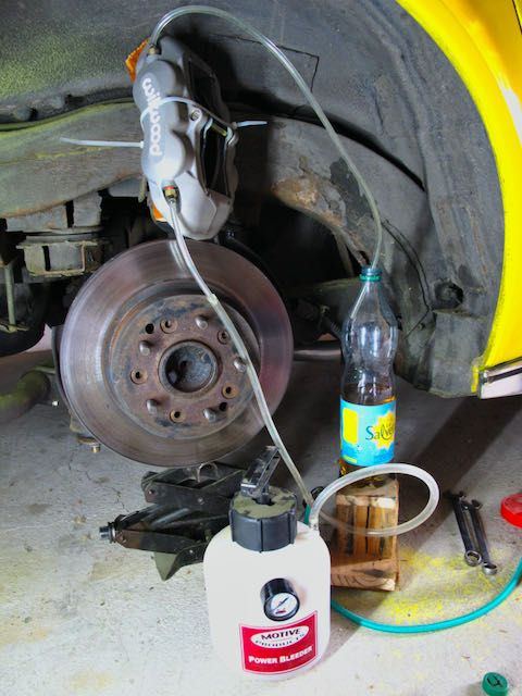

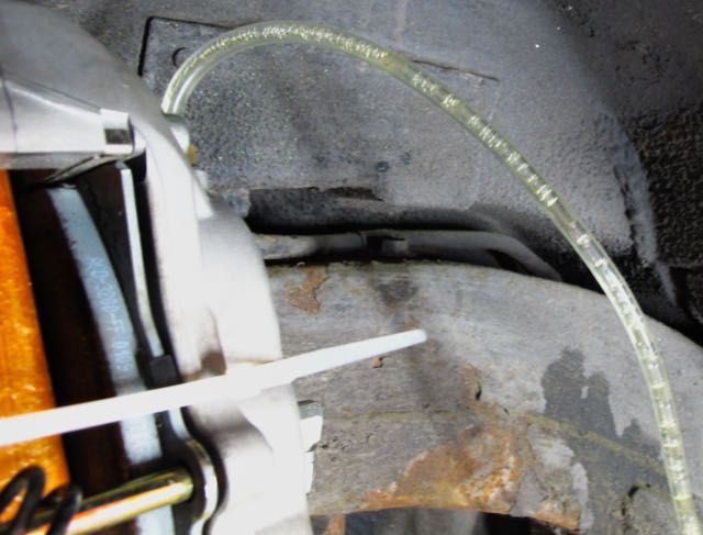

I, like a lot of other people, almost drove myself to drink trying to get a reasonably high, firm pedal in my C3. My buddy and I spent hours and hours bleeding, adjusting, bleeding some more, replacing the proportioning valve, bleeding some more, you get the idea.
I finally ended up with a decent sort of pedal that got the car through a French safety check so I could register it here, but I still didn't think it was right. Sometimes, sitting and waiting for something, idling in drive, the pedal would sink even a little bit further. It wasn't good enough.
Then I had an inspiration, or maybe a crazy idea. Bubbles don't want to go down in a fluid, they want to go up. (Observe your beer). Yet, when bleeding the brakes, we are forcing the fluid from the highest point in the system to the lowest, trying to force air bubbles to go down. I decided to bleed the brakes backwards, from the callipers to the master cylinder. I thought this would also have the added advantage of taking any last bits of air out of the master cylinder because the compensating port is the highest place in the system.
So, I cut the hose on my trusty pressure bleeder, cobbled up a smaller plastic tube to fit into it and then removed the rear Wilwood calliper. Looking at this picture, I have no idea how Wilwood thinks all the air is going to come out of these things while they are mounted. I put a block of wood between the pads and used bungee cords to hold the calliper up.
I then hooked the bleeder hose to the bottom fitting, pressurised the tank and opened the bottom bleeder to let the fluid in. I had removed some fluid from the master cylinder and had my wife watching for bubbles. Sure enough, she said that a few very small bubbles came out and then stopped. I then opened the top bleeder on the calliper and got some bubbles there too. Every so often, I'd go and remove some fluid from the master, and to make a long story short, did all four corners. I did leave the front callipers in place, there was no reason to remove them. I don't know how much more air came out of the system and up through the master because my wife abandoned me due to boredom.
But, I can tell you, this car has never had a pedal like this. It's quite high, firm, and predictable. It seems like when there was air in the system, the brakes were either on or off like a switch, either not stopping the car or throwing me through the windshield. They are now literally perfect.
If you think I'm nuts, fine, but the fact of the matter is, it worked.

Originally Posted by 4-vettes
Nothing crazy here. I have pushed brake fluid backwards many, many times on Harley's. works the treat.
I'm not surprised its been done before, there's probably no such thing as a new idea. I just didn't know anybody who had.
Is there a particular reason why its easier to bleed Harleys this way?

I think there's a couple of reasons why it's not too popular.
It's messy. Next time I would take the bleeder screws out and put teflon tape on the threads to prevent seepage.
It's more difficult. You have to have a pressure bleeder and adapt the tube coming from it to something that will fit tightly over the bleeder. You also have to go to the front of the car regularly to syringe the accumulating fluid out of the MC reservoir and squirt it into something else.
I think you're right, for 98% of the cars out there, this method isn't better because it isn't necessary, but the air problems in these brakes is legendary. I tried everything possible five times each over the course of weeks. As I said before, all I can tell you is it worked.
