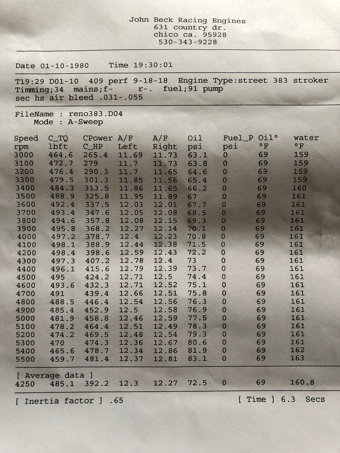

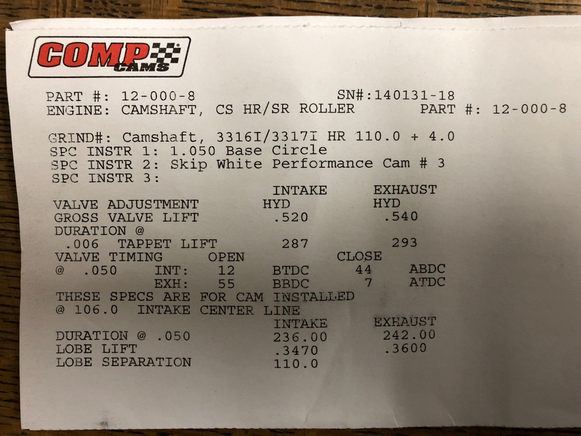

I have posted this many times because this cam works in a 327 or 383. Skip White only made by Comp Skip calls it the Magic cam. I am running Pro Max heads also from Skip.
