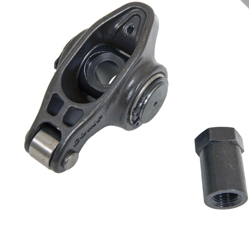

I got a custom grind cam recommendation, this time from Isky Cams. Sounds like it’s right about where I need to be, considering the input I’ve gotten from you guys.
Here’s the specs he suggested:
485 lift on intake
488 lift on exhaust
217 @ 50 on intake
226 @ 50 on exhaust
110 LSA
Im gonna go with 1.5 cast full roller rockers.
What do you guys think?
Do you think this would be a suitable choice for my setup?
383 stroker
9.9:1 SCR
Auto TH400
RPM Air Gap intake
650 Holley
Vortec heads w/screw in studs and ground down guide bosses
Street/weekend cruiser
Exhaust still up for debate
93 pump gas
Likely a 2500 stall converter (TBD)
Thanks again for your input!

There is no such thing as a stamped full roller rocker.
You can get a stamped steel stock type rocker, a stamped steel roller tip rocker (do not use those unreliable designs) or cast steel roller tip rockers (do like those) or a full roller rocker made of aluminum or cast steel.

One poster here mentioned that the roller tip without roller fulcrum are not good because the roller tip adds weight and the friction reduction need is at the fulcrum, not the tip. I do know that brings the question - then why get full roller rockers?
The best way to go may be like the LS engines have - roller fulcrum w/o the roller tip. If I hadn’t already spent bank on the Comp Cams Pro Magnum full rollers, I would probably buy the LS style.
Yeah, you’re 100% correct.
I meant cast steel full roller, not stamped. Lol
Thanks for pointing that out.

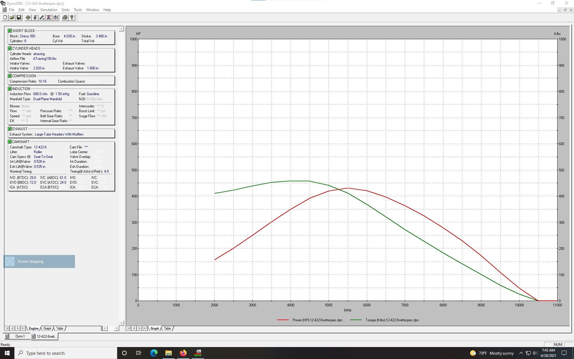

Originally Posted by cv67
Looks kind of similar to the HOTCAM only a little more aggressive. ought to pull pretty well and drive fine.
I just selected the hotcam in my old dyno software and with my combo when I change the displacement to 383 and change to the hotcam it almost matches my 355 combo exactly.. Its actually uncanny.. Now I realize software like this is only theoretical using math and performance tables but its an interesting comparision. I'm guessing the extra power in the 355 combo has to come from that "area under the curve" (Or lack there of?) with the roller cam. And I do take all this with a grain of salt myself.
roller xe270hr 355 displacement
flat tappet hotcam and 383 displacement
