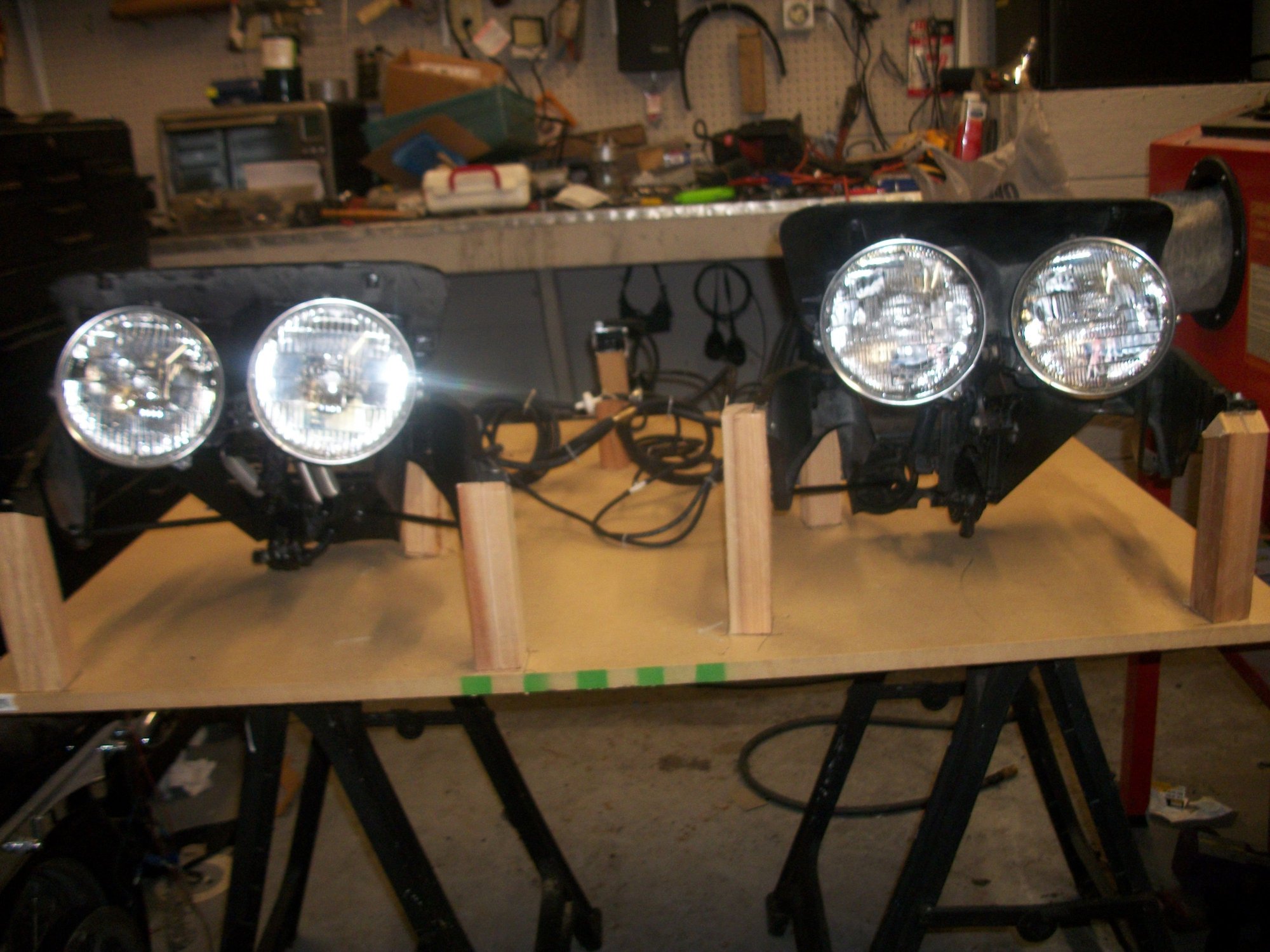

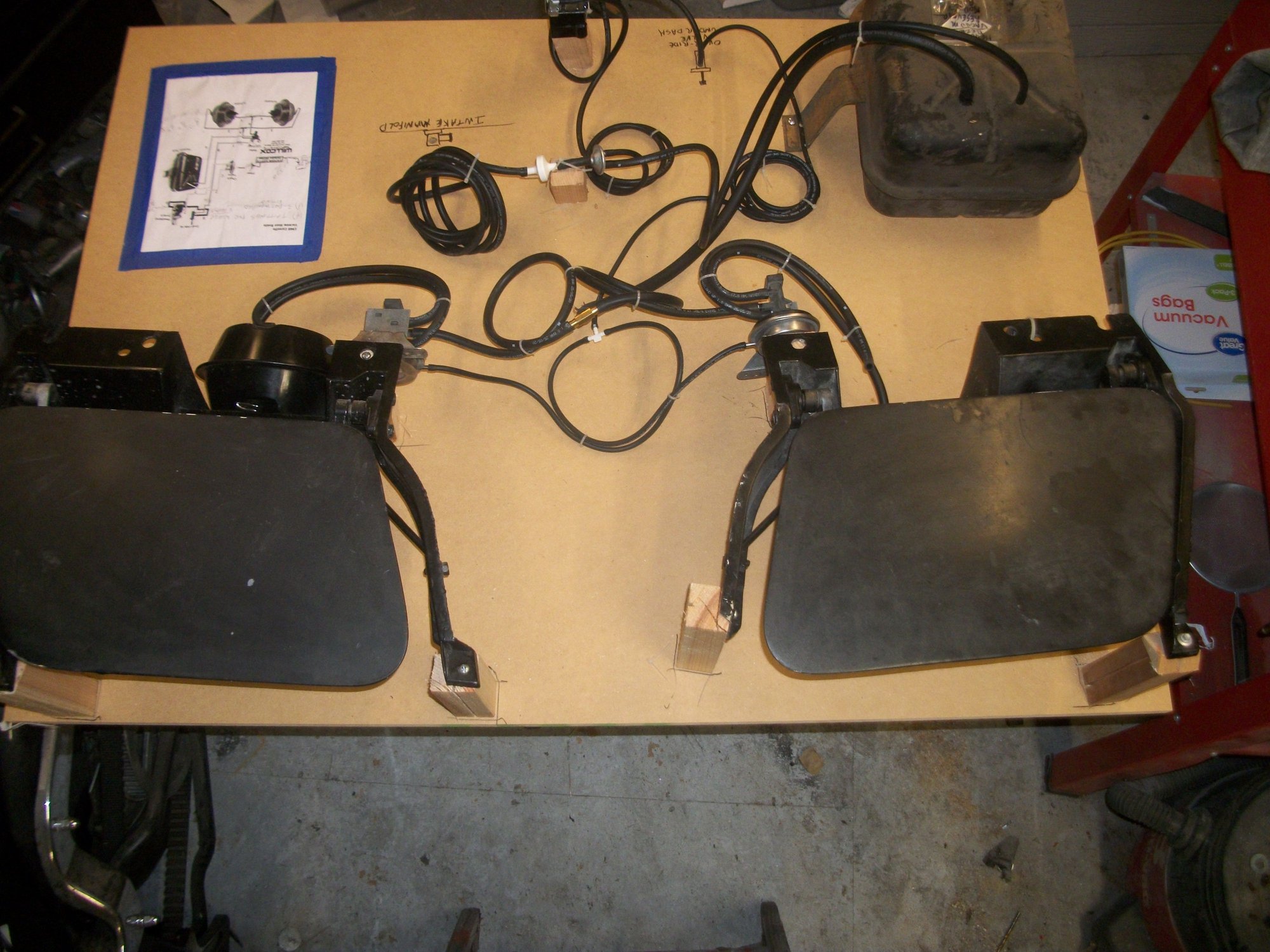

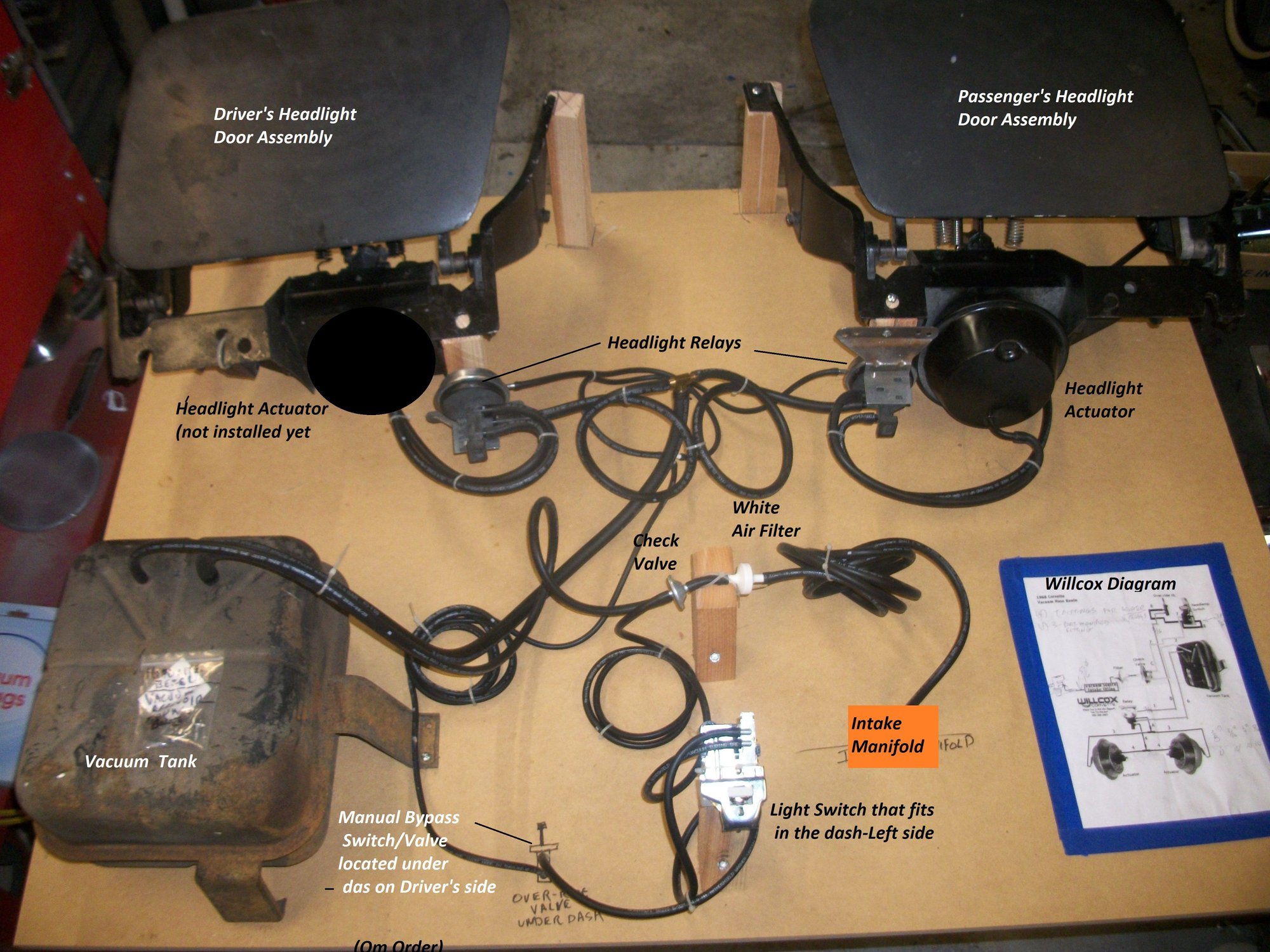

Since I am rebuilding the damaged clip on my car I decided to mock up the headlight vacuum system to try and understand how it works.
I must have been over-thinking (or under-thinking) the system.

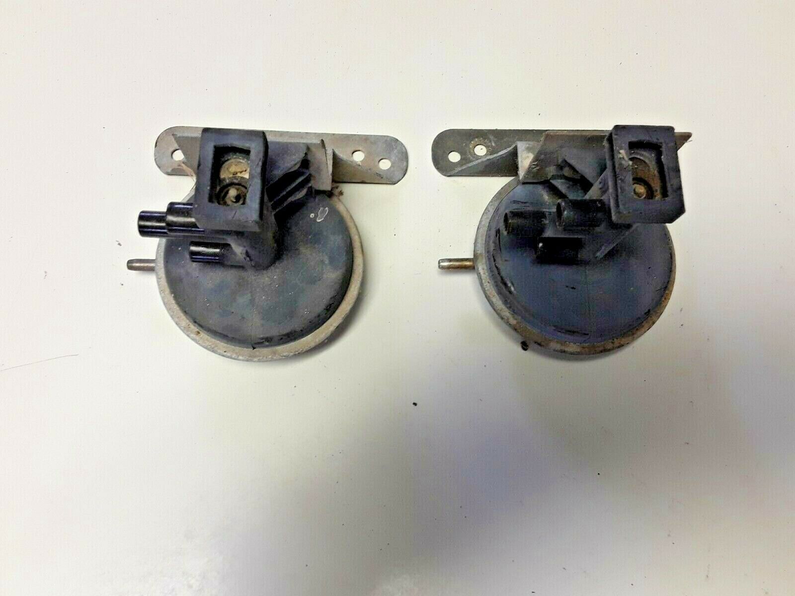

you need to fix vacuum leaks and blow the bug nests out of the lines. biggest problem is these control relays.
Old Jun 24, 2021 | 06:35 PM
derekderek's Avatar
derekderek
Posts: 13,082
Likes: 3,399
From: SW Florida.
see that brown in the left one? that is a mud wasp nest.
the vacuum hoses have to be unobstructed, but so do those 2 air returns. the vacuum doesn't raise the headlights. the air pushing on the other side of the diaphragm does the moving. that air has to pass through that wasp nest to raise the lights. these are 2 i bought used. the 2 in my car both had these nests. cut a quarter inch off every hose end. makes them fit tighter. i used a long tranny dipstick to get the bug nest out of the long big line from intake manifold to air tank. this is easy and essentially free work. no redesigning. no wiring. you don't use this much at night anyway.
