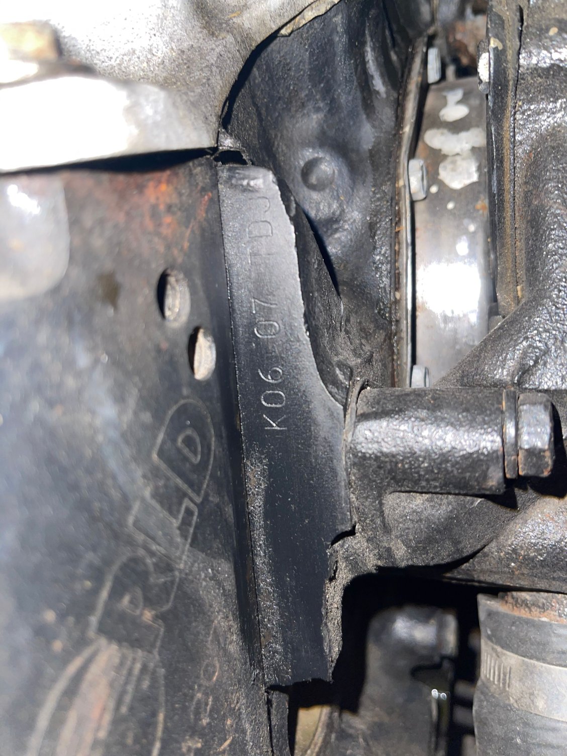

Originally Posted by Ethan_Hensley
Engine stamp says 3970010 at the back and has a “World” stamps with 03/15 on the front.
engine block or heads? most likely old world products sportsman iron heads... indicating a good chance its an older build. the engine stamp is in front of the passenger side head and painted black in your photo.. its not going to be easy to make out as the numbers and letters are actually stamped and not raised like the number you saw on the back.

Heads I believe
Heads I believe
the engine stamp pad is in this photo its the flat part at the base where the head is mounted.
if this is a 383 im going to estimate by what I see so far its unlikely to be anything more than 400hp but cant tell for sure without going deeper or testing other things.
that 03/13 may be the date actually which isnt that old.
K06 07 TDJ
Also some parts of replies don’t load in all the way so sometimes I don’t see your whole reply hence why I’m a bit slow
K06 07 TDJ
does any of those numbers match your vin# from what I can find that block started life as either a 1972 or 1980 350ci 155 or 170hp engine. so it could be a 383 now.
does any of those numbers match your vin# from what I can find that block started life as either a 1972 or 1980 155 or 170hp engine.
No they do not

EDIT I was wrong it was made in canada not near me in tonawanda Well st catherines is a couple hrs away over the border anyway..... looks like its a 4 bolt block which is good and from a truck or van.
At least we got some info from it
