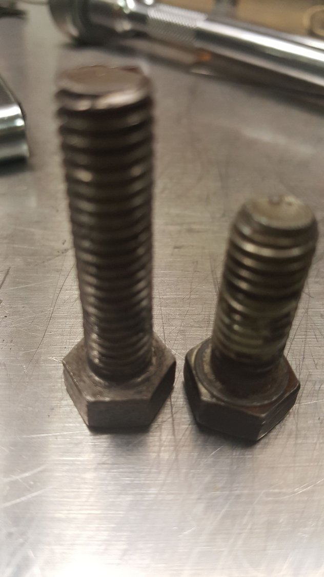

Easy way to see the difference - capscrew is on the right. Small washer face on the underside of capscrew head helps fastener turn as you fully tighten it. Bolts are tightened at the other end (nut) so the washer face under the head is not there.
Both of these have same thread diameter and pitch.
