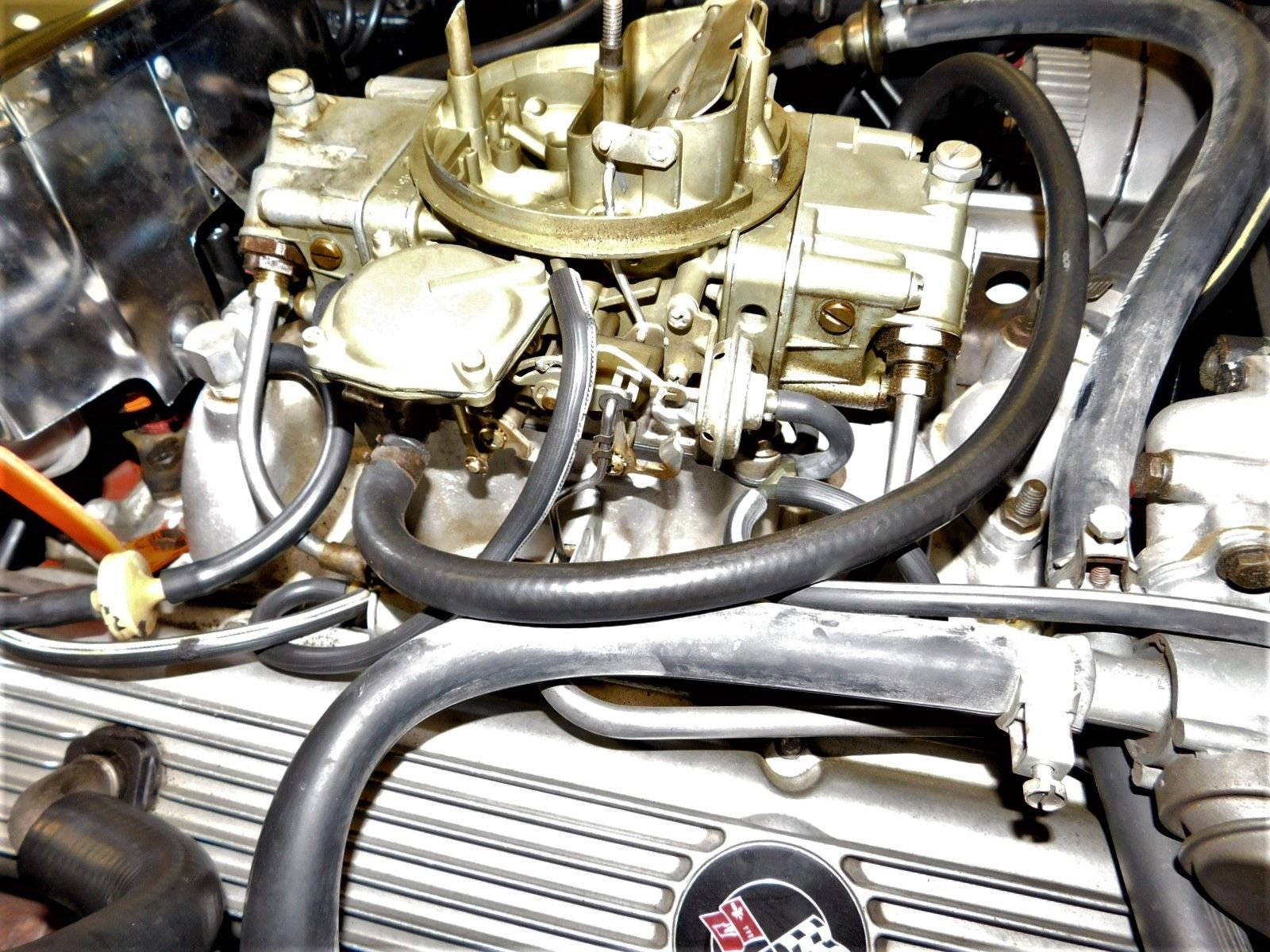

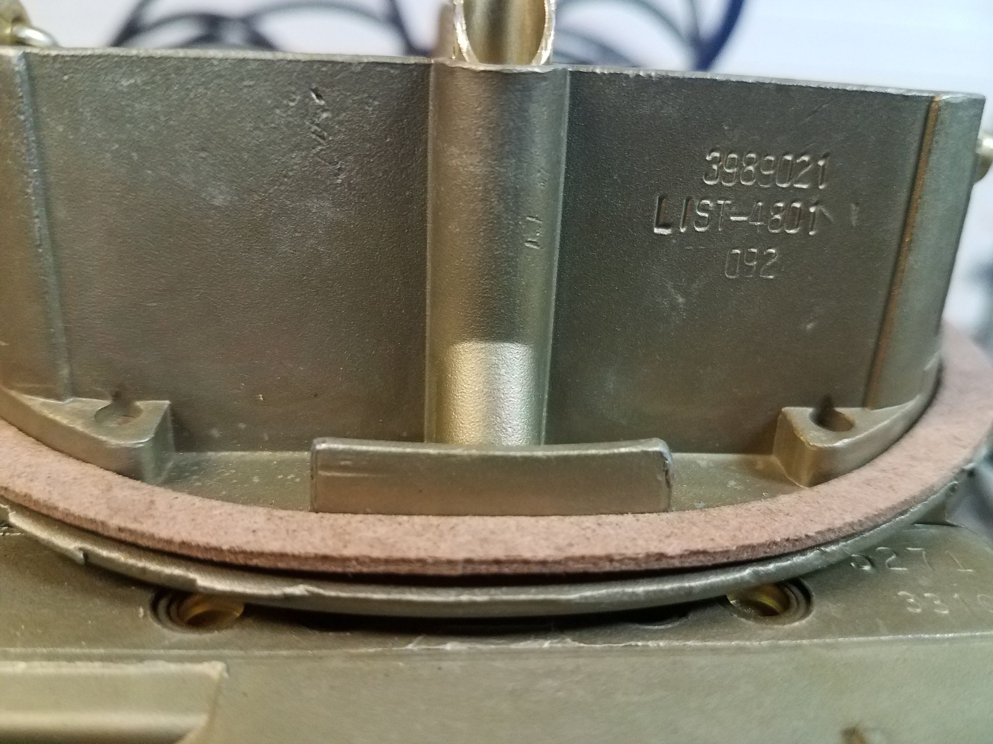

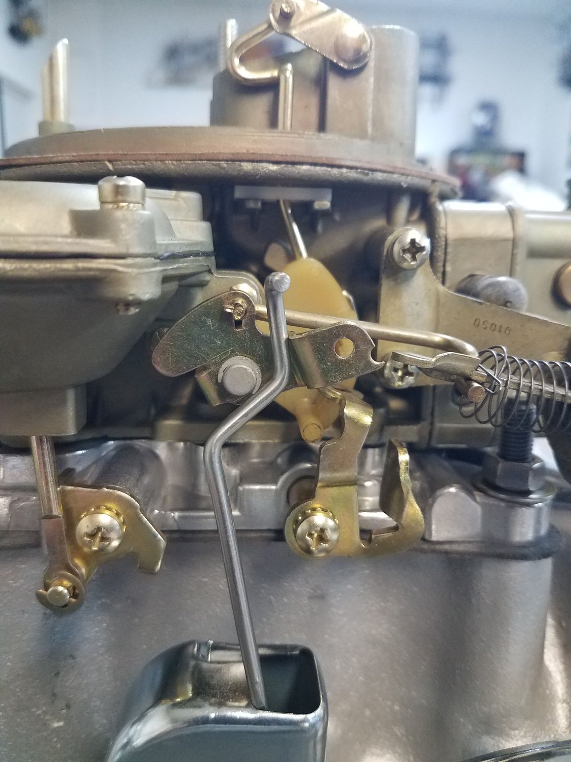

I've attached some Pics. The unit I purchased was supposed to be for the LT-1. This looks just like the link that Mrvettenick shared.
Choke plate closed
Choke plate open
Unit I purchased, Looks just like the one in the link that Mrvettenick shared
Carb Info
Overall view

At a quick glance, that lever which the rod connects to looks reversed. It's 12am now. I'll take a photo of mine in the AM.

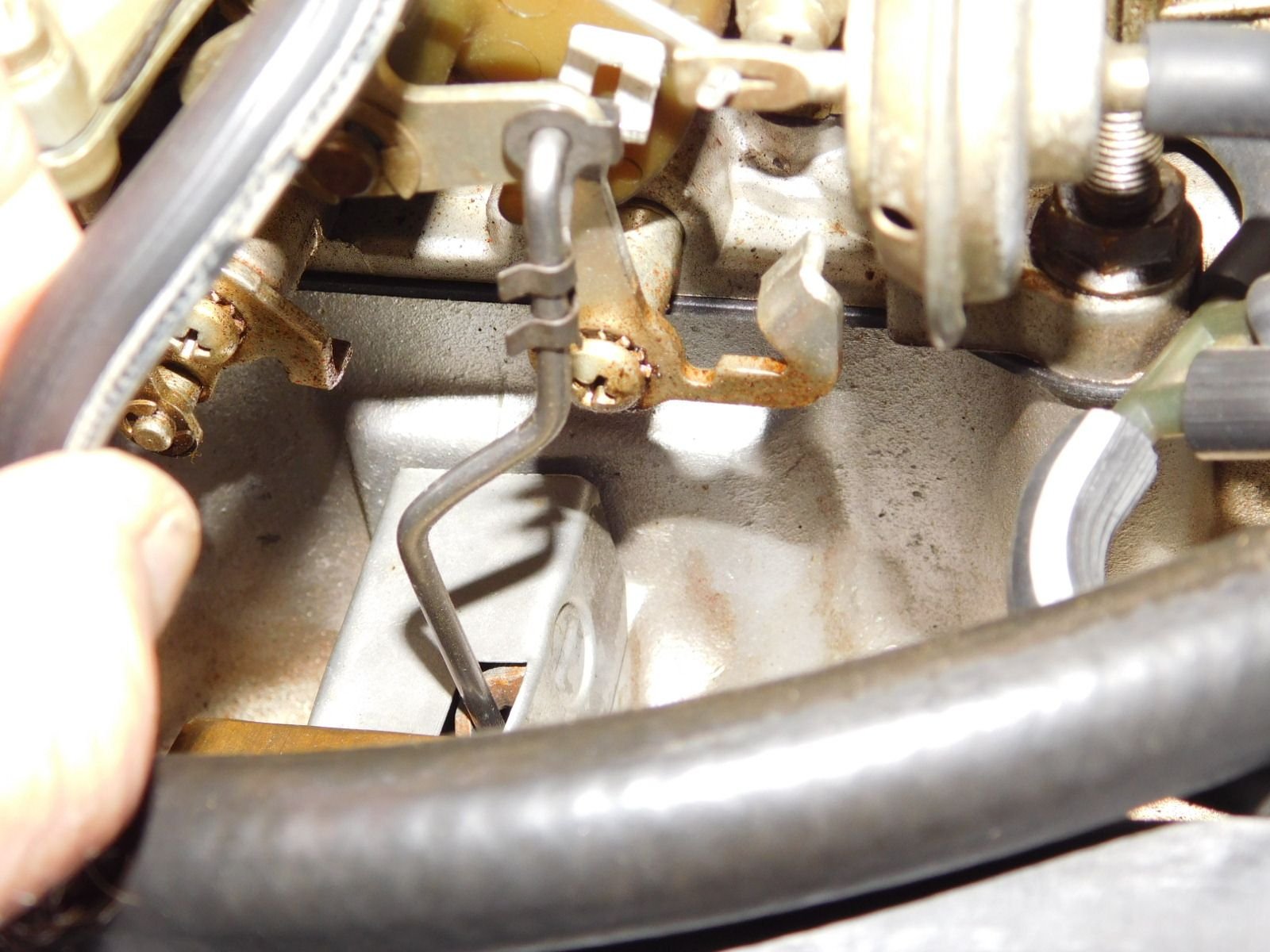

From my 1970, should be the same.

It appears that either that rod is too long, or the choke spring is incorrect. I'll take measurements fully open and closed later.
I have a '70 and the lever hook up is at 9 o'clock, not 3 like yours. I didn't think there was a difference in the years.

That is the same part that I currently have. As you can see by the pictures, it doesn't line up with the hole. I'm baffled. Any help would be appreciated.

I looked at the pictures of the other 1970 LT1 that I owned in the past and it had the same rectangle shaped choke spring cover as the pictures I posted, BUT the 1971 and 1972 LT1 are different and use a choke spring cover as you show.
Also, as Lars stated, you probably have a Q-jet choke spring. The 1971 Holley spring is different.

Based on your pictures the choke coil has to pull the rod down as it heats up.
Does it pull the rod down?
