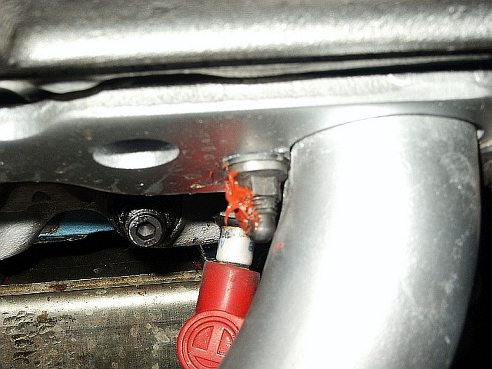

They don't use washers or you can use washers. I first used then as is and then I got the bright idea to put a dob of Permitex red high temp just so I wouldn't ever loose the nut.

That's fine for the smaller 1 5/8th primary header pipes. But when you go to 1 3/4 NO 3/8 hex will clear the pipes and some even using bolts would be a PITA to install. I tried using stage 8 at first. I had to grind every hex locking washer for pipe clearance and you kinda had to install all the bolts through the header flange and alternately tighten then to slowly draw the pipes to the head. Just say NO to any phoney bolts!
Sorry, Rescue Rogers I did use washers in this picture. If you look closely I actually had to grind down the shouldered 5/16th nuts for pipe clearance

What could be easier than this? I'm really not sure why people defend BOLTS and the possibility of stripping out your threads in the heads. I also use a stud for the dizzy hold down and the carburetor is on 4 studs. On my old valve covers with short length, they had studs. Just so easy to assemble and nevery worry about hurting the intake manifold.
ARP head studs with 12 point nuts

I never had one come loose. But the high temp red doesn't get damaged by heat and I didn't want to ever loose a nut because you have to buy sets. The red Permatex really does handle heat. When my headers would be glowing orange for long periods of time it actually melted my Energy Suspension red poly motor mounts.
Thanks gkull, I had no idea that 'high heat' meant it could handle that kind of "high heat"! Great information.
