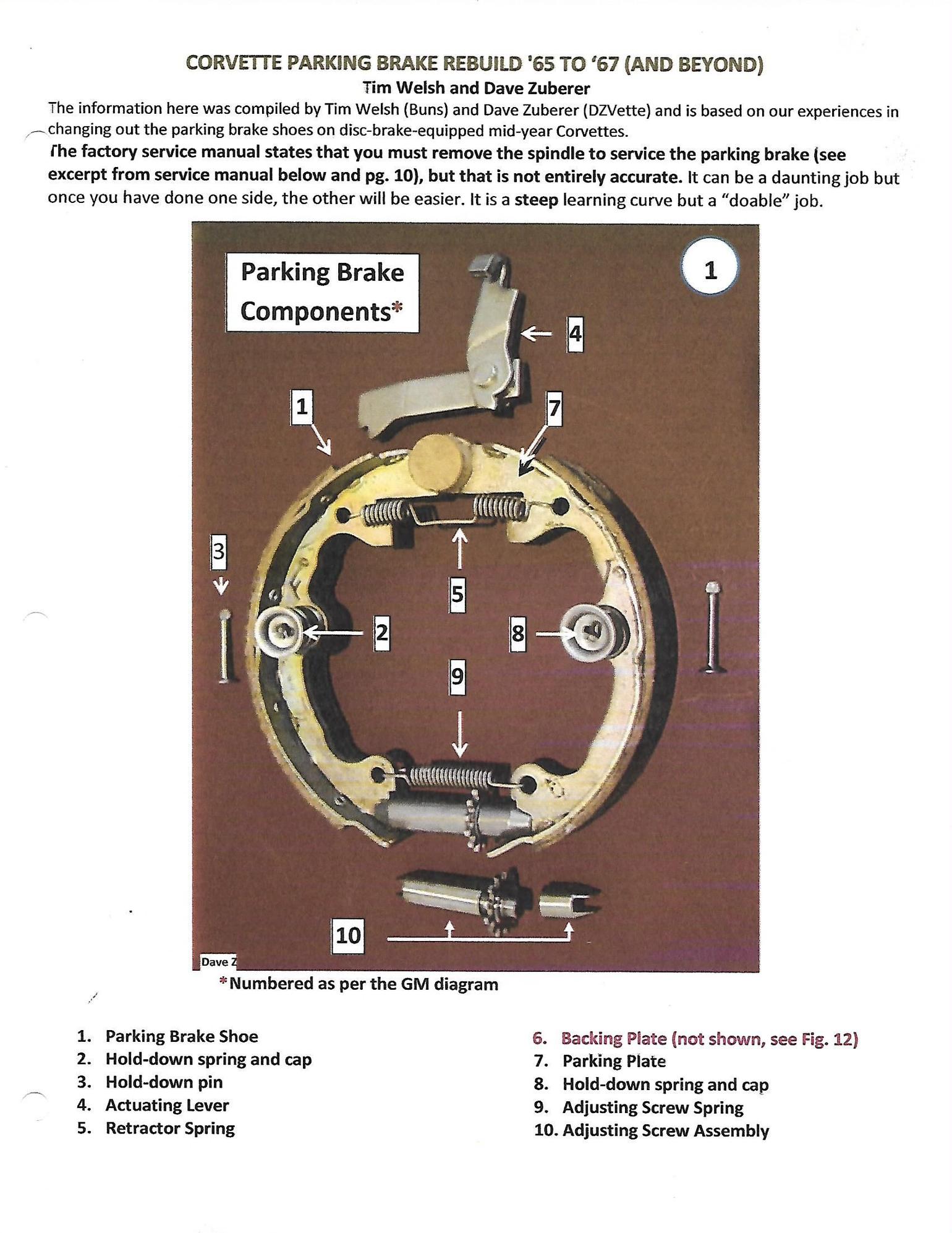

You should put the rear frame on jack stands/block the front wheels from rolling/put the car in neutral and rotated the rear wheel to see if there is still schreeching-rubbing noises before driving the car.
Also...if the parking brake assembly (inside the drum of the rotor) comes apart it will act the same way...
BUT you should follow Peterbuilt's advice and eliminate all other possible points of failure FIRST.

I agree, remove the caliper and rotor and inspect the parking brake parts.
