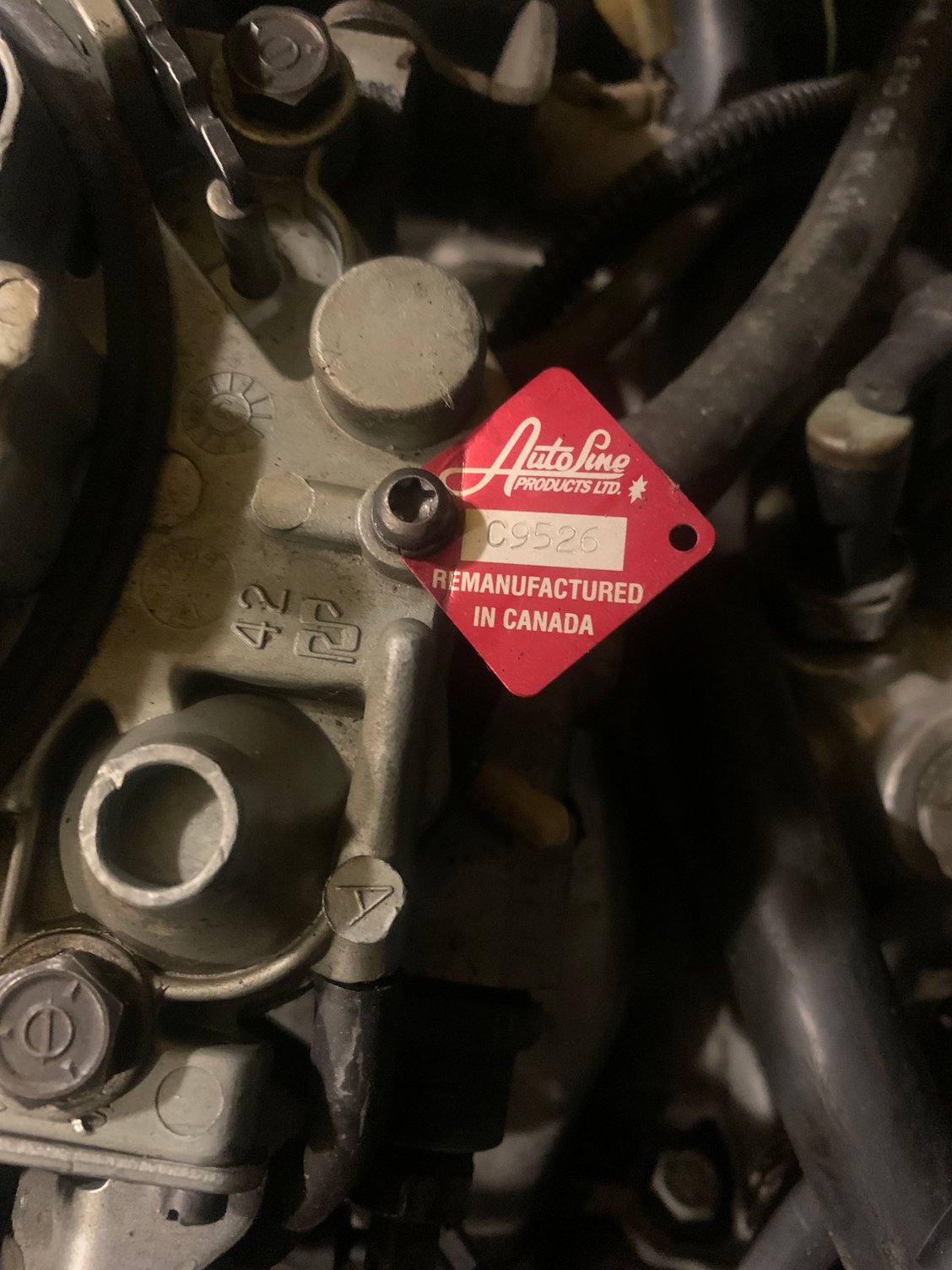

I have a question for the experts. I have a 81 that I have had for about 6 weeks. The car has had the CCC stripped out and a vacuum advance distributor and regular rochester installed. I experience a very low idle when cold and then after a block or two the idle jumps up the 1200-1500 rpm in park. Seems the idle goes up when it gets warm instead of the other way. I have looked for a way to set the idle down and on the drivers side the screw that sits against throttle is all the way out and still has high idle.
On another note, The ECM in the battery compartment is there but unhooked. Both 4 pin connectors under the hood are open as well, The carb does not have any electronics on it. It also has a reman tag on the front top.

Originally Posted by BT1991
The carb has a reman tag on the front top.
There's your problem: The carb is complete junk. If you want a list of everything wrong with that carb, just send me an e-mail request for my "Commercially Rebuilt Q-Jet Problems." Throw it in the trash and find a good, unmolested, rebuildable Q-Jet.

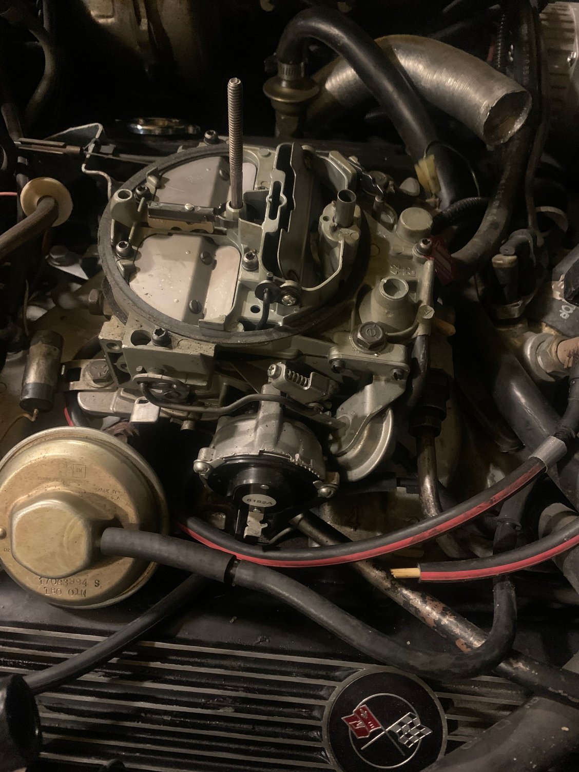

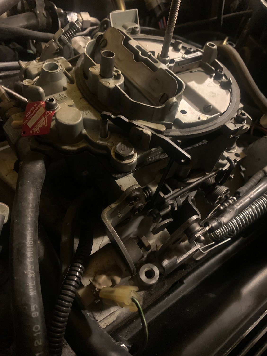

Old Jul 20, 2021 | 10:53 AM
BT1991's Avatar
BT1991
Joined: Sep 2019
Posts: 278
Likes: 150
From: Calgary AB
Pictures of the carb.

choke is halfway open. is that cold, or warmed up?
Old Jul 20, 2021 | 11:27 AM
BT1991's Avatar
BT1991
Joined: Sep 2019
Posts: 278
Likes: 150
From: Calgary AB
warmed up.

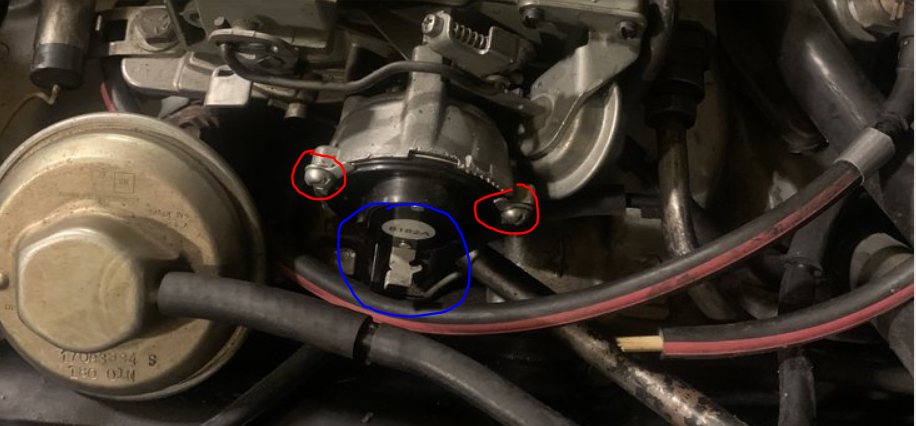

Old Jul 20, 2021 | 12:03 PM
Jebbysan's Avatar
Jebbysan
Dr. Detroit
Joined: Mar 2012
Posts: 10,097
Likes: 4,027
From: New Braunfels Texas
Okay.....so you have no power wire going to the choke coil so it is not functioning and is holding you idle high.......the blue circle is where a keyed 12v power source is supposed to go. The red circles you will loosen with a screwdriver and turn the whole choke coil clockwise, there is a third one at the bottom.....simulating a warm wide open choke condition. The idle should drop afterward.......there is a lever behind the choke coil that holds the throttle open for fast idle during cold start up......
If you have troubles afterward...then the carb needs to be replaced with a good core that is refurbished.
Jebby
