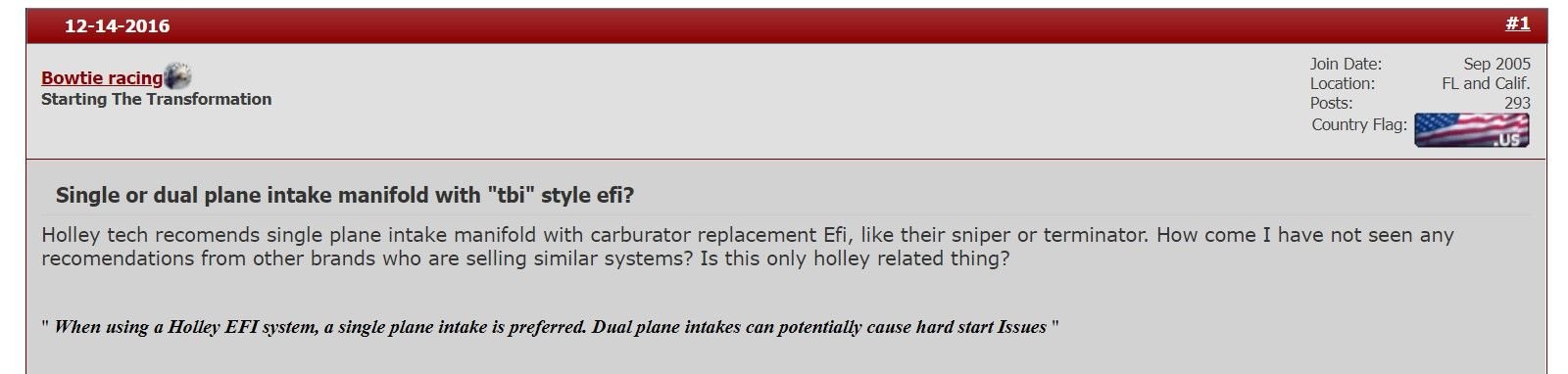

Milling the divider on an EFI setup does absolutely nothing to the throttle response on a dual plane manifold. There is no signal needed like a carb and that is the only reason the dual plane manifold exists.
The reason for the milling is a Sniper (like others) has the MAP only on one throttle bore.......on a dual plane there can be two distinct vacuum patterns from one side to the other, and this can trip up the mixture if one side needs more or less fuel than the other.....four runners are much longer and flow a lot less than the other four. In fact, the K5 Blazer with the Blueprint 355/385 came back for drivability and I installed a 1/2" spacer on it...problem went away......
If you look at NHRA Top Stock or Super Stock carbs on factory dual plane intakes....they are all stagger jetted side to side.....same type of thing. On the street the compromise is less, but MAP sensors are much more touchy than a carb booster.......
Hindsight 20/20.....given the hood clearance the guy has on that K5.....I would have put a 2975 Super Victor on it for runner length.....
I suspect a lot of problems coming up with Holley's Q-Jet Sniper....as the only reason to use one is to keep a stock manifold.....and all Q-Jet manifolds are dual plane......
I think someone told me that Holley has fixed or is going to fix this issue.......maybe I am dreaming.
