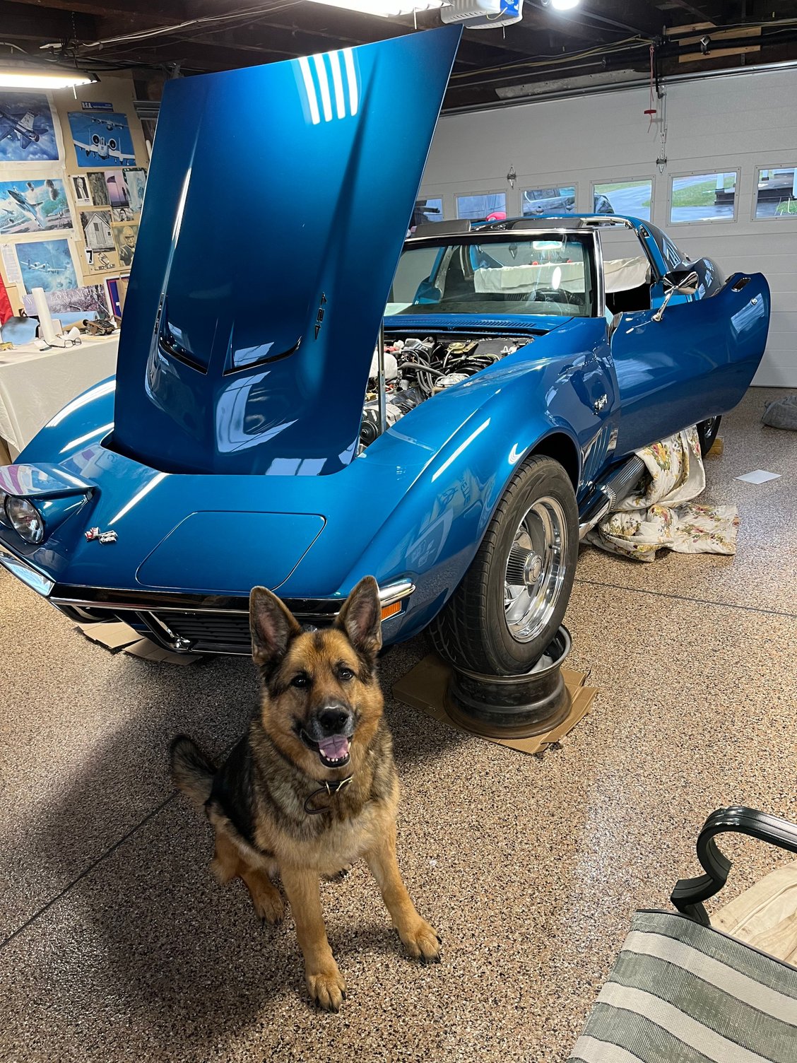

I know that this thread is old but I used the info that I found here
to get my headlights operating. I kept the vacuum system and used the
AIM for the routing of the lines. Posts 12 and 43 saved me a ton of
work. Thanks Peterbuilt and Stingr69.

Perfect example of why these vacuum systems are just problematic......just saying. But....hey, if thats what you want to spend your time with, its all good. Me.....I prefer driving the car.

It's not going anywhere for a while anyhow.........
