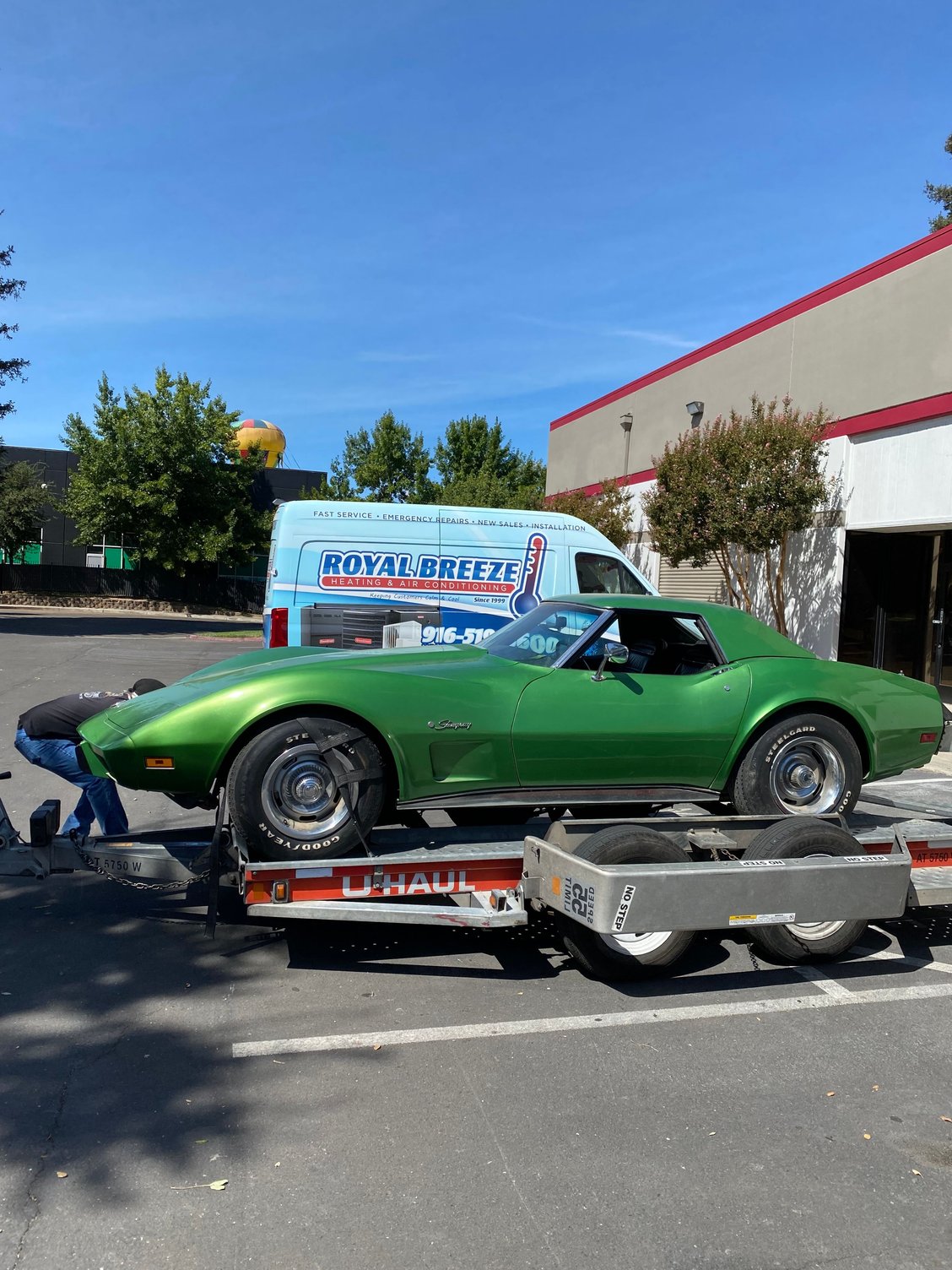

This car sat in a garage for 35,pretty much forgotten.
