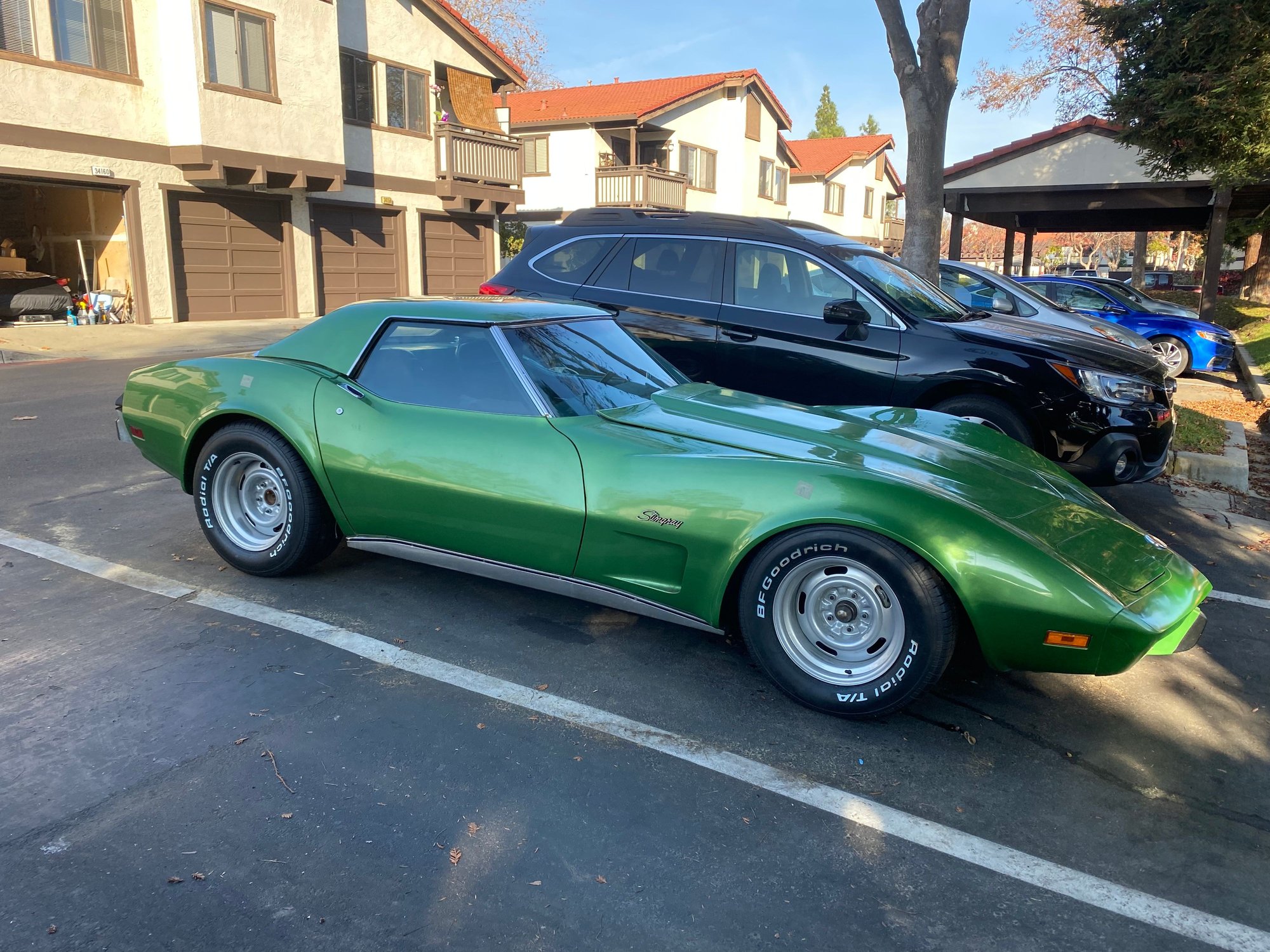

Totally unmolested ride height 1971 roadster .

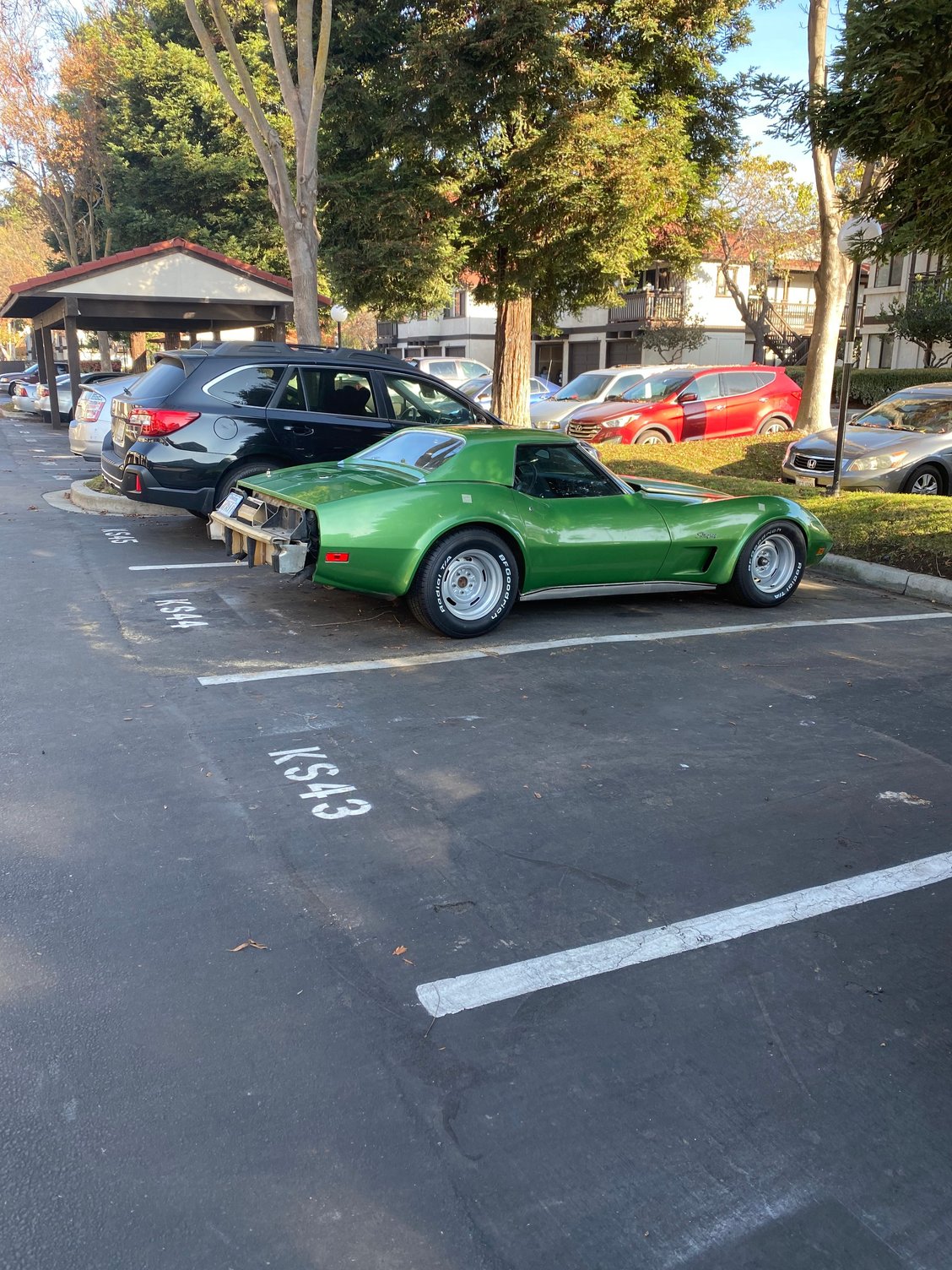

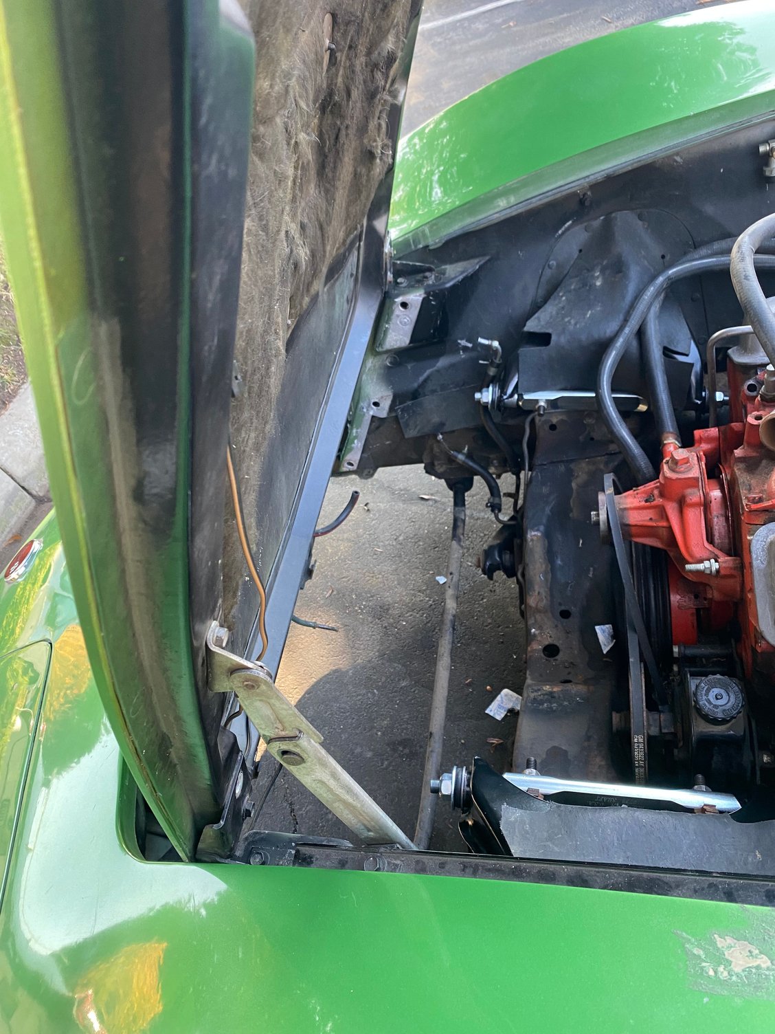

Got the coil overs in the front,waiting to get the radiator back in the car before I can set the ride height. I put a set of 8 inch spring bolts in the rear and it needs to come down a bit more. I've got a set of 10 inch bolts I'll change once I do the shocks in the rear. I'd like an inch between the fender/tire then set the rear to match the front. To get the car this low I had to use a set of offset A-arm shafts to get the alignment within spec. To get the A-arms off the radiator had to come out of the car,this project kinda snowballed. Did I mention this cars got 12,000 original miles?
