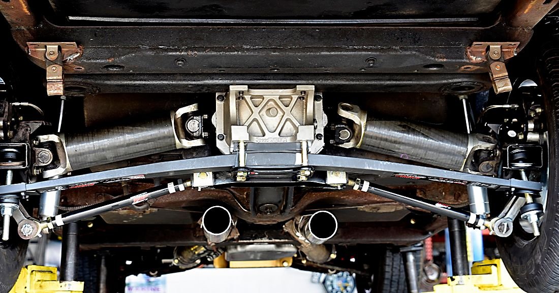

I have been running carbon fiber half shafts (solely to save weight) for over 15 or so years with no problems. I got them from Vansteel, don't know if they're available now. I considered a fiber driveshaft also, but the smallest diameter available was 3 1/4" which was too large to fit in the tunnel. I opted for an aluminum driveshaft instead, 3" diameter, barely fits but OK.
What are those brackets welded to the diff cross-m?

Muffler hangers?

Originally Posted by ratflinger
Muffler hangers?
That is my guess too.
They were for the exhaust or spare tire tub, I forgot which.
