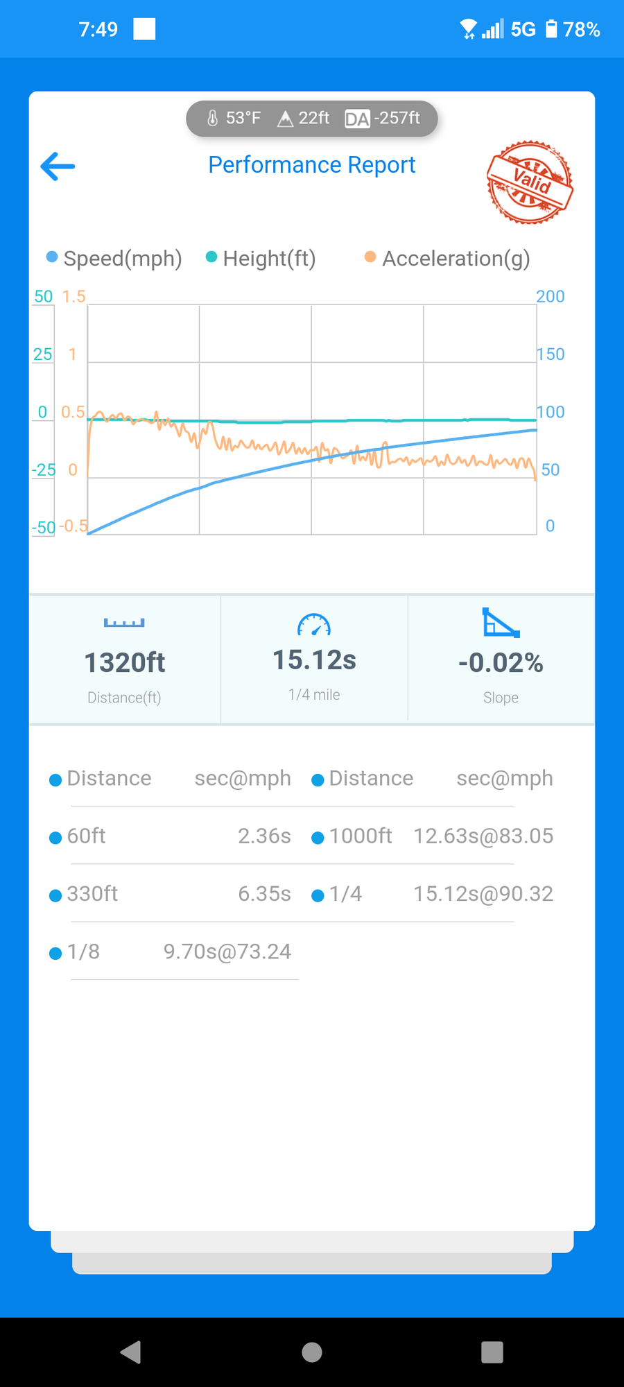

I completed my my header install last week. I'm not sure if the headers improve the performance. Using Dragy I got a 15.44 before and a 15.12 after the headers install. There's also a 31 degree temperature difference too. Using some on line calculators I gained nothing.
I'm thinking the y-pipe is a restriction.
So I'm thinking dual exhaust with dual cats. This a stock 350 Crossfire engine. If I look at some of the exhaust system pipe sizing charts it shows 2.25" would be the correct size up to 250HP. However I believe those charts are for gross horsepower, not net. So what would be the best size, 2.25" or 2.5"? I'm going to fabricate my own exhaust with the left bank crossing over to the right. After this I have no other performance plans for this car.

I should have been more specific. Looking at those times it seems that the bottom end is better than the top end. So I'm guessing that a 2.5 piping would be a better choice than 2.25 piping. Is my thinking correct?
I'm not looking to set the world on fire with this car. If I was the first thing to go would be the Crossfire intake. A stock TBI intake from a 5.7 truck is probably better than a crossfire intake.

Well yes and no. There was a difference in the weather so I really don't know how much is due weather. To answer your question here was my thinking at the time. I was concerned about the additional noise from a dual exhaust system along with the headers. So I figured keeping it with the 2 into 1 into 2 would be the way to go. In David Vizard's book he stated that headers into a single cat is still beneficial. The car still sounds the same with the headers except when I get on it, has a nice throaty sound. So I'm ready to move on to dual exhaust.

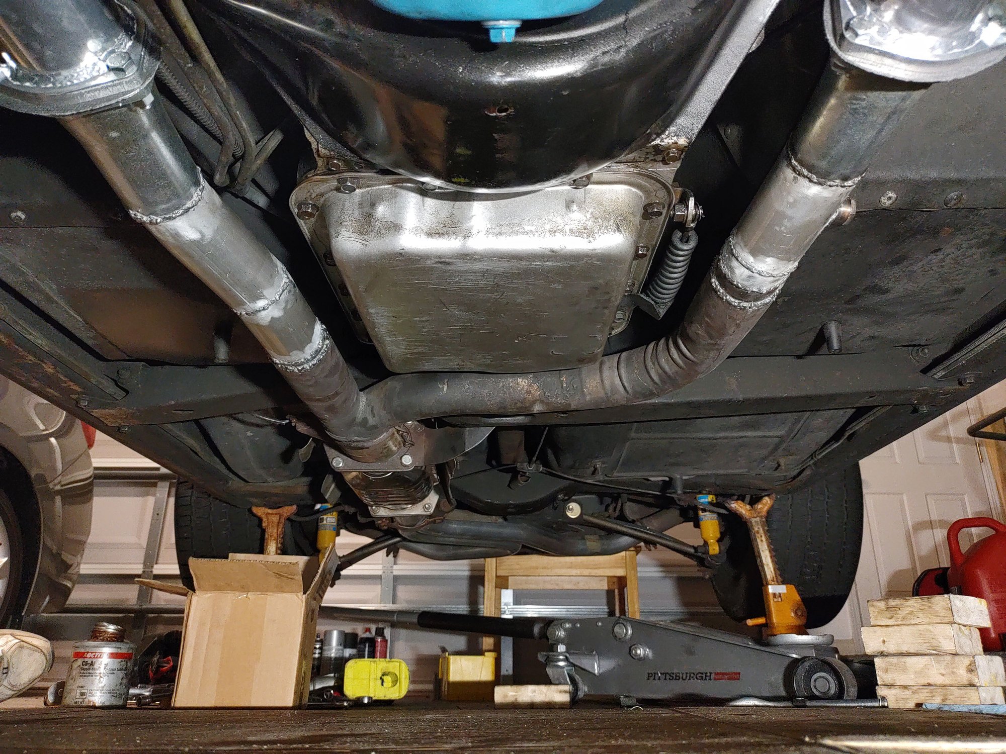

The plan is to build a 2.5 inch exhaust system using mandrel bent tubing from Summit. Melting metal together is good therapy. I'm keeping the stock crossmember running both pipes down the right side into a pair of MagnaFlow 53956 cats. I want to be able to go anywhere in the US without the popo sticking a mirror underneath the car and then having to hear "boy you're in a heap of trouble". The air pump is gone, the thermac is gone, my timing table ain't doing anything for nox, so I'm not going to push it. As far as the mufflers go I'm going to reuse the my original mufflers and see how it sounds.
