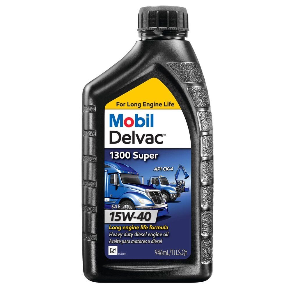

Originally Posted by augiedoggy
I dont know the specs of that oil but im skeptical on how it still would have more ZDDP when modern diesels have more emissions and o2 sensors to foul up than modern gas engines.. I suppose theres other substitutes in the additive package.
15W40 MOBIL DELVAC 1300 SUPER Diesel Oil conventional, API CJ-4, CI-4 Plus, CI-4, CH-4/SM, SL = 73,300 psi
zinc = 1297 ppm
phos = 1944 ppm
ZDDP = 1600 ppm
Oil ZDDP List

Are you saying use it as like add a quart of that to reg oil or use it as the oil?
The GM EOS comes in a pint bottle, add that and 4.5 qts of Delvac 1300. Break-in your cam than change the filter and top off to the full mark using the Delvac 1300. Run car and at next oil change run 5 qts of Delvac 1300.
You can run any brand diesel oil, I prefer Delvac 1300 and run it in my Duramax, Vette and John Deere.
