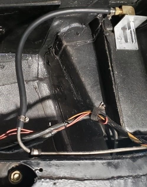

I have a tanks, inc EFI tank on my 69. I ran the vent to the upper inside of the passenger quarter. It’s been fine up until I put it away this week for winter storage. I filled the tank up completely for storage and had fuel leak out of the vent. I placed a container and caught the overflow which was only a few ounces.
my question is I’d rather not have this happen again, especially being right over the muffler. I run a vented gas cap on the tank and am wondering if this is enough that I can cap the vent? Has anyone capped off the vent? The vent is already in the highest spot in the car.

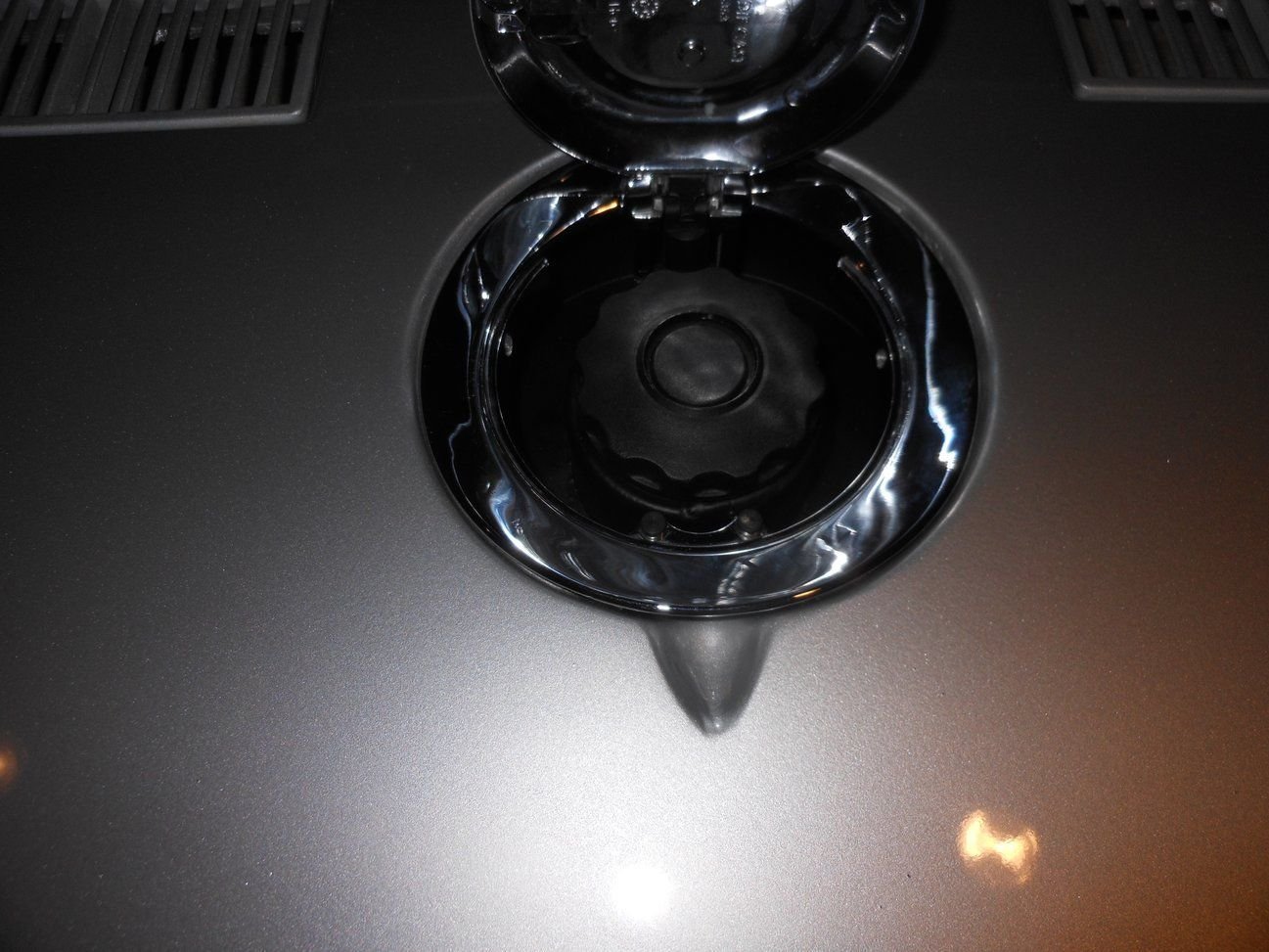

Gotcha. Went I modified and installed the 82 sending unit in my 68 I added a piece of tubing that sits about maybe an inch higher than the top of the gas cap. So far it has not leaked nor dripped. I was going through all kinds of ideas until I just decided to try it. It is actually off to the driver side next to the gas cap....so that even if it did drip it would not drip onto the muffler.

Here's what I did-
The vent on the Aeromotive Phantom Pump - manual said the vent should be 6" above the tank and use a roll over valve. In a Vette to do this the vent would have to be a couple of inches above the rear deck!!!
So I added a roll over valve- connected it to a charcoal canister and then a vent used in marine applications placed in the antenna hole. I also ended up going w/ Russel Synthetic rubber hoses to hopefully stop the permeation of the ethanol in the gas - and gas smells.
I am also running a sealed cap as well-

The tanks inc. vent is a roll over valve. It stops the fuel from puking out if the car ever goes painted side down. It's not a check valve like the factory unit. When you filled the tank to the brim, the gas expended, the vent hose didn't have the volume to hold the amount expanded fuel and the gas came out the vent.
I unscrewed the screen cover from the roll over valve and used a 1/4” NTP fitting to reuse the charcoal filter configuration. I used a relatively long vent hose to the roll over valve that might help if I ever fill to much.

Another thought is you could run the open vent hose up to the top of the tank where the gas cap is, attach it to the rubber "overflow catch bowl" seal. That already should be there and it drains over the top of the tank thru a hose that goes into the rear bumperette. And it is far away from the mufflers.
