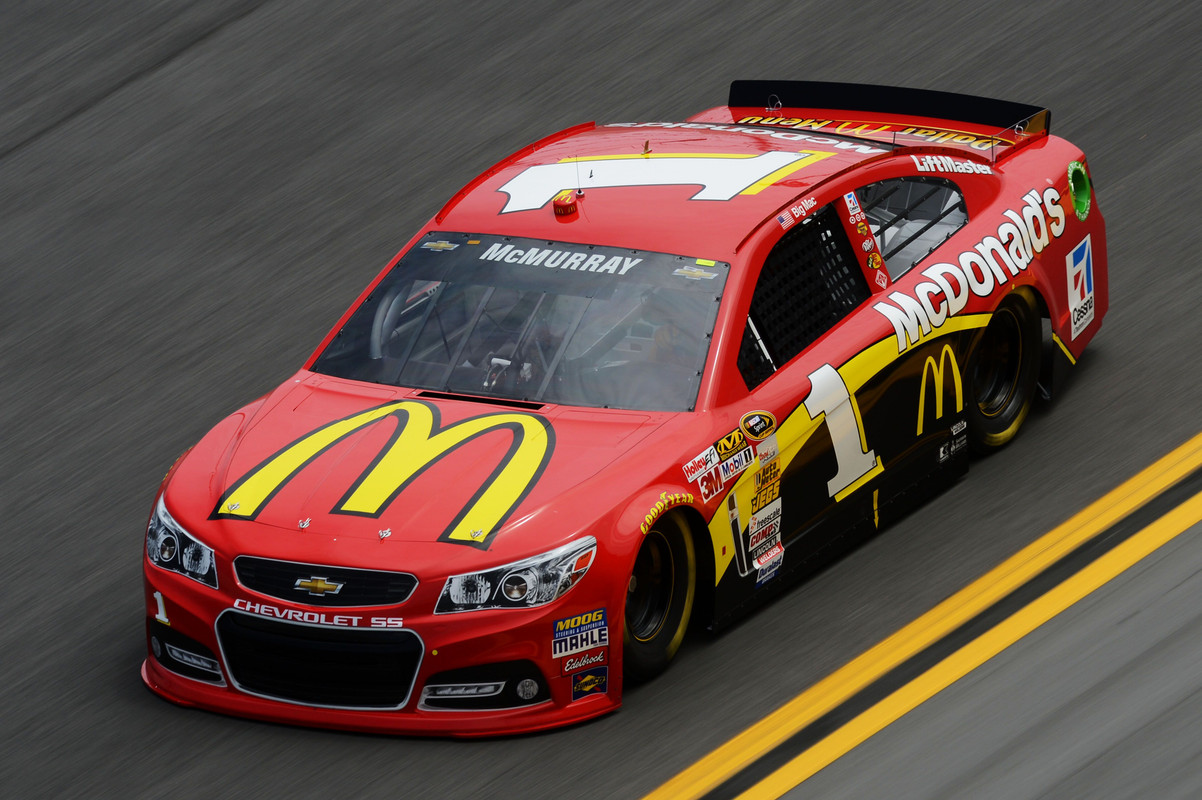

Originally Posted by 99 Black Bird TA
Jerry, what are the "fins" towards the out side edge of both T-tops for? Any special measures taken to keep the T-tops in placed?
Thank you.
I hope that it is okay to answer? Nascar drivers experienced horrible car lift at the super speedways once the car started to get sideways. Cars would lift off the track, fly through the air, and to many rolls. So the idea of Roof spoilers came into effect. I've driven at Bonneville many times over the years and worked as pit crews. The salt flats are like cement with sand on it. traction is a real problem. Like the car Speed Demon couldn't even go full power in 6th gear until 380 mph and they actually took out 600 hp and it went faster when they set the record at 420 mph or something for the fastest piston car ever.
I would have needed to add 1200 pounds in the passenger seat of my vette because I was spinning my tires going WOT at over 170. I had to back off and ease into it.
Anyway, lots of cars at Bonneville 360 loop the car before the first mile or two markers while trying to accelerate and the roof spoilers keep your car on the ground instead of rolling.
It's also the hard to see clear Lexan or some material behind the driver side door all the way to the rear deck spoiler. air keeps the car flat if it is sideways
