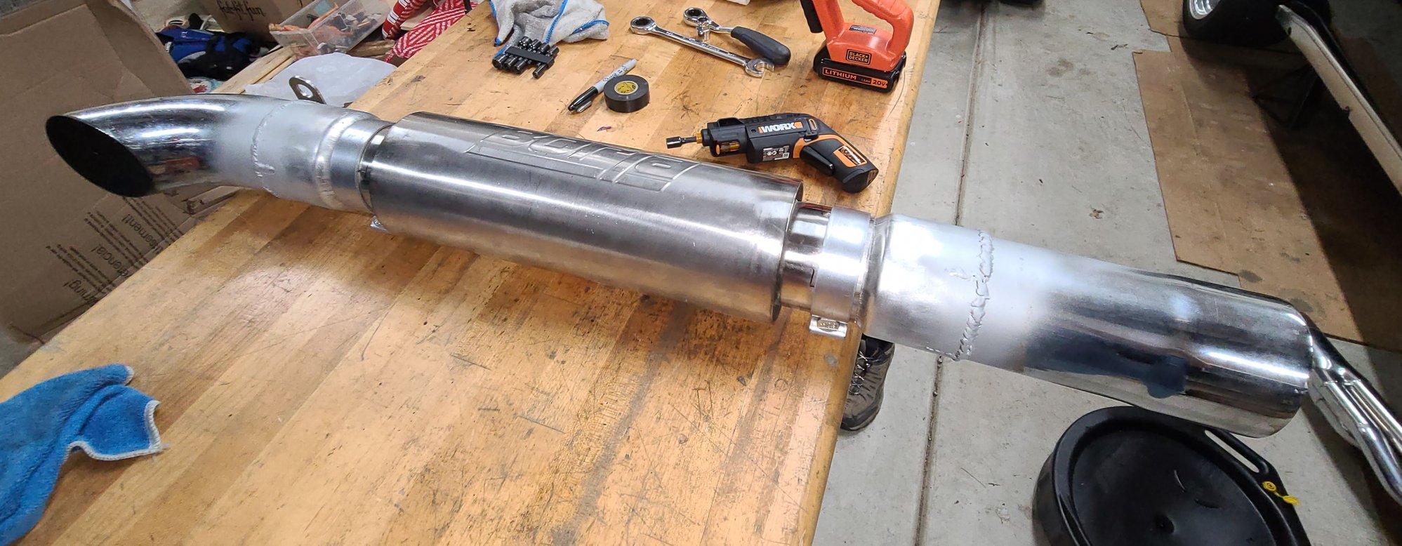

I also liked the look of the side pipes, but wanted a better muffler design / minimize lost performance. I've used the STS baffles in the past, as well as the 'glass-pack' type of insert. I finally decided to use Borla mufflers, but modified the tubes on a set of SS hookers that I had. Then I attached the heat shield to both cover everything up and protect my legs.
Here's the initial mock up with the opposite pipe for comparison:
I used a 4" to 3.5" reducer to get to the correct size of the Borla muffler. I then sized it back up on the outlet.
Here are the pieces put together before the heatshield:
Here's the final pipes with the heatshields attached:
Hopefully these will be a good compromise between looks / performance / sound...
