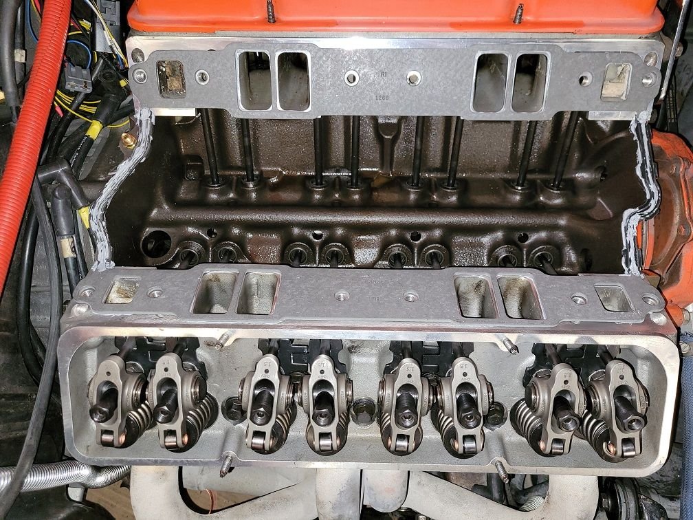

The black on the Block is The Right Stuff. Had it in globs on the rubber gaskets too. But it was easy to take off there, and off the China Walls, where it counts.

Ya know, that's what I had in there before, a thin blue Fel-Pro Print-0-Seal. I'm not sure why I had it in there, in conflict with the docs. Can't explain WHY I do a lot of ....., well, you know.

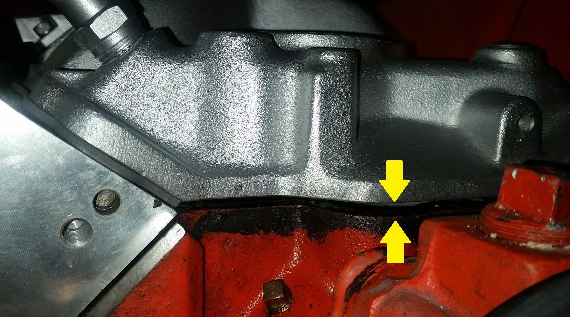

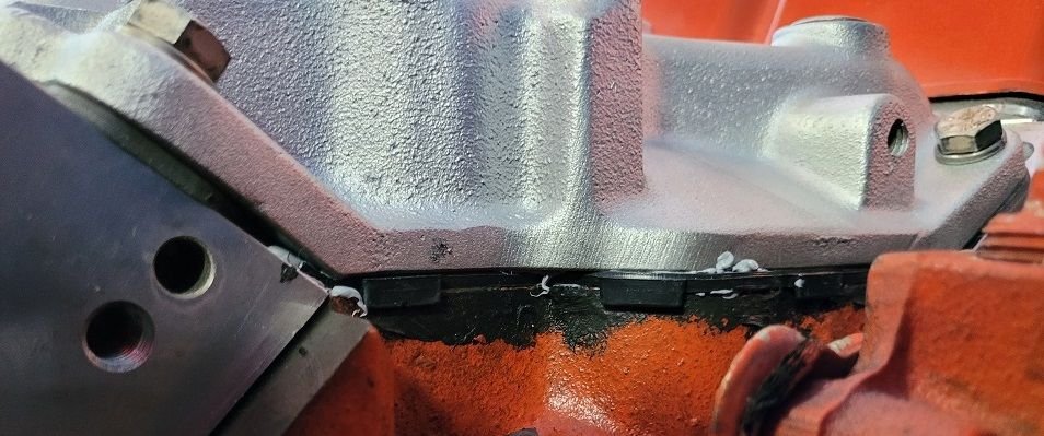

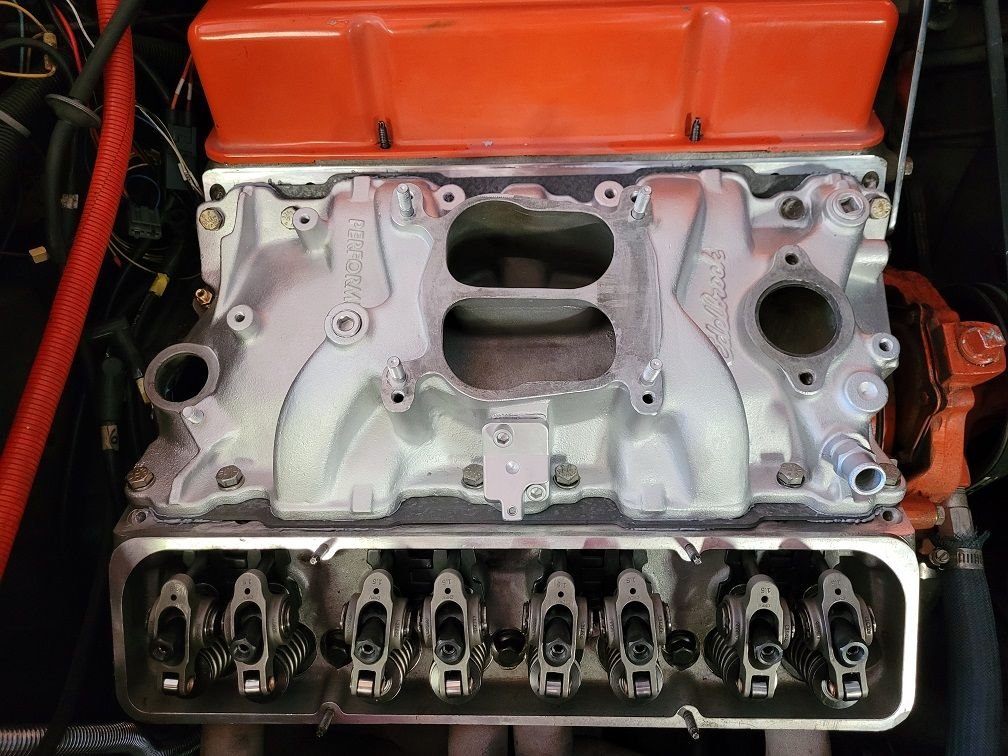

Installed the Intake Manifold this morning. The Right Stuff 90 Minute Gasket Maker used.
Coated the Manifold surfaces too, with emphasis on the Coolant jackets.
Employed the ribbed End Seals.
Torqued to 30 ft/lbs.
Was a big gap.
Sloppy job.
Pressin' on with the Dizzy and EFI unit mounting next.
Want this thing runnin by the weekend.
Steve

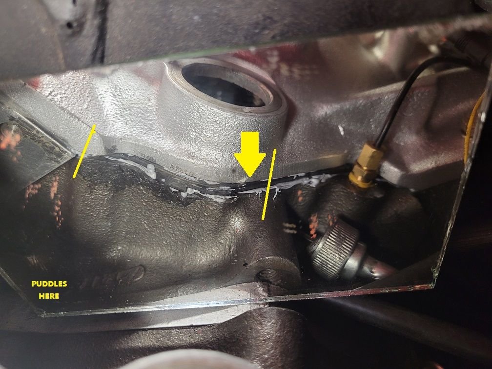

Default Told ya Steve ... TOLD YA!
How come you guys are always right?
That's ATF BTW. Ran the engine at idle for 10 minutes in an effort to flush the residual oil-water mix from the block.
Steve

Because there are a sh!tload of us and we have no reservations about second-guessing each other.
Would be a Fool to argue that Derek.
Mirrored image.
Believe the leak confined to the right side of the Block's hump, but will try to seal the joint's entire length. Brake cleaner and The Right Stuff packed in there for the 1st attempt to seal.
Steve.

When the shop bored the cylinders .030 overs, they also decked the Block some. I'm reminded of this because the engine's serial numbers are barely visible. And in using a thicker gasket this time, threading the bolts into the heads wasn't as easy as before.
Ashamed to show this, but it is what it is and I wanna drive this NOW, leak-free. Thank God it's hid back there.
Off the Jack Stands and ready to start, for REAL.
Steve
